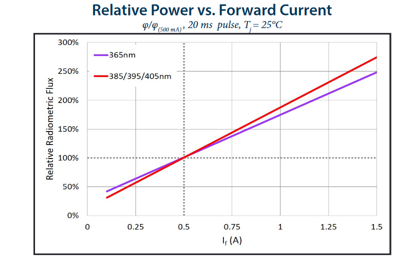

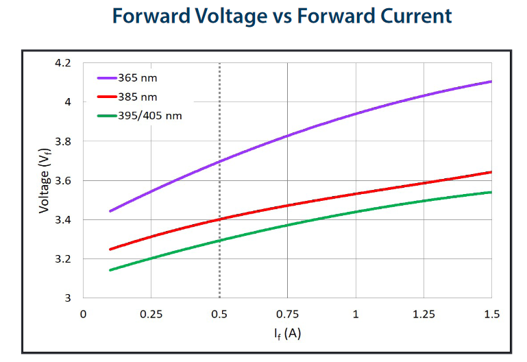

Luminus Devices, SST-10-UV-A130-E365-00 (from the datasheet, 365nm, Vf is 3.7v with a current of 500mA and an “Absolute” max current of 1A on the 365nm version).
Assuming I understand what I see in the graphs, with a freshly charged 18650 my battery is starting out on it’s tippy toes and current to radiation output is a steady downhill. I will start to lose max brightness very near initially turning it on. So I wondered if I built a triple with those emitters in parallel in an S21A host, then they could take 3 amps. Can I use a boost driver like this one, 17mm MTN-BST2 Boost Driver with the “8A IN | 3.5A OUT” option? Then if I use firmware to use only 80% mode, then my voltage should be starting around 4.8v with a fresh battery.
Could this work? Will the it be fine with just a linear driver?
