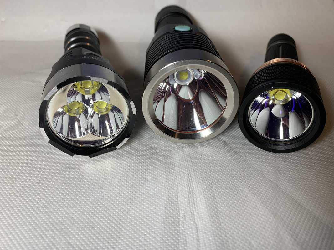

All 3 of mine have the dreaded Yellow Dot ( + hair) in the middle of the hot spot when white walling them.
The triple C8F being the worse of them……
I should of said they don’t suffer from it as bad, it is still there, it is just not as noticable in the lights I have had CW emitters in. Since I try to stay away from CW I don’t have a ton of experience with them.

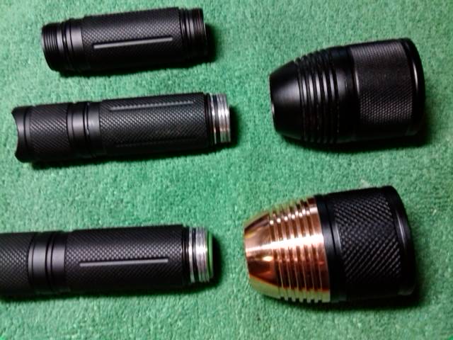

Where did you get the copper part for the X6? Is it from kiriba-ru?
I got 2 EE X6 hosts this week. So i am looking for mod options.

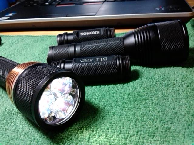

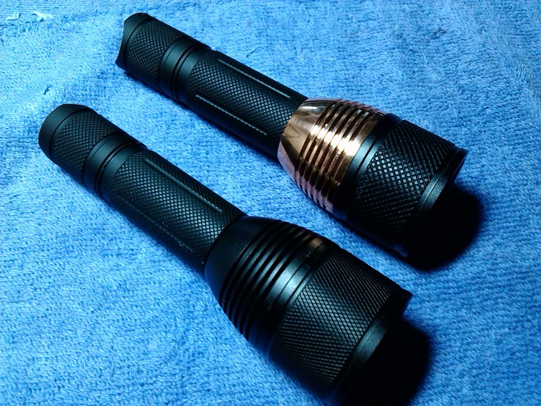

No Sir, their from the BLF Limited Edition KRONOS GB. I swapped out the X6 copper pills for the Black Aluminum ones. I couldn’t stand the stock battery tubes, so I re-thread some A6 tubes to fit and offed (sold) the KRONOS X6 lights.
I like them better with the full round tubes, the way the should of been… :smiley:
