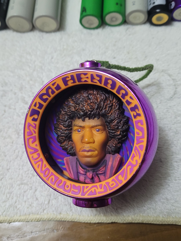

Its true. And it was my fault. I was not thinking! I have this Jimi Hendrix Christmas ball that plays Purple Haze and takes three of those 357 lithium coin batteries. I tried numerous times to get them in and I couldn’t. So I used a little screwdriver like an idiot :person_facepalming: and all the sudden it sounded like a 357 gunshot! I’m so grateful that I didn’t get blinded or serious damage to my eye. Several pieces hit me on the outside of my right bottom eyelid.
After this Fiasco I remembered six years ago when I had to change the batteries. You put one at one end, one at the other end, and then the third one in the middle. I kept trying to line them up in a row. Won’t work that way.
I probably shorted the Christmas ball device out. It has sentimental value. My cousin who has cerebral palsy and is 63 years old and is confined to a wheelchair, gave it to me about 15 years ago. I’ll find out when I buy three more of those batteries and use my fingers and put it in the proper way.One end then the other end and then middle battery.

Just to reiterate. It happened so fast and I can’t believe how loud it was. It certainly sounded like a gunshot. Photos below.

For Li-ion and Ni Cd batteries it’s really only safe to pry on the neg side —- for those coin type cells the pos is the solid metal side — most of the time what’s happening is the pry tool goes in the vent hole — BOOM
