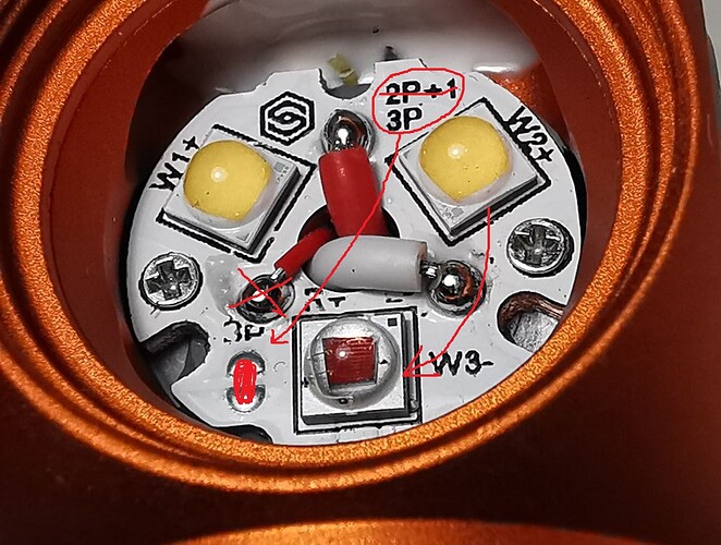

I am thinking of buying the H200 as well, because of triple. I don’t need the red channel and modifying mpcb to a single channel should be easy. Of course, I would fix in my own driver too. Comparing to single led we can gain about 25% + eficiency at 10W turbo mode. Same 10Watts but + 25% of brightness ;)) Can you measure driver diameter? Is it same 21mm?

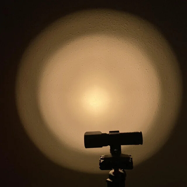

The B35AM is also available in the Convoy H2 headlamp (18650, unfortunately no compatible TIR. Optional 18350 short tube). See these photos from macomako’s Reddit:
H2 B35AM 3000K default reflector:

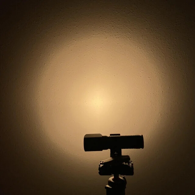

The same, but with DC-fix window foil:
