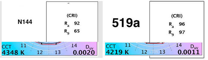

Both 519a and N144 are High CRI
and these two tests by zeroair show the Tint is very close… All LEDs have lottery…
519a shows Red colors a bit more vividly than N144… thats what the R9 number is, Red Color Rendering:.

“High CRI” is a vague and non-quantitative term, and not all “high CRI” emitters are created equal. In particular, the 519A’s light quality is superior to that of the 144AR.

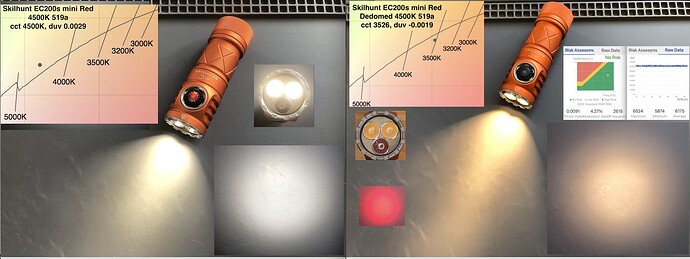

and my favorite LED is the DeDomed 4500K 519a… because DeDomed 519a gives me a tint below the BBL that I prefer over the more neutral Domed 519a.
here is my EC200s Mini w red, before and after DeDoming the 4500K 519a… I like the color of the beam on the right, other people like the one on the left… with 519a we get two tints to pick from

Makes complete sense! Even though I currently prefer domed 519As (as long as I can find the right secondary optic to give it good tint!), I did go through a lengthy dedomed 519A phase, and they are very pretty. 4500K dedomed also used to be my favorite of the bunch!

@jon, I definitely prefer the ec200 domed tint. I am not buying any of these from Amazon as they just act as middle man and have higher prices, so I would have to return both if I did what was suggested. My preference would be the C2 sand, but it only comes with the 5700k driver which I think it’s too harsh. Comparative pictures such as the one jon showed, with my current driver would be very useful.

For OP, IMHO/to my eyes, 519a 4500k not dedomed is yellow (too yellow), whereas B35AM is less yellow, more whitish creamy and one of the most beautiful Nichia beams to me. B35AM is very throwy in my Convoy M21B, if this is for closeup work, I would think the H4 w/ TIR is better. That TIR looks like it has diffusing beads. This is a heavy headlamp so I would think you need two-strap type head band (one around, one on top).
Above 90 CRI, sadly, cameras are ill-equipped to pick up (and screens ill-equipped to display) differences in color rendering–both processes lose too much color information. Remember that color-rendering is about the completeness and balance of the spectrum, while any spectrum displayable by a screen consists of just 3 spikes at RGB. The differences between, say, a 144AR and 519A, can be very obvious in-person, but pictures through a camera might have issues picking it up.
