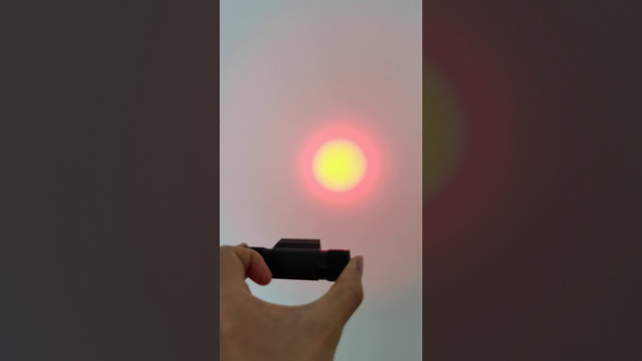

Since many fans love D25S headlamp, and ask for SST20DR 660nm RED lights, here we are.
I asked the factory to make a prototype of this New D25 headlamp with SST20 White+SST20DR 660nm
If you are interested in it, please reply.
Simple UI:
While off, click to turn on for White led, press and hold to choose brightness Moonlight-Low-Medium-High. Click to turn off.
While off, press and hold to turn on Red led, press and hold to choose brightness: Moonlight-Low-Medium-High, click to turn off.

The driver is redeigned which means SST20 white and SST20DR are controlled separately. I blieve the forward voltage is not an issue, but will bring details if I got more information.
The D25S headlamp gives 1.5A to each SST40 led, 3A in total. I am not sure about this prototype for now, will bring more details later.
And it’s not possible to use SST40 White + SST20DR, emitter must be in the same size. That’s what I was told.
You are right on “lumens are the selling point” but it seems white led can not be as bright as 1000 lumens. It will be 300-500 Lumens I guess. The current can not be too high, because the shell, springs can not take it.
That’s why I am not sure if people will be interested in a headlamp with not that bright white led + 660nm red led.

the max current is 2.2A for now, but it can be raised to 3A so the SST20 6500K/4000K can be brighter. The lowest current 10mA, I am not sure if it can be lower. My eyes still hurt when looking directly at the led at Lowest brightess.
