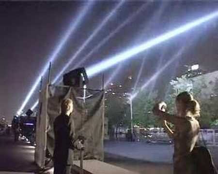

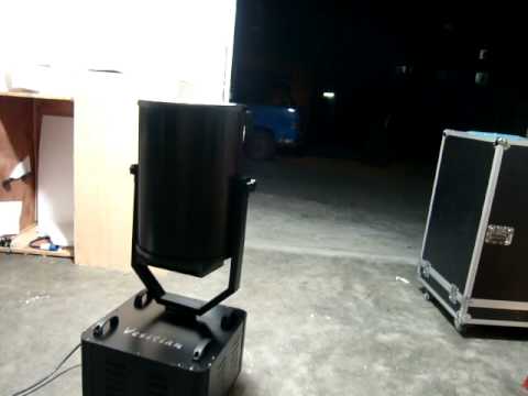

How about advertising searchlights. You live in a Ruko right? (Can put on the roof! LOL!) Not vvveerrrryyyy expensive.
To give you an idea of the prices, on alibaba there are stores which allow you to purchase 1 unit sample, same price
http://www.aliexpress.com/store/508051/210168825/Outdoor-Light-Series.html
3000W
Low cloud spotting is pretty easy.
