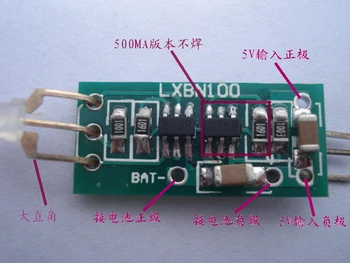

The Cheapest I Can find on Aliexperss is 4.31 including shipping ![]()
It is for a project including a removable 18650 so I do need the reverse polarity protection

Are you sure the 4057 has battery side reverse polarity protection? I can’t read Chinese but it seems quite rare and expensive when filtering for chips with battery side reverse polarity protection on Digikey that I resorted to looking for an alternative method such as a resettable ptc fuse. Power supply side reverse polarity protection is common, battery side is not.
Yeah, it’s kind of assumed the cell is going to be soldered-in, correctly, like for a powerbank or other doodad, and not be removable.
Google translate says “Adopt SOT23 package 500㎡A anti-reverse connection charger for lithium battery” so I think it has reverse polarity protection
Yes but the tp4056 also has anti reverse/reverse polarity protection but that’s at the power source only, not battery side rpp.
