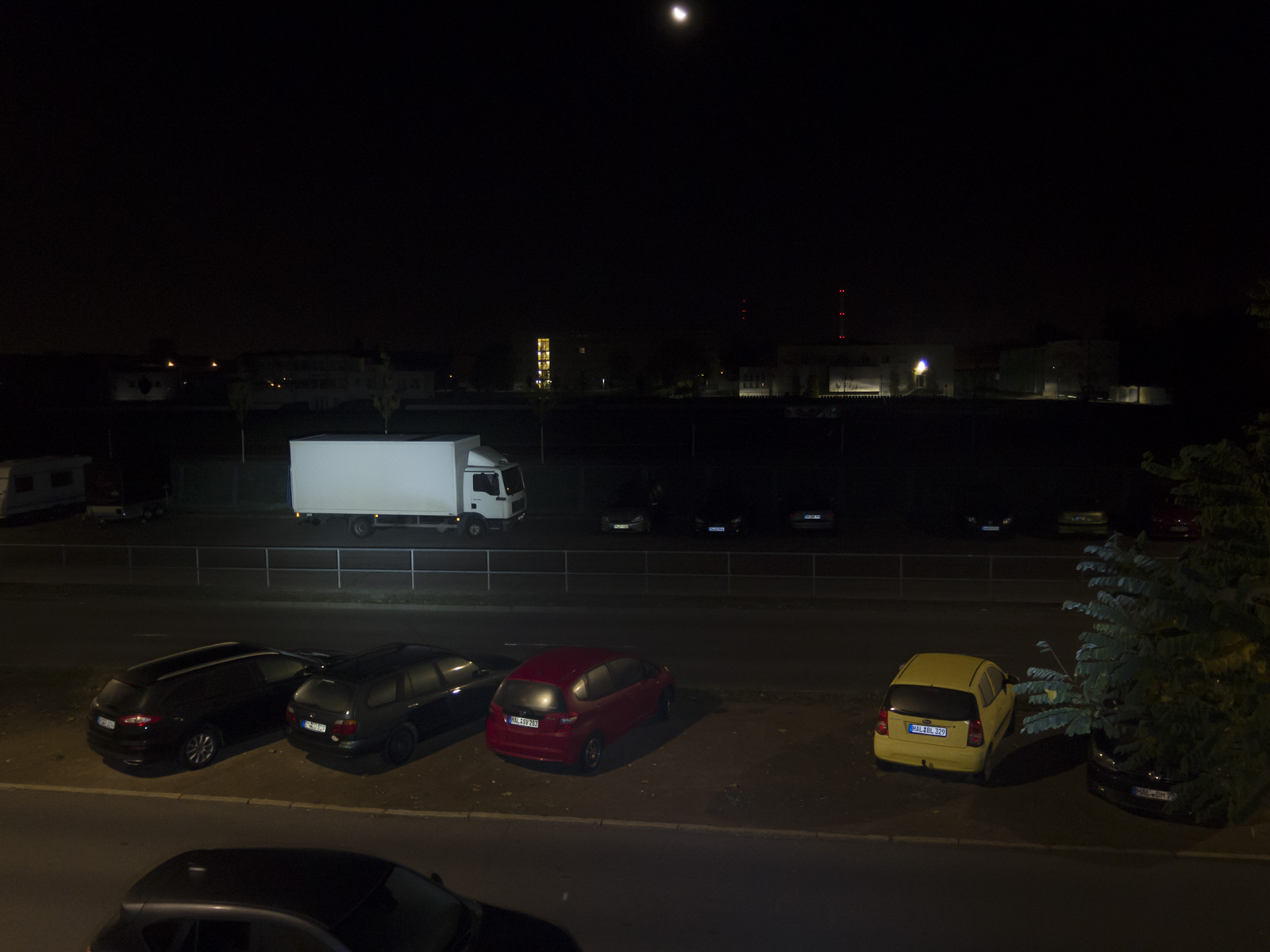

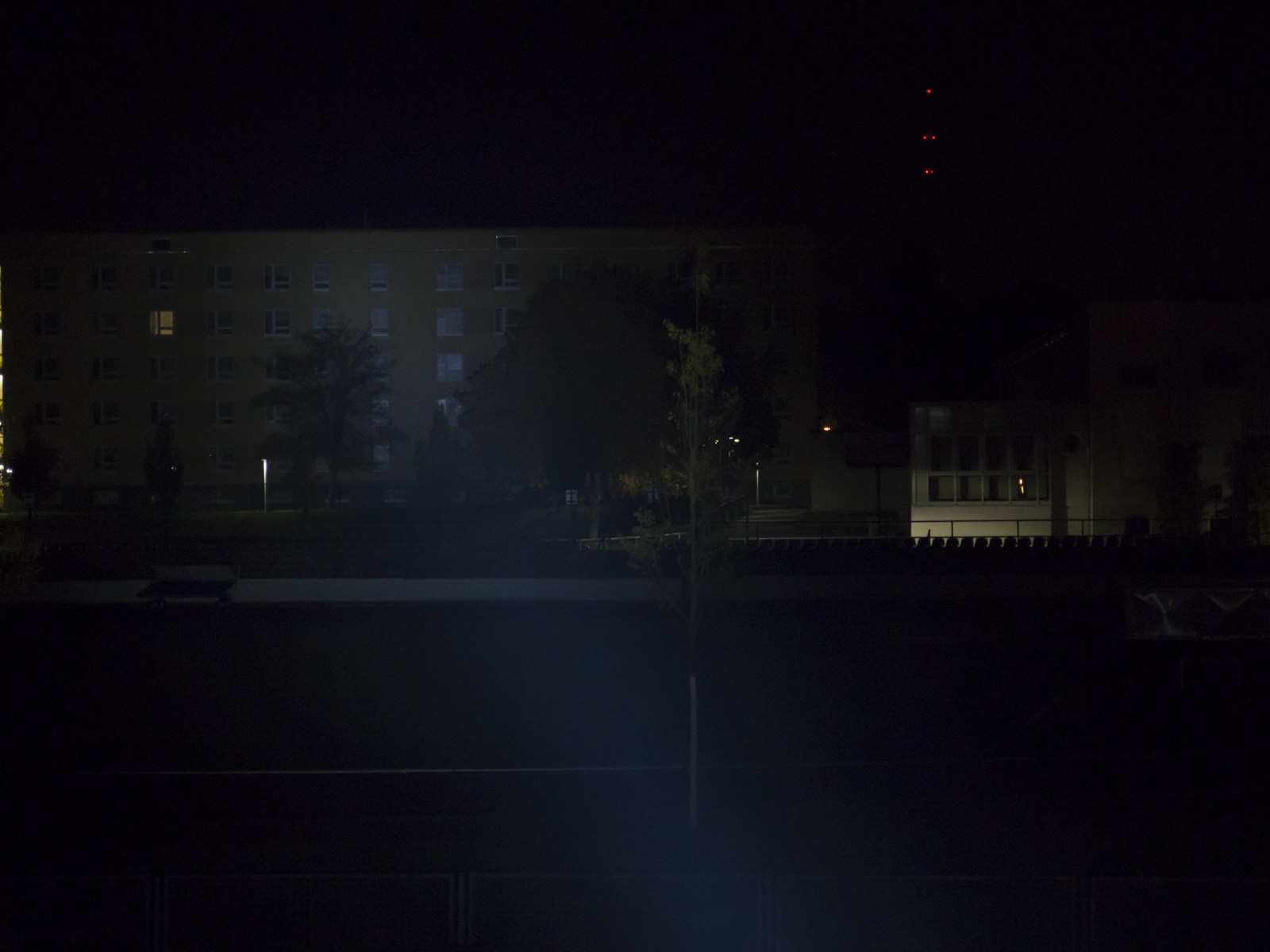

The tree line is about 136 meters away.
Convoy C8 w/Dedomed XP-E2 Torch

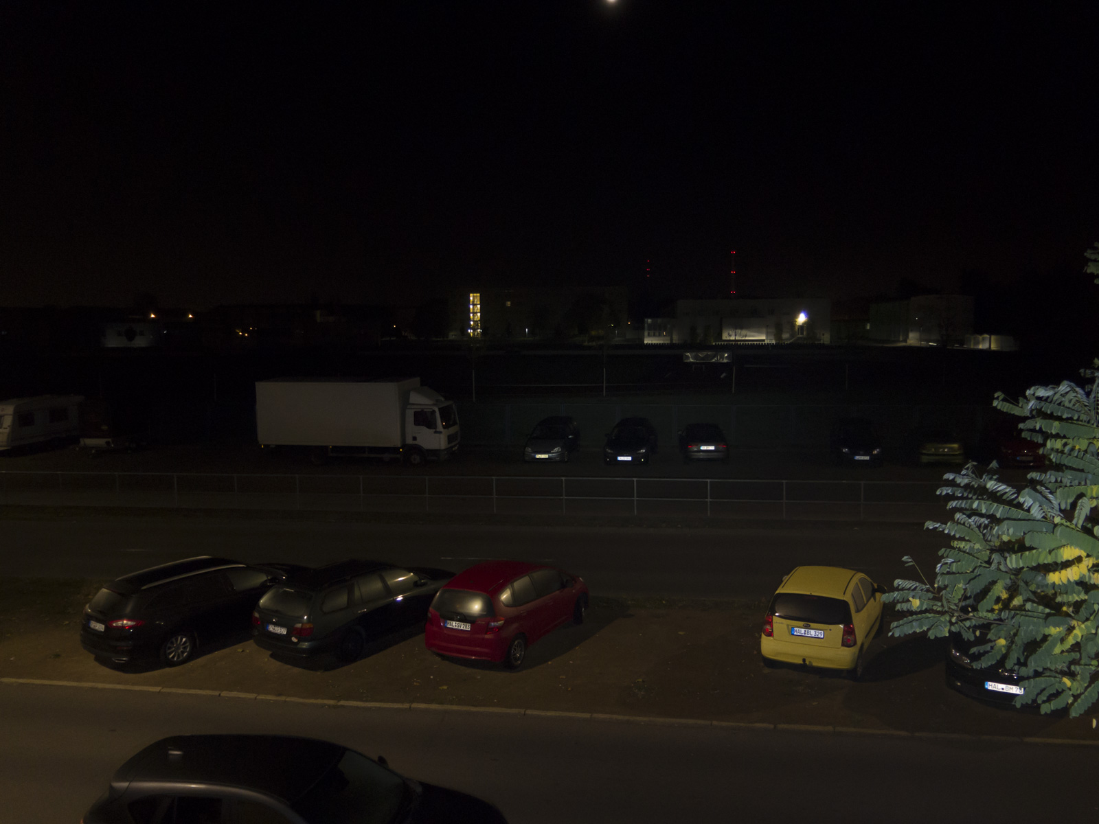

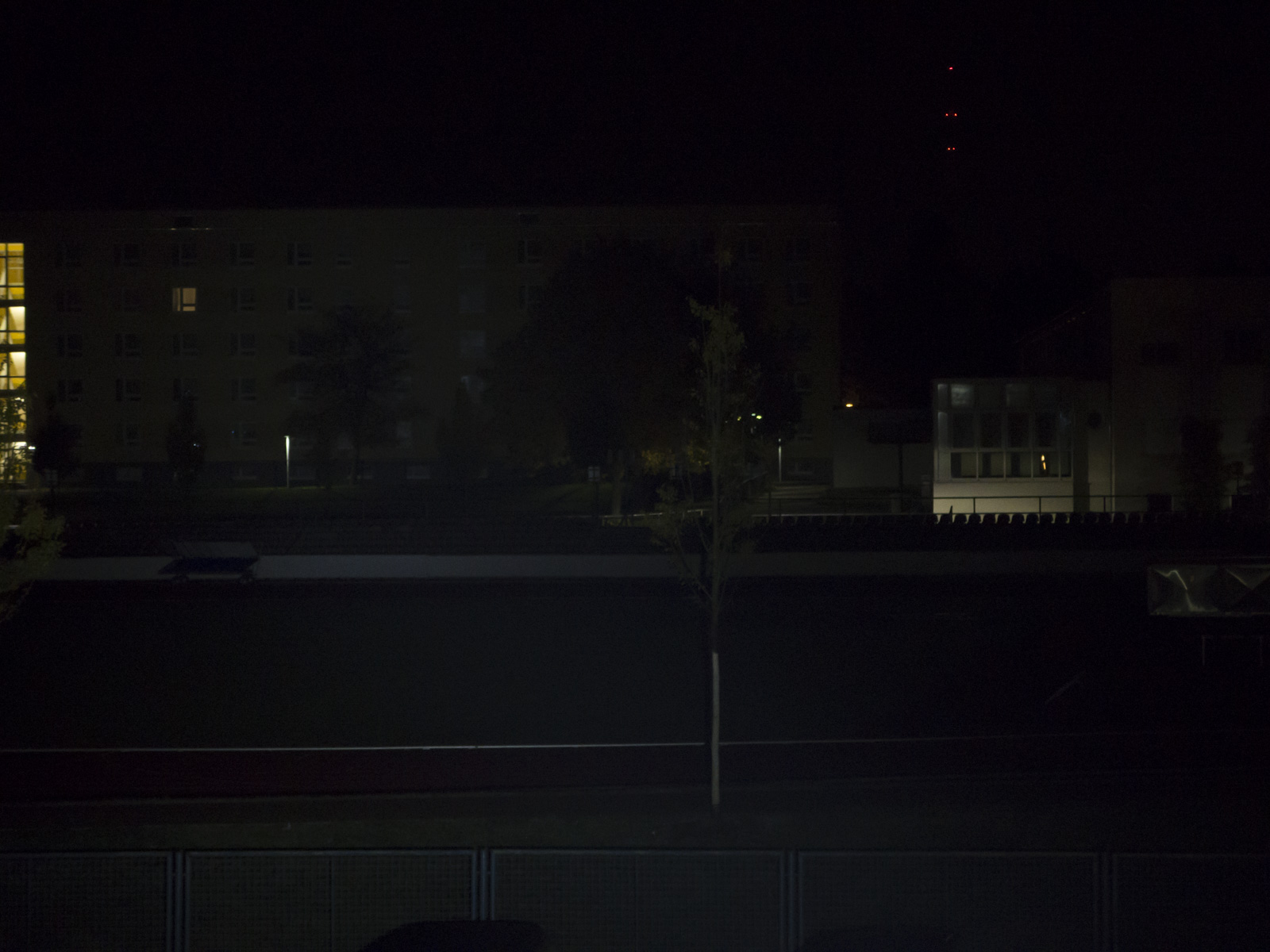

Convoy C8 w/Osram Oslon Black Flat

Thanks for posting! I’ve been trying to decide between these two leds or a dedomed 219c for my C8.
How did you electrically insulate the Black Flat from the flashlight body? Also, have you measured the candela of these two?
I used a thin layer of Arctic Alumina thermal adhesive between the mcpcb and the shelf. I haven’t had a chance to measure them yet. I was a little impressed with the intensity of the Black Flat even though it’s cool BLUE, lol.
Kewl…
What kinda current you pushing through them?
Nice pics. What current are you running the Torch XPE2 at and what do you think of it in the Convoy?
I’ve got a standard qlite @3.04a with guppydrv pushing the XP-E2 and a fet+1 pushing the black flat.
I have a qlite @3.04a pushing the XP-E2. I don’t really like it in the C8, I really don’t think you should use anything smaller that a XP-G2 in it because the beam is not very useful at all.

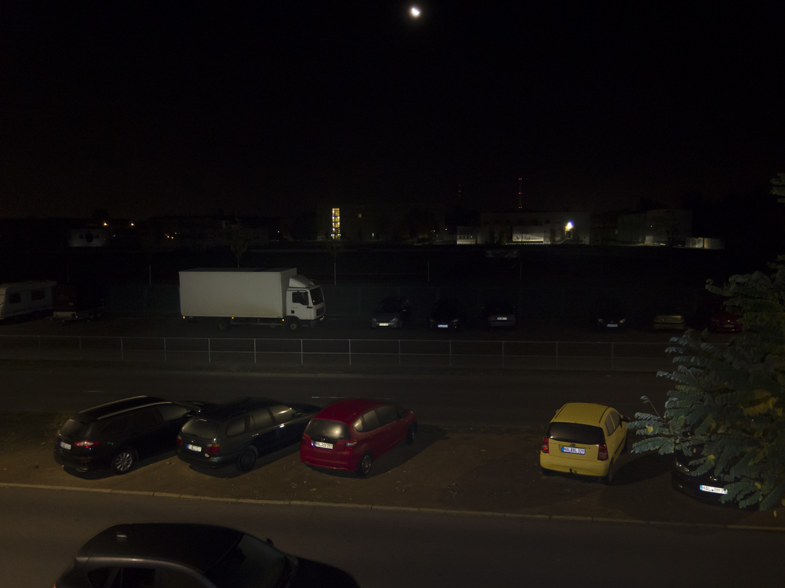

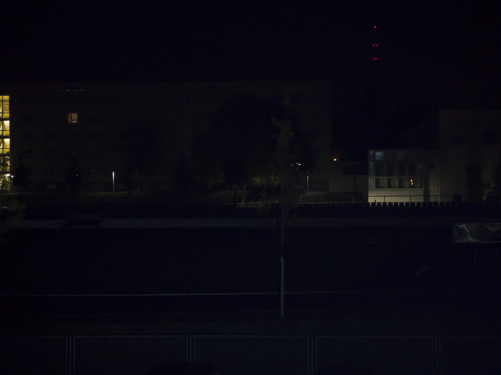

I made today a couple of Beamshots and measurements
Camera settings
manual white balance saved for the Astrolux MF01 at 5000K
wide angle
f1.8 1/20 ISO800 6.1mm –0.5 brightness
zoom
f2.8 1/20 ISO800 30.5mm +0.5 brightness
