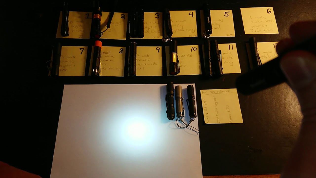

A quick video comparison of 12 cheap (~$2) single AAA flashlights
Greetings all.
I've been a long-time lurker of this site, often referring to it whenever the urge to get a new flashlight came up. This past year I became curious about some very cheap flashlights being sold on eBay and AliExpress. I was able to find a couple reviews of individual lights on YouTube which suggested that, for the price, they were actually quite decent, and might make nice gifts for friends, or even total strangers I meet while traveling. I bought one, then another, and soon decided to just buy every different cheap single AAA I could, attempting (and mostly succeeding) to find each for $2 US or less, and then do a comparison of all of them, so that others would know the gems from the junk without having to waste their money.
For my first post on BudgetLightForum, I present to you the video I've made comparing all 12 lights. I hope this helps any who are curious.

The first 2 (#7 and #8 in your line up) are running dedomed Cree XP-C here, giving them a really narrow but pretty bright beam.
Number 7 in your line up is pretty good actually, and because of the bigger lens has the narrowest beam and the driver is more powerful.
I’ve got #2 also. It’s cute, and some day i’ll rebuild it with a better driver and LED.
I’ve got number 7 and I really dislike it. Performance is good but has some electrical issues and changes modes when I zoom.

That turned out to be easily fixable by tightening the pill.
Did you open the bezel and tighten the pill into the battery tube?
Otherwise it may be the driver board sitting too loose in the pill, or both…

Indeed, the pill was loose. Tightening it fixed the problem. Thank you!
