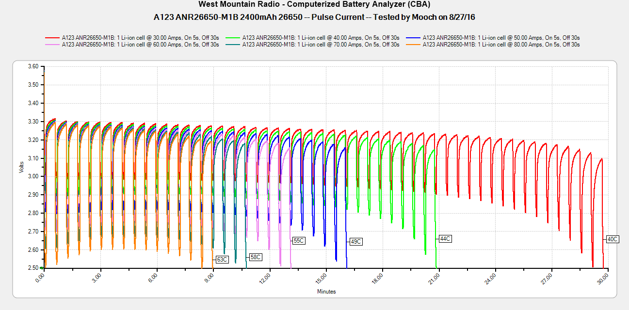

Here we see the battery discharge to a measurement of the NKON.
A123 cells’ qualities (low IR, flat discharge curve) make it good for some applications, but the low voltage and low energy density limit its applications.
