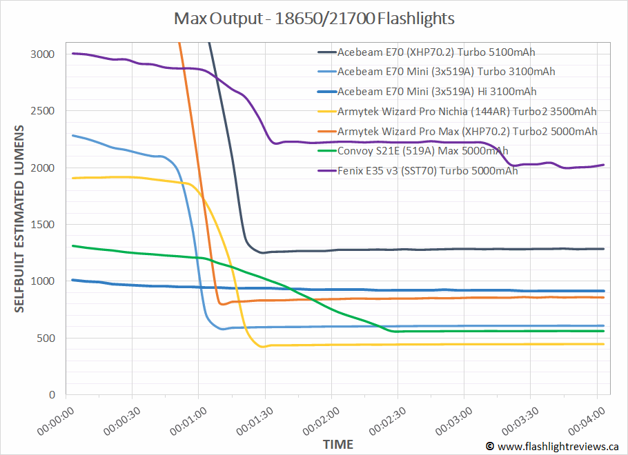

Following up my review of its big brother E70 model, this 1x18650 version of this Acebeam light features 3x Nicha 519A Hi CRI emitters (under a distinctive TIR optic). It has quite an interesting beam pattern (even spotbeam with milder spill), and excellent circuit performance. Still has the same quirky interface and high standby drain, like its larger sibling.
Here is a runtime graph from the review, showing the initial step-down from Turbo:
