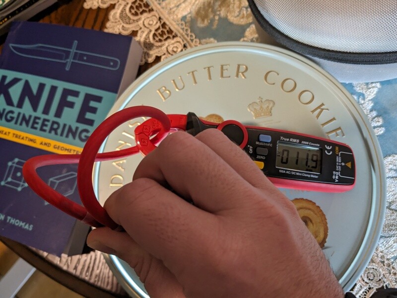

I used a UNI-T UT210E clamp meter to measure the current at turn on. An 8awg cable was used to bypass the tailcap.
Mode Amps at start Specs Lumens @turn on Lumens @30 sec Lumens @10 min
Low 0.06 A 30 38 37 37
Med1 0.28 A 150 179 176 174
Med2 0.86 A 450 512 506 496
High 2.46 A 1,000 + 150 1,268 1,240 1,184
Turbo 11.47 A 3,000 + 1,000 + 150 2,749 3,354 1,157

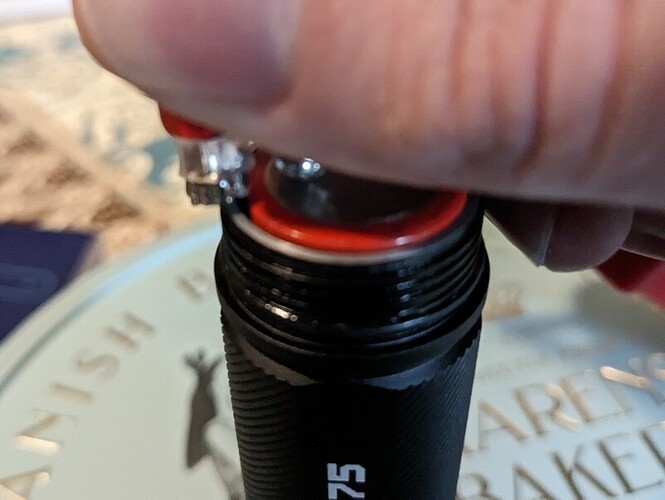

Could you post a picture of your test setup? I’m still quite new to this and I’m not sure how to use a cable to bypass the tailcap.
I bought a metre of 8awg cable from an automotive store, cut a short length off, stripped the ends, added some solder, and added some heatshrink. It’s probably not making the best connection. There may be more resistance.
I turn the clamp meter on, thread the cable through, select 2A or 20A, press the blue button to switch to DC, hold each end of the wire against the tube and battery, press the zero button, turn the torch on, write the measurement down.
Some care is required to avoid shorting the tube and zapping your fingers. Sparks can go flying.
I used a biscuit tin in the photo to avoid burning a hole in something.
