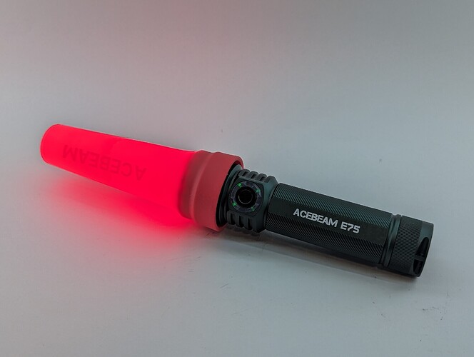

The Acebeam E75 arrived in a nicely compact, stylized black box with all of the goodies neatly packed inside. Alongside the box, Acebeam also threw in red and white of traffic wands which are an option to have included when you go to check out on their website. In the box was: the flashlight (duh), Acebeam 21700 battery, charging cable, lanyard, spare o-rings and USB cover, and the instruction manual.

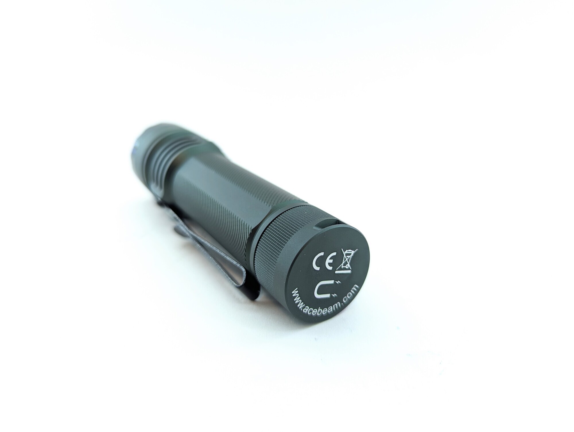

There’s a very strong magnet in the tail of the Acebeam E75, which can be useful in a variety of situations, like working around machinery, in the garage, etc. It appears that you can remove the magnet, if desired, but popping out the tail spring.
The pocket clip is big and sturdy, but definitely not deep-carry. And I’m ok with that. I find the E75 to be a bit too bulky for EDC carry, as with most 21700-based lights. But the pocket clip is still handy. For instance, I clipped the Acebeam E75 onto my pocket while walking through a field to get to a hunting spot. I didn’t need the flashlight to disappear into my pocket. Rather, I needed it to be easily accessible.

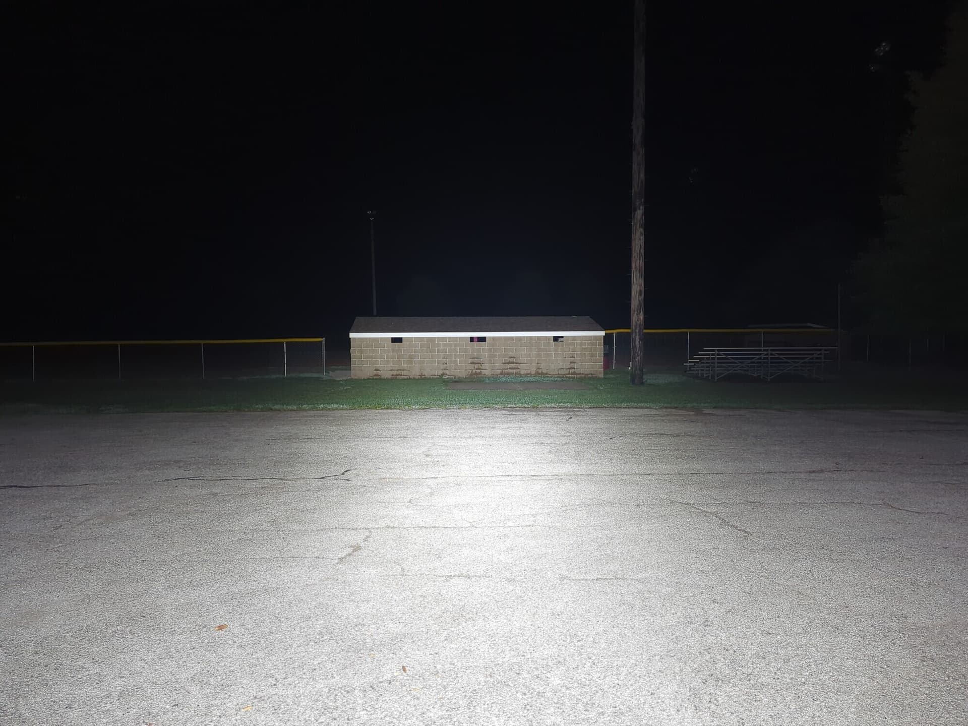

As mentioned earlier, there are 4 LEDs here in a fairly shallow reflector. So the beam is reasonably floody. But I will say that the hotspot is more defined and a bit tighter than I was expecting. It’s no thrower, but it’s not pure flood either.
Beamshot: the building is 30m away, taken with a Pixel 7 set to 1/12 sec exposure and ISO 852.

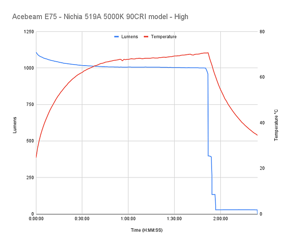

So does my Nichia model hit those specs? Yup! I measured 3070 lumens at turn on and 2942 lumens at 30 seconds, so that’s good in my book. The runtime length was accurate as well. And I love to see the nice, regulated, stable output. To me, that’s one of the biggest things that separates the budget lights from higher quality flashlights like you’d get from Acebeam. Anybody and PWM a MOSFET. But designing a proper constant-current drive is more expensive, requires more engineering work, and reduces waste heat / increases runtime.

Curious, where was that ~70c temperature (turbo and high) measured? Seems like that would make the light uncomfortable to use without gloves ??
My sample is the Green one. I’m not great with colors either (colorblind)
Yeah, that’s a bit hot for my tastes. Thankfully, it took a while to get there. The room was around 24C ambient, no air movement. The IR sensor was pointed at the head, around the heatsink fins.
