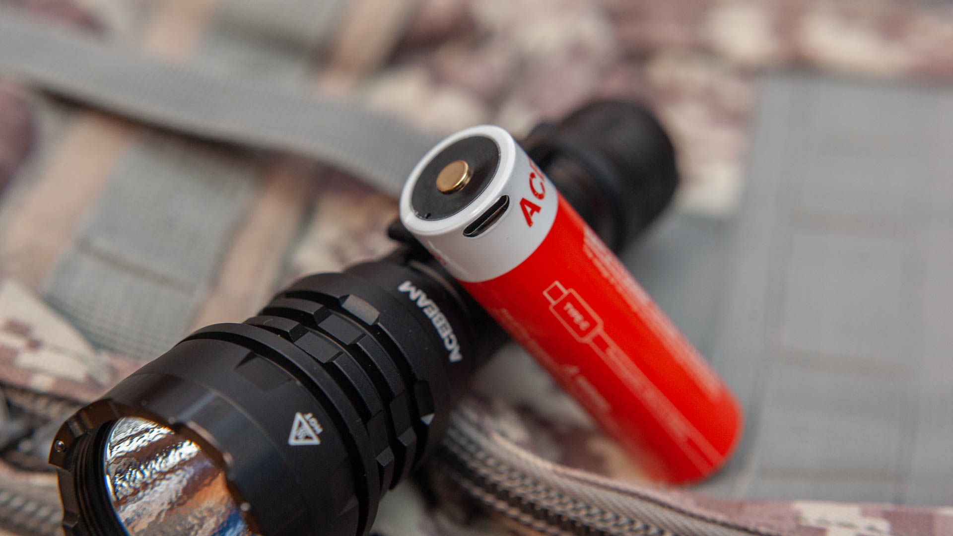

The battery is the same as usual, with built-in charging port. I would prefer built-in charge directly in flashlight body, not in battery. BTW, Acebeam P18, finally, has one. But this is purely a matter of taste.

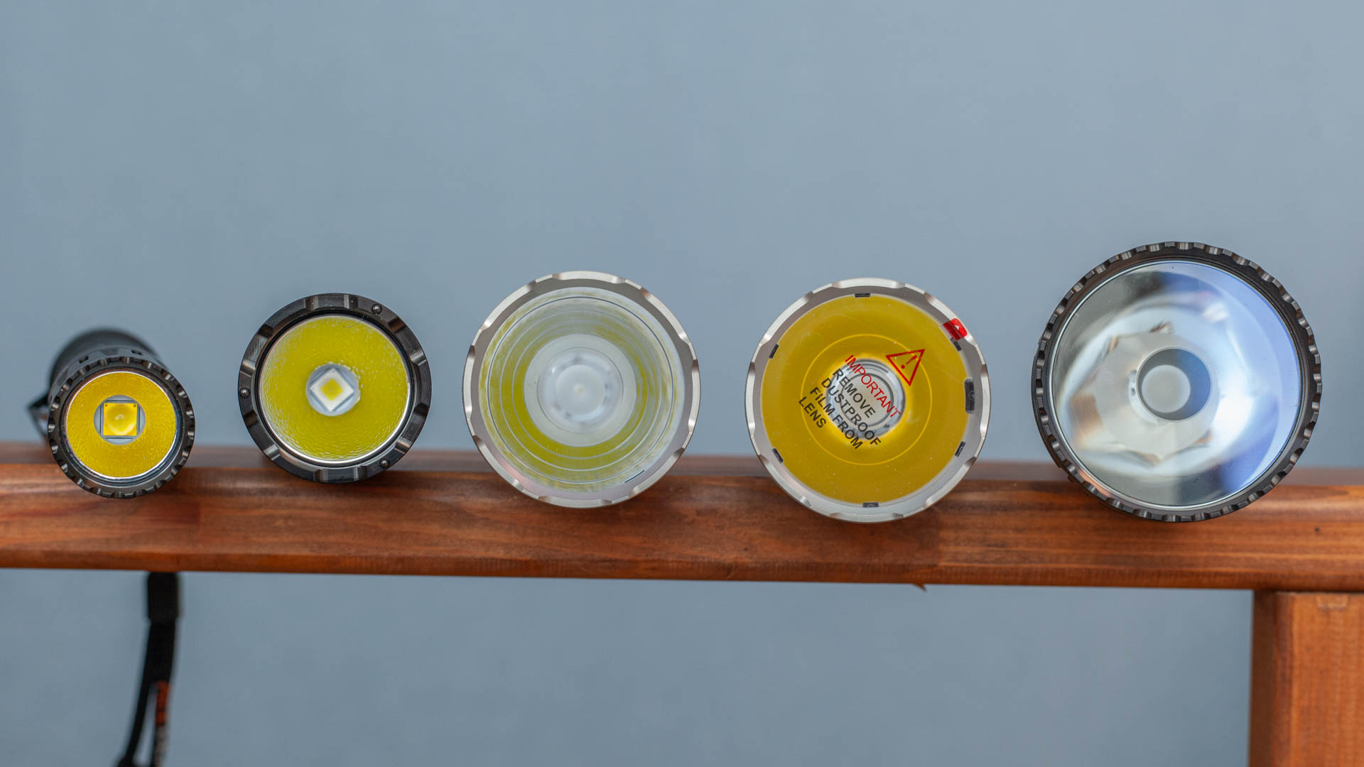

And here is the Acebeam P18 itself. This is a fairly large tactical flashlight or a completely medium-sized long-range flashlight. For comparison, the leftmost Acebeam E70 and the three right Acebeam L18, L35, L19.2
The optics, of course, are also completely different here.

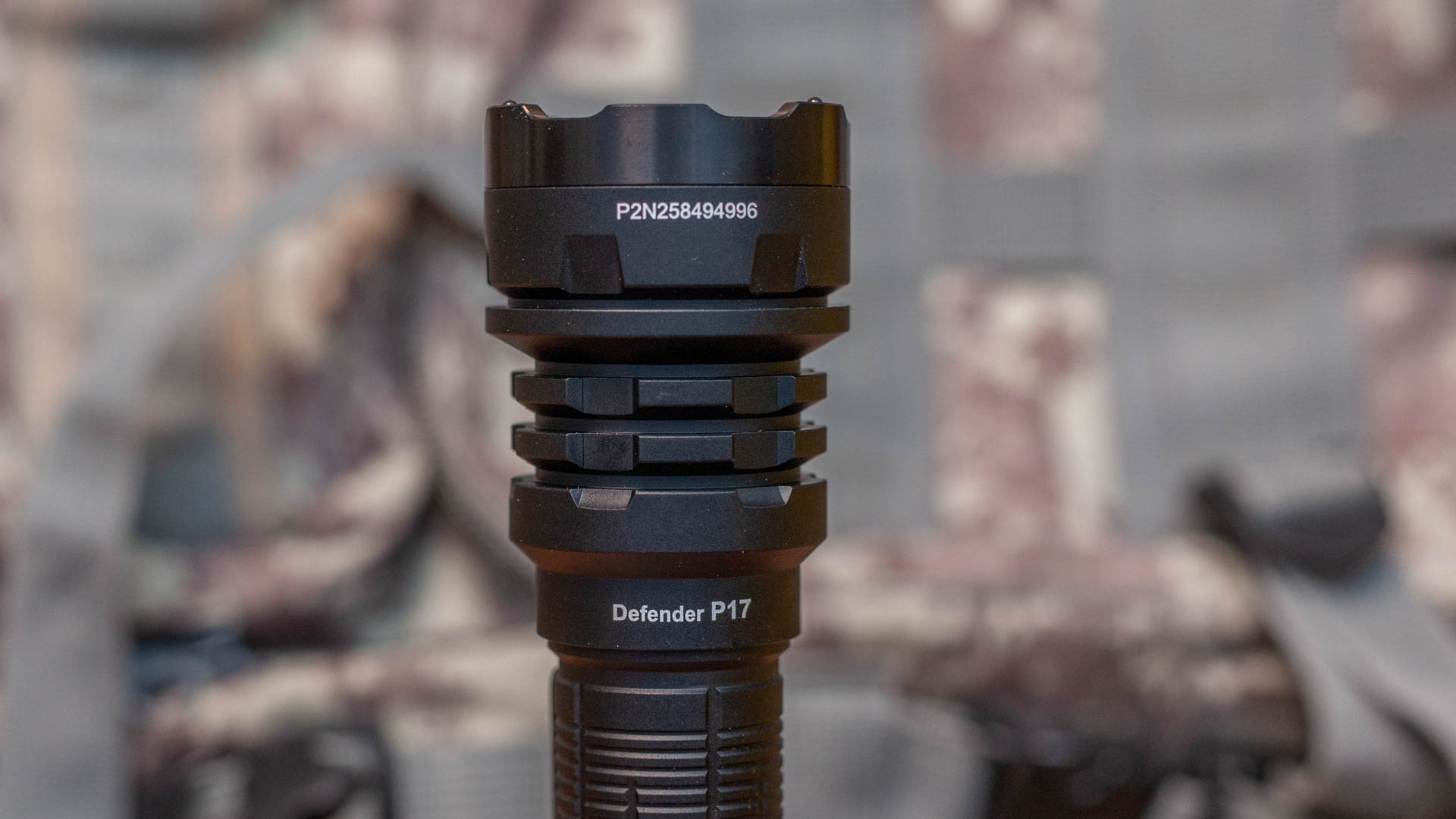

And here is the Acebeam P17 itself. Tactical flashlights - with rare exceptions, is a category that doesn`t astonish with awesome design, that is not EDC.
So here too. Acebeam P17 looks just functional and clearly a branded flashlight. But it is likely to be lost in a row with other ribbed-toothed tactical stuff. I’m glad Acebeam chose matte anodizing. I find that in the vast majority of cases it looks much better than glossy.
Don’t get me wrong - the flashlight looks really cool. But simply, for the most part, draw many tactical flashlights somehow like this. You can somehow play with EDC and make it look unusual (the same E70 in the photo above, for example). Tactical flashlights here are mostly monotonous.

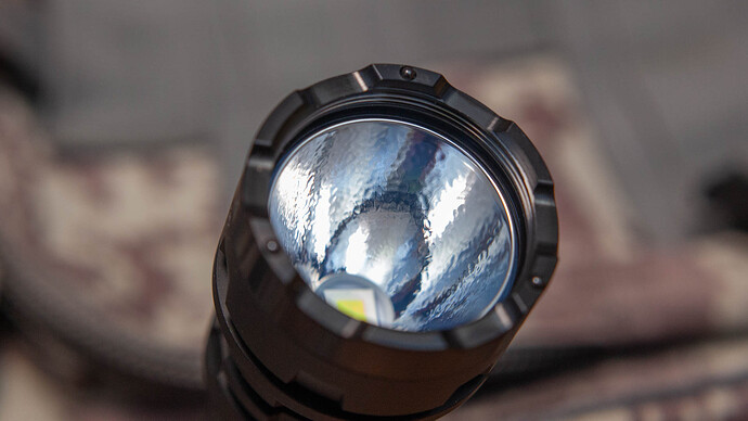

The head is medium size, well ribbed. I don’t think it will be of any use in a turbo at such an increase, but for lower modes, youll need bigger head and deeper fins for the cooling to have an effect. But, well, lets check it below.
The bezel is blackened in the spirit of L19.2. In general, not bad. The bezel teeth are wide and not particularly agressive ones. Glass balls are inserted into their tops. The reflector, as you can see, is textured and comparatively deep.

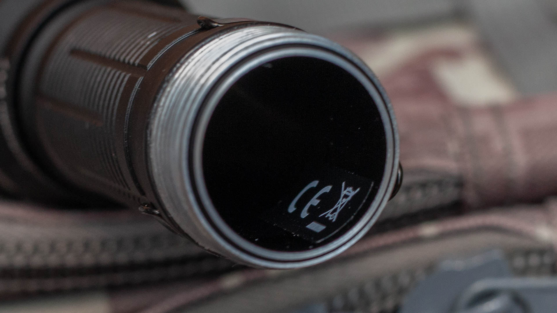

Wow, I don’t remember the last time I saw a thread for filters inside the bezel.
At its bottom is a Cree XHP70.3 LED. This is a dedomed LED - which means that this flashlight will have everything in order with the range. The approximate difference between the regular Cree XHP70.2 and the dedomed XHP70.3 can be seen in the review of the Acebeam X75 light cannon

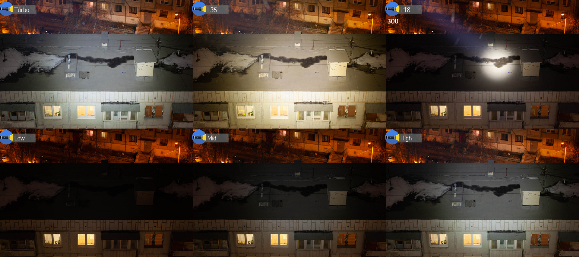

The light, alas, is cold white, but there are simply no other options for the XHP70.3. But it has the advantage of a longer range compared to the XHP70.2. Here, see for yourself, the reflector of Acebeam P17 is much smaller than that of Acebeam L35, and the light, at the same time, is quite close to the latter. However, why hide it - I like the L35 light much more both in terms of color temperature and light distribution. The difference in the latter is clearly visible on the first GIF
P17_720_wall
P17_720_wall_vs
Once again, I rate the light of the Acebeam L35 exceptionally high and consider this flashlight to be one of the best medium sized flashlight I have ever seen. As well as Acebeam L18 one of the best long-range flashlights. Actually, if funds allow, then I usually recommend this pair as a universal set that will cover all the needs of the world within 1 km. I have both of them and the L18 in camouflage was the only flashlight I have bought in many years.

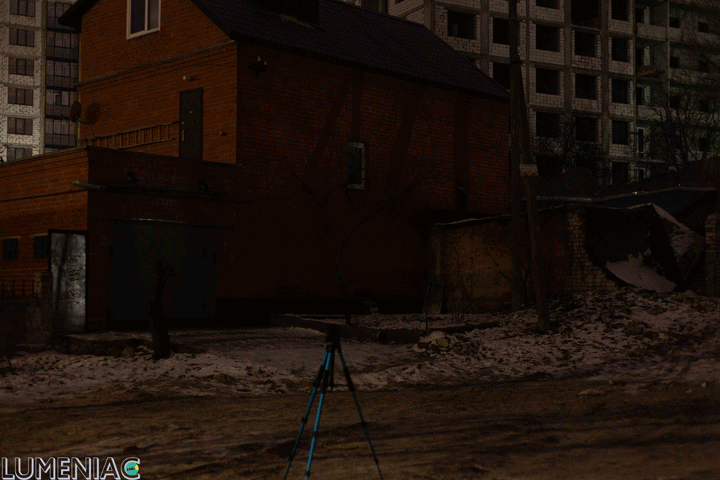

Acebeam claims 450m range here. But it is naive to expect light for half a kilometer with such and such a reflector and LED. Dedomization and high brightness will not help here.
P17_720_150
P17_720_150_vs

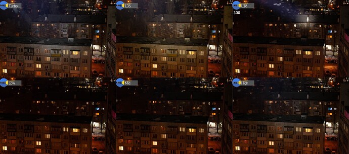

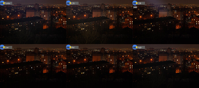

200m here is already very close to the limit of usefulness of this flashlight. Another thing is that in this radius it will highlight everything.
P17_720_200
P17_720_200vs
Well, at 300m you can see that even a turbo is of little use. Yes, it would be surprising to see something different with such optics and LED.
