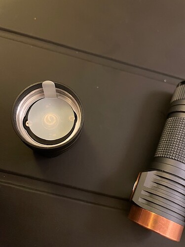

Ok. Rather than delete and hide, I’m gonna take this one on the chin :grimacing:
When I put a light into storage, well, a picture tells a thousand words. Or one one in fact, and that word is ‘idiot’. :joy:

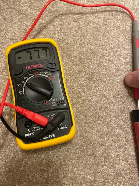

This light does have a parasitic drain. It went into my van fully charged, has been used once to show off while camping out with friends mid July. Grabbed it this evening to rush round to a friends house as she thought someone was shining a light around at the end of the garden (she’s nearly blind and was unsure, but scared). Acebeam P20 battery completely drained, I’ve just put it on the multimeter and it’s reading a flat 0.000 volts.
As pointed out, there’s a mechanical tail switch so I don’t see that it can be a problem with the internals of the light, but maybe this pesky Acebeam proprietary battery is draining itself?

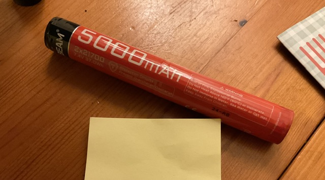

Just to wrap this up, a new battery arrived today very well packaged from Acebeam, so many thanks to their customer service for sorting it out.
Old battery has sat in the light unused and fully charged. Put it on the meter and it’s down to 7.7v, so there’s definitely something amiss. Hopefully it’s within the battery and not the light, time will tell.
