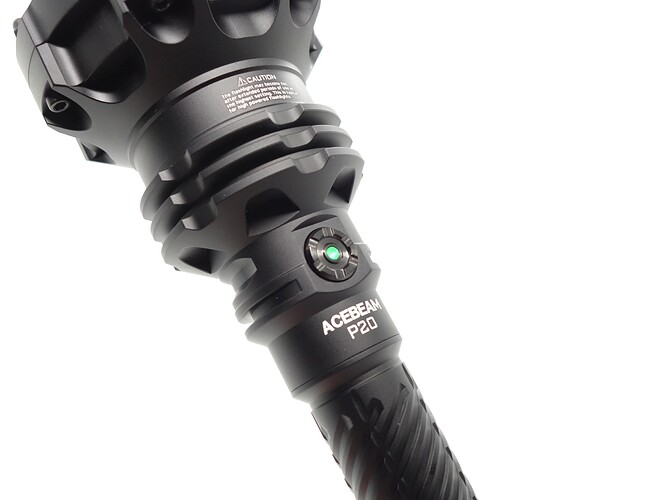

Acebeam P20 "Bonking" Torch Review
The Acebeam P20 is a 2x 21700 light with an SBT90.2 and a smooth reflector. It has an electronic Side Switch and a forward-clicky Tail Switch.

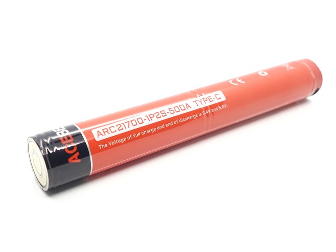

It comes with a battery pack. But you can use long button top 21700 cells or unprotected 21700 cells with three spacers. The Tail Switch needs the battery pack to work.

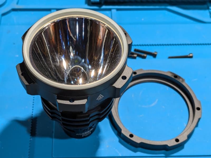

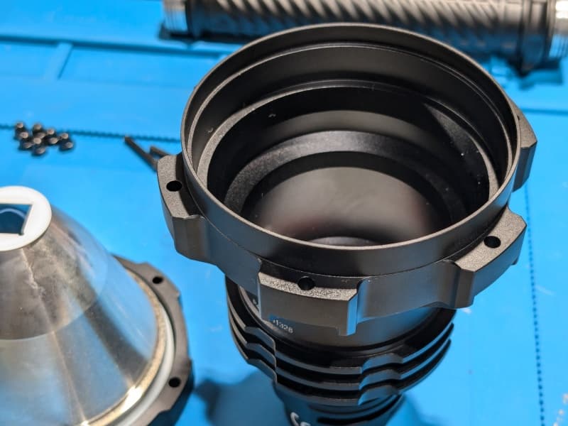

I added some teardown photos to my review:
