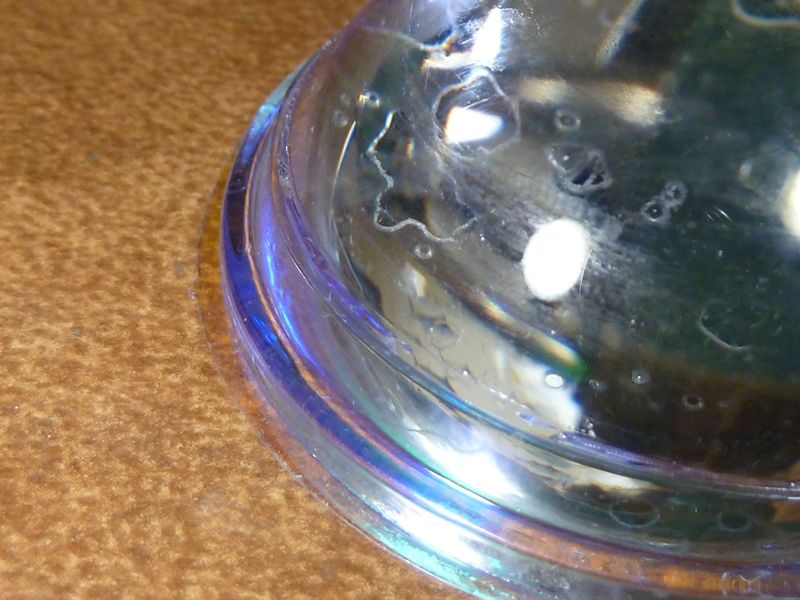

WTF? Got mine and it's total junk! The glass aspheric is loose, just banging around in the housing and the LED is the cheap crap version - not as pictured, and I don't have to worry about it burning down the house because clicking the "1" switch it has, not 3, does nothing anyways.
Least I don't have to worry about measuring amps or lumens because both are ZERO!
No, I'm not upset...
Seriously, I'll take a looksy but with the old style XTE or something like that, with a resistor sitting on the alum MCPCB, I think there's no driver per say, just power that supposed to be provided by the sealed up clicker, but it ain't happening.

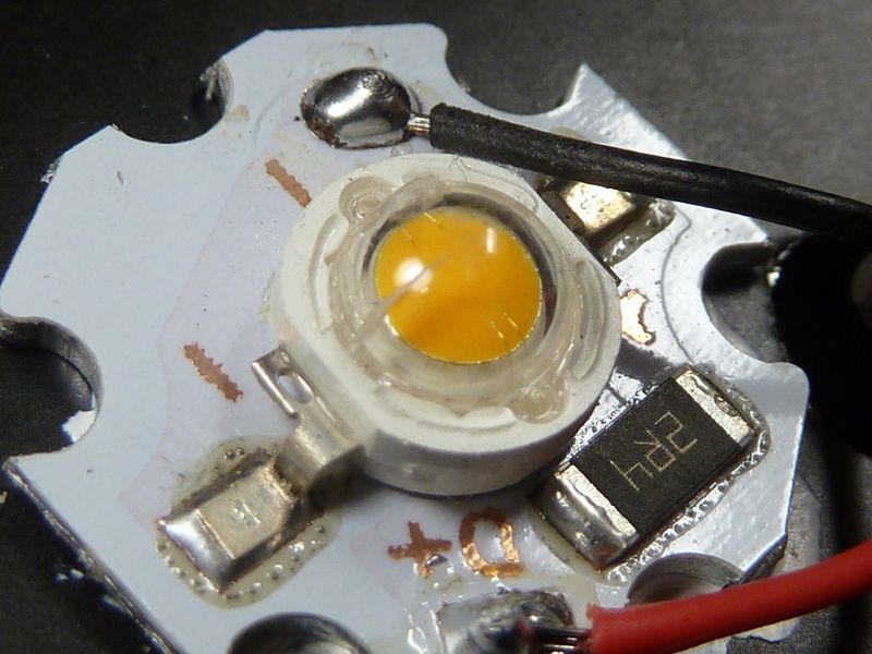

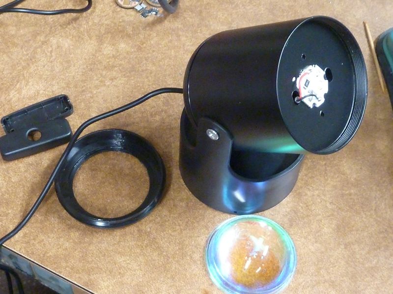

Alright, this is kind of funny. How do you screw up the simplest LED light in the world?

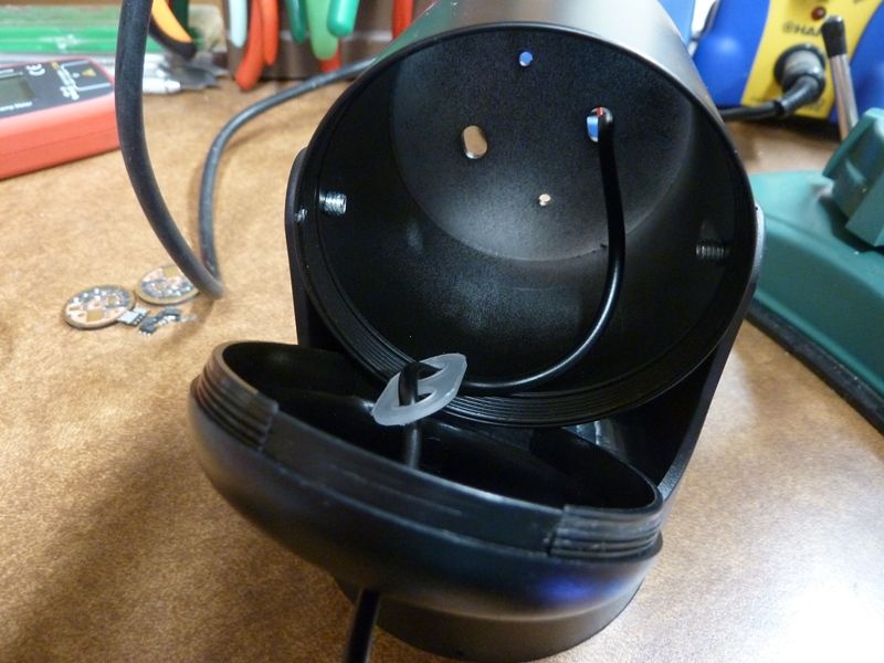

What is that resistor doing there? No, must be a driver somewhere
Hhmm, not here:

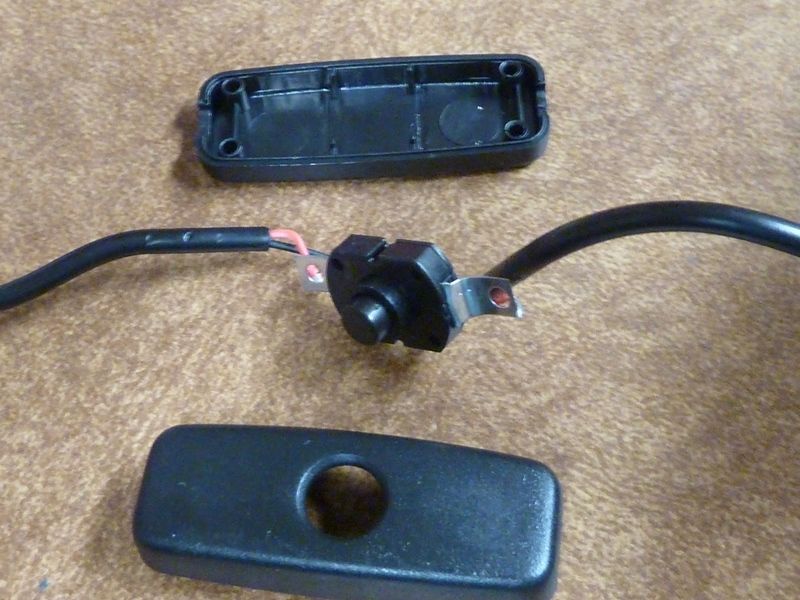

How about in the switch assembly? No...

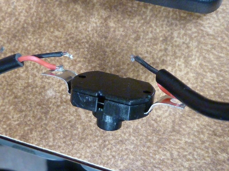

Oops, the great factory soldering job didn't hold up too well:
That's easily fixable - I probably broke it when I inadvertently pulled on the cable to undo it from the USB connection. No strain relief, nothing.
So what happened to the driver? It doesn't exist. That 2.4 ohm mounted on the MCPCB is about all it does.

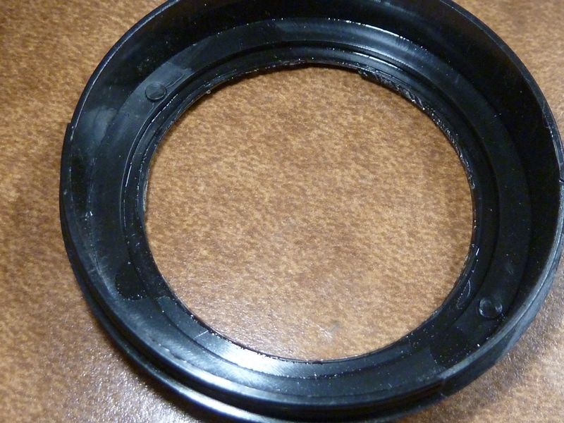

So bottom line, the LED isn't working - tried it direct from a bench PS. Probably broke from the glass lens pounding on it in shipping. They attempted to glue it down from glue traces on the plastic retainer ring and the glass edge.
So how cheap can you build a light? Can anyone beat this one?
