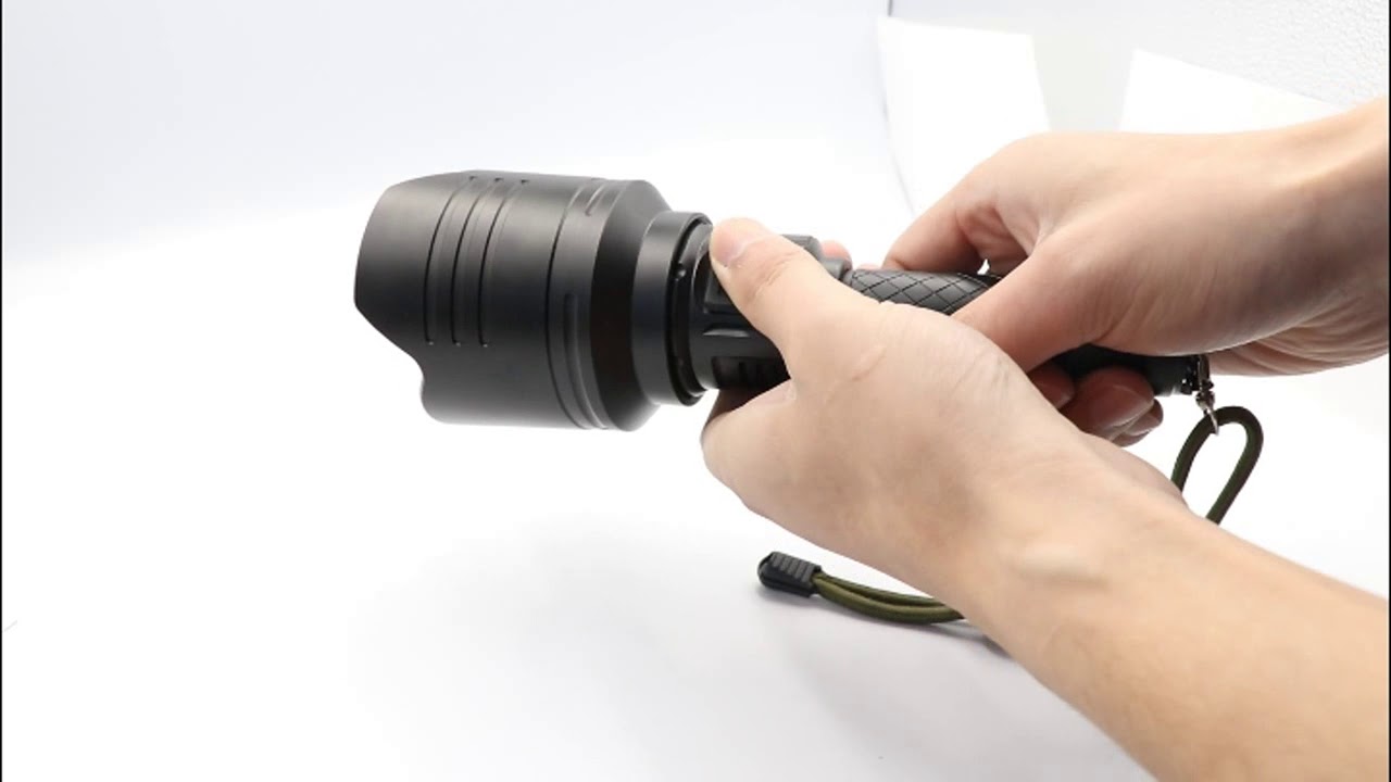

An interesting find on Banggood (big zoomie) XANES X915 P10
Saw this zoomie the other day, looks interesting - what are your thoughts? LINK $52
XANES® X915 P10 Telescopic Zoom Flashlight 4 Modes Waterproof With 18650 Battery Torch Light

I'm skeptical. Looks more like computer renderings than actual photos.
Yes, i see this very often with cheap lights.
I highly doubt this helps sales though, because it looks photoshopped / computer rendered.
Maybe for smart phone shoppers it’s not that obvious, though…
