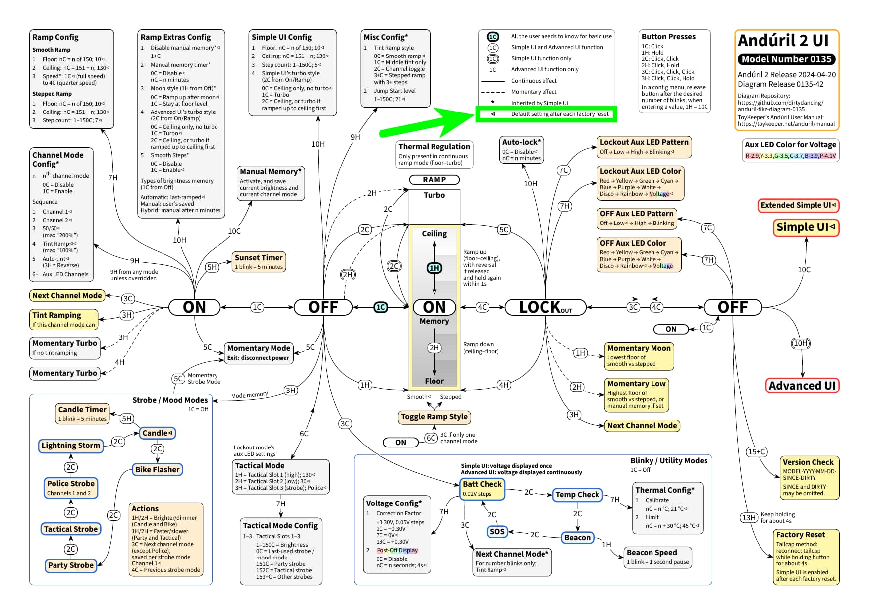

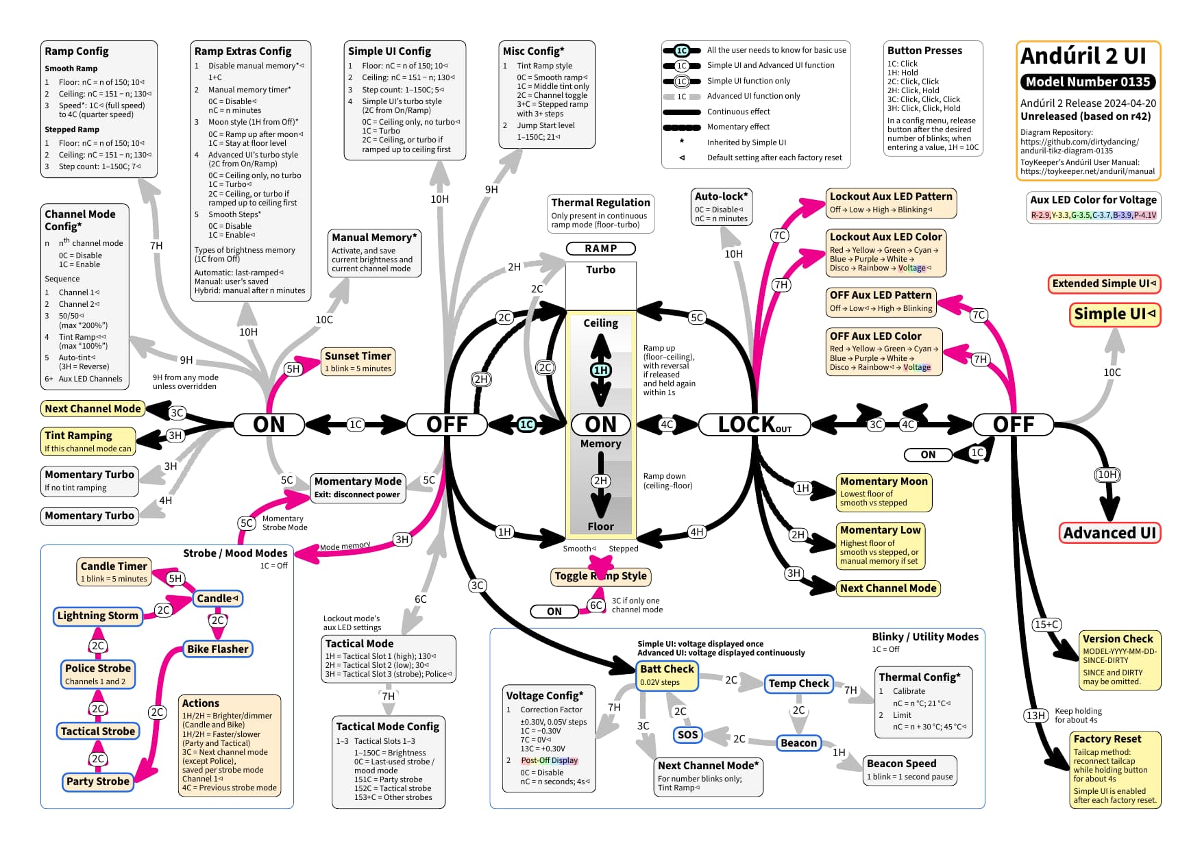

fwiw Anduril is very complicated. I change 15 default settings on my lights… here is a chart, thanks to containerfan, with green circles on all the things I change:
here is the clean chart:
