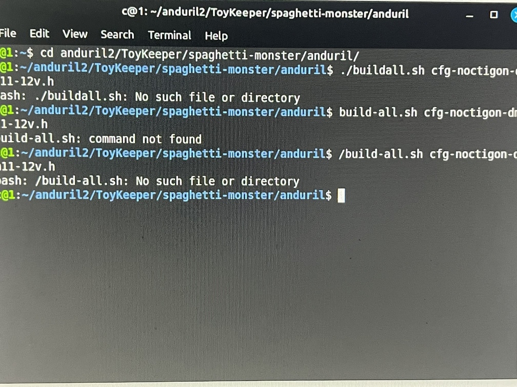

i have a dm11with a smokey b35am and i would like to throttle it within the firmware to get acces the the code as when using tactical strobe it smokes and there is no option to throttle it
here is the method im using to eddit the code
Install WSL.
In terminal, type ‘wsl’ (enter), then once linux is loaded install bzr with ‘apt-get install bzr’.
run ‘bzr branch lp:~toykeeper/flashlight-firmware/anduril2’
Make your code changes. Probably to anduril.c in the dir below
run ‘cd anduril2/ToyKeeper/spaghetti-monster/anduril/’
run ‘./buildall.sh nofet’ replacing nofet for your search term (whatever filename matches your desired build, eg d4sv2-tintramp-fet)
Done! Your hex will be generated in the same anduril folder.
what anduril file and how will i be able to impliment the led throttle so it will never go above my preset level even if i reset it?
