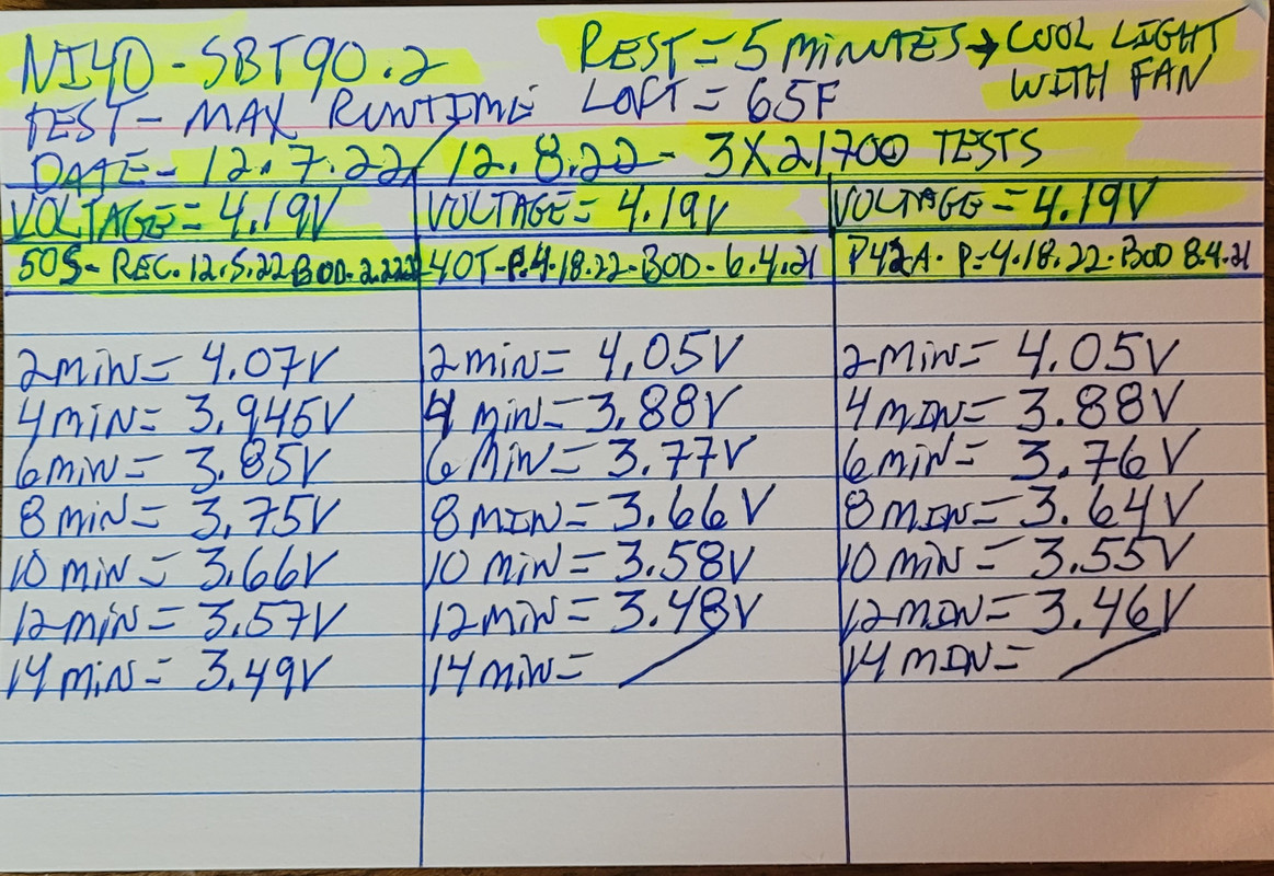

The test and the light is self-explanatory with the photo below. I will just say that the NI40 is modified. There’s no step down. This test is similar to way that I use it outside except for the winter time where I can run it more than two or three minutes.
I’m very happy and grateful for the Samsung 50s. I have nine of them. That is my go-to 21700 battery. I have a few 21700 lights and a few 26650 lights that will take a 21700. I prefer it over the Vapcell G53 which was only a few hundreds of a volt higher in the same test on another 4x6 card. The 50s obviously pushes more amps.
P42A and 40T will take a back seat and I will purchase no more unless I can’t get the 50S.
Again my test is simple, it’s pretty detailed and very helpful to me.
One other thing about this test the batteries are resting for 5 minutes so the battery has a chance to rebound. That is when I take the voltage test for the record. I check it right out of the flashlight but let it rest and that’s where all my measurements are from. They are all on equal grounds as I use the timer/ stopwatch on my phone. I have no way of measuring it right when the load is taken off.
