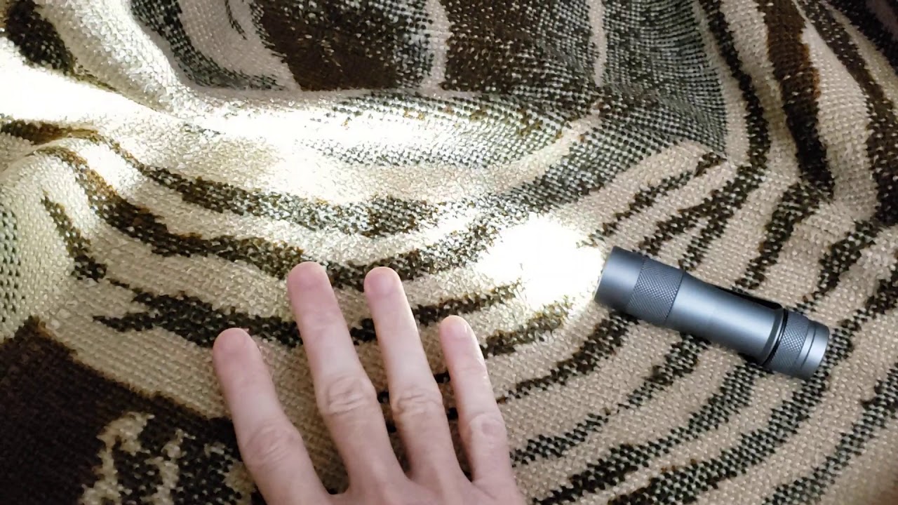

Hi,
This is for The PD90S which has Anduril.Original version…same as my K1. Where I had absolutely no issues.
I am 100% positive I am programming room temperature and thermal limit correctly. I did it with my K1 and a few other lights.
No exaggeration. I’ve literally tried this at least a hundred times that equates to over 6,500 presses of the switch! At least the switch works okay.
Click three times, three double clicks, Four fast clicks. Wait for flutter click 12 times for room temperature. Wait until flutter ends, then Two solid blinks then flutter and program for thermal limit. That’s where the issue is I make it to there do my 40 presses( now at 65 clicks!!) for a temp. Limit of 70C.
Instead of showing a solid beam it keeps blinking. It’s supposed to go solid after that when you stop and then you turn the light off to complete the process.
Setting the room temperature is a piece of cake. Doesn’t matter if I go at a slower Pace or a quick pace, it moves to the next sequence which is the thermal limit. I’ve tried the Thermal limit in three different speeds makes no difference. There must be something wrong with the electronics of this Anduril UI.
Honestly I’m not sure what you could tell me. I watched the video over and over to be refreshed I’ve done everything right it’s got to be a glitch but maybe you know something I don’t know.
PLEASE HELP… getting ready to throw this light in the river!
After about 110th time the light went solid after programming thermal limit. Then you’re supposed to turn it off which I did. Makes no difference it’s still steps down lights a piece of junk.
