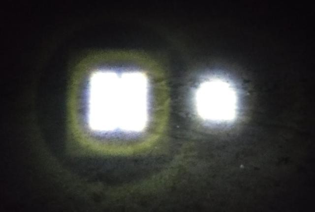

When fully zoomed, hotspot is about 4x larger area than an SK68.
They should have let the lens move just 1/8th of an inch further out to get about a 50% improvement. Quick mod with an O-ring behind the lens gets us part-way there.
Will take some time to see how much of a problem the larger hotspot is in practice.
