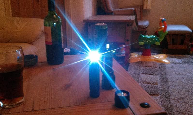

The packaging said Cree on it, it was £7.50. I got it for my step son to take camping with scouts but decided to have a little play tonight since my c8 q5 arrived. I quite like it and it maybe a potential mod host.
Um, no, sorry :8) I got it from Asda in England (bought out by wall mart) can’t seem to find it on their website, they may be available in red too but I like blue.

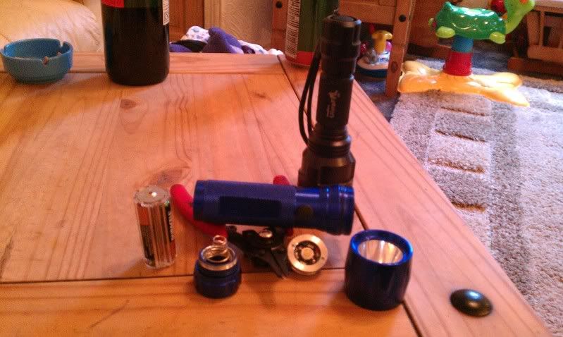

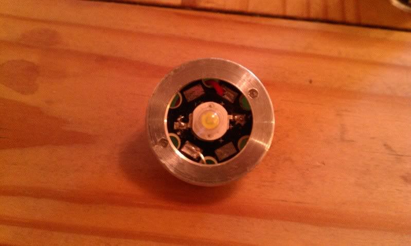

It is indeed a threaded pill, by eye it looks to be 17mm driver, 16mm star, not sure about the emmitter, I’ll have to compare it on flashlight wiki I suppose.
Switch is reverse clicky (no momentary on).
Reflector is relatively deep and smooth.

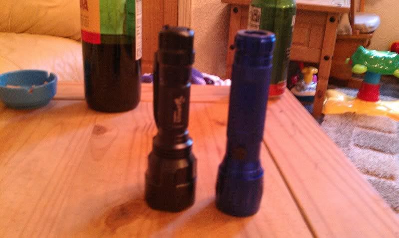

The light feels heavier than my c8. I’m thinking that since I’m planning a driver swap on my c8 q5, perhaps I should order 5 1.4a 3 modes, and get another one of these to test.
Battery holder is not brilliant but there is space in there, an 18650 is a rattle fit.
Ok, did a bit of comparing tonight, the reflector will sit over an xm-l…….
The pill threads into the body of the light, with the reflector/head assembly screwing over it.
I’m thinking of modding my stepson’s to an xp-g/1.4a driver and getting some eneloops, and getting one for me, fitting an xm-l u2/2.8a driver to build a little pocket rocket run on a spaced 18650/eneloops depending on if it ends up in swmbo’s bag. I really like this little host! :bigsmile: 8) :cowboy_hat_face:
These will be my first mods, but a driver/emitter swap is, as far as I can see no worries - unsolder driver/star, extract, fit new driver/star, hit magic button. I’ve no idea of the switches current handling capacity, but I’m sure that can be dealt with in due course. Roll on pay day!
