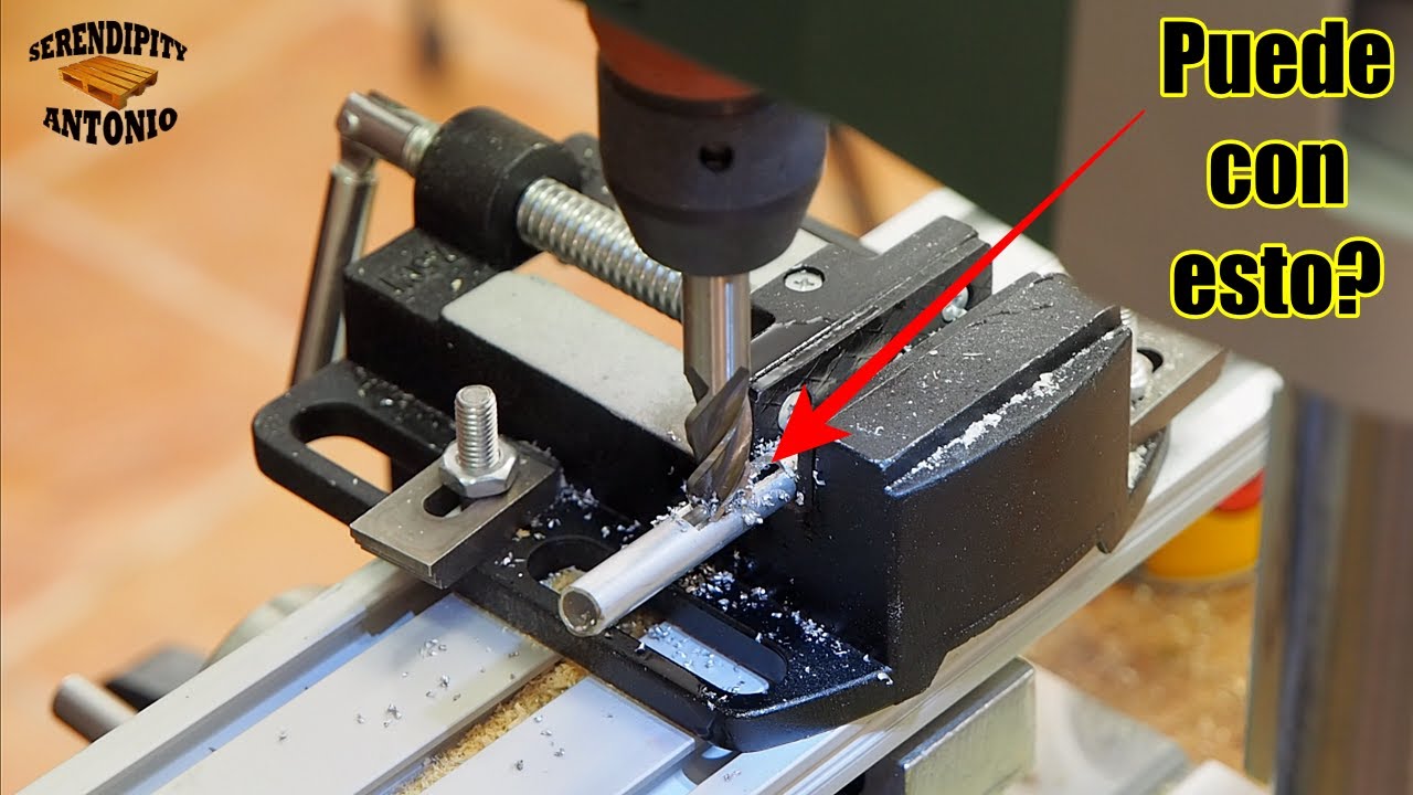

You know, I agree with both of you - oddly this one is the most expensive of all of those ‘type’ of ones.I did watch a video on BG’s site, but it was in Spanish I think and it did seem to wobble a bit. That said the guy didn’t have the speed anywhere near fast enough. The video on BG he uses a bosch drill, and it is almost identical to the one I just got from Aldi (cosmetically it’s different, but you can see it’s the same underneath), the woman said they all come out the same factory, I believe her now lol!

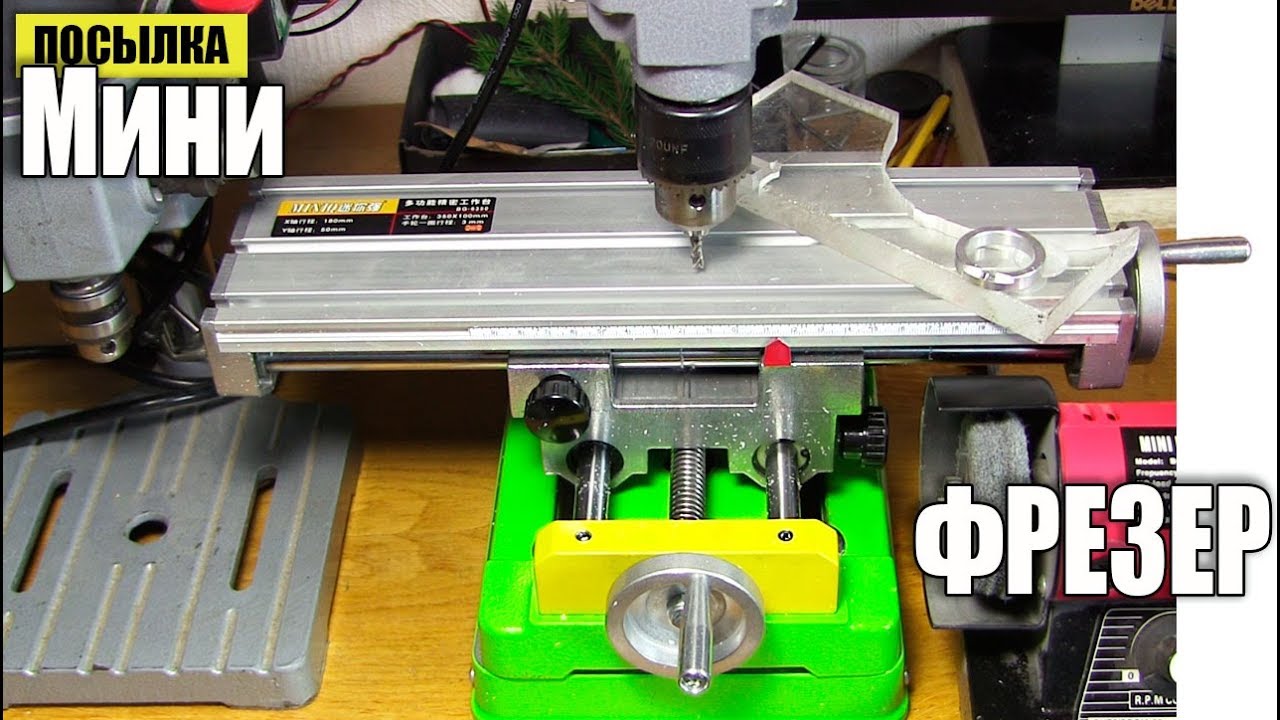

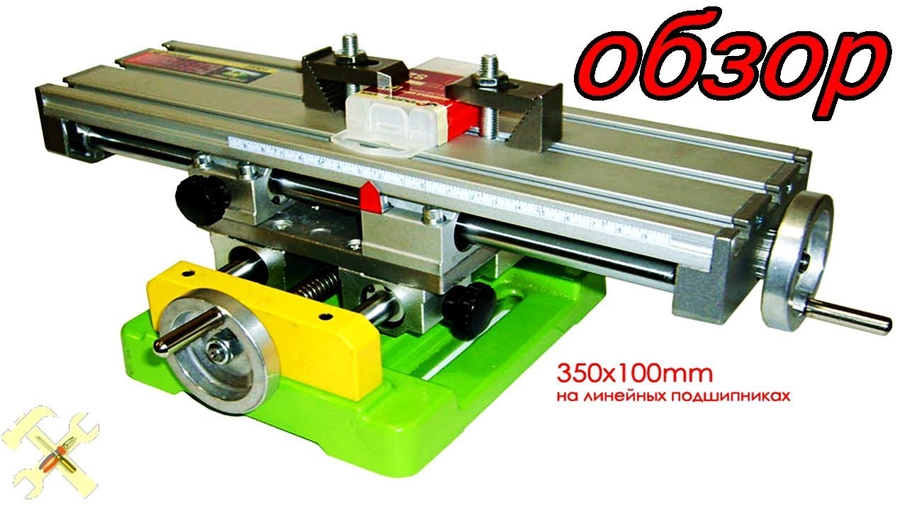

Here is a better video, but in Russian (I think) seems to be ok for light stuff, which is all I’d use it for. I think even in this video it could be faster rpm, seems slow.
I’ll get the Mrs to translate it later after work ![]()
