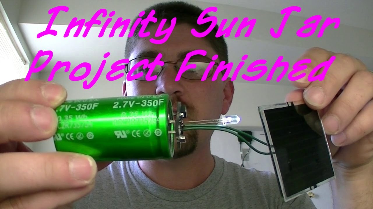

Watched this video
Supercapacitors Instead Of Rechargeable Batteries: http://youtu.be/brw6sC8D2_w
A lot of others on there too
5V to 2.9V =2.5 minutes runtime… I think I’ll stick to batteries :smiley:
Yup, supercaps are good for extremely high current draw at hundreds of amps, but have really poor capacities compared to chemical storage.
Some people use it to hook it up in parallel with their car batteries to support while driving uphill or using the A/C, but I don’t see it replacing them soon.
Yeah the runtime isn’t great yet BUT they recharge a lot quicker.
The same amount of charge/ time gave 4x the runtime in this video
Supercapacitor (Part 1): A brief introduction and…: http://youtu.be/4rVC0IvT63w
Although the capacitor in that video is only 1 Farad, more what he could find locally. Sounds like he had a solar project for a Kindle. The capacitors have a much lower internal resistance.
Another video the guy got 277 ma out of a couple super capacitors. If my math is right, that would give me 5 minutes or so at 3 amps on XML t6. Enough to look around the yard. Although the voltage was low on part of that
Really? Would like to get more info on using these in cars if you have a video or page or something
Looks like he had a faulty battery. Got more out of the same charge time with the AA’s of course you can run more amperage to a capacitor.
