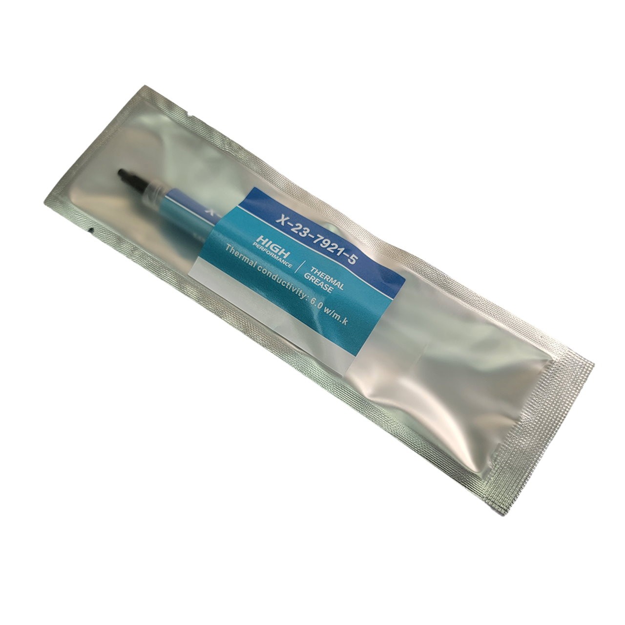

Not to argue over brands or anything but for longevity, you want a non-solvent type compound or just use something like Fujik. Pull off an old CPU and you might find the paste has dried out and conducts heat worse than no paste at all. Depending on use, solvent types should be replaced every few years. This what I’ve been using:
http://www.microsi.com/user/document/DS%20X23-7921-5.pdf
If anyone knows of another reputable brand that makes a non-solvent type, please share.
