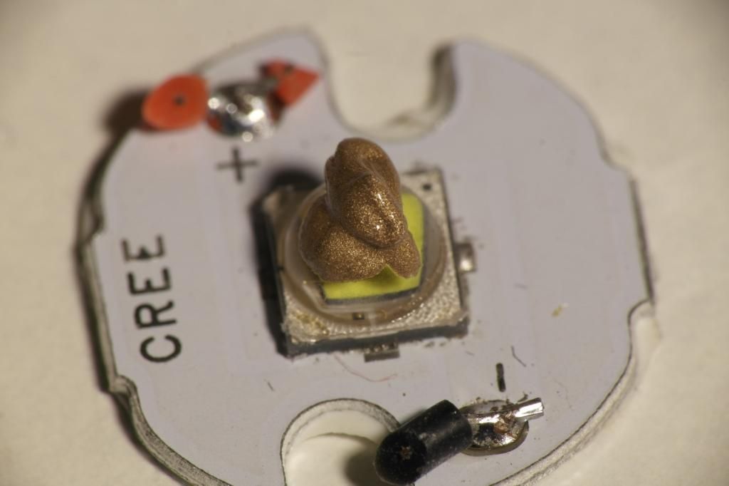

To the guy in the Video:
This is the right way of adding thermal paste. Directly onto the LED, so the heat can leave as fast as possible.
:wink:
Nah man gotta have the paste inside the dome for ultrafire level heat transfer ;)
I normally use a small syringe to carefully coat the die while leaving the dome in place. A nice thin layer right on top of the phosphor is ideal.
:wink:
