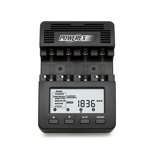

I’ve been using batteries and chargers from https://mahaenergy.com/ for a long time for NiMH. I don’t know how they compare to items normally discussed here. I also don’t know if they trickle charge.
I have the this and like it but it’s discontinued. Some vendors may still have them in stock.
This is the new version, which I have not tried, but I would expect it to be good.
I have this from years ago and I like it, but the fan is failing. It shows as unavailable but you might be able to find a modern version. I don’t know if it trickle charges.

I swear by the Maha chargers. My original C9000 from…15(?) years ago is still going strong. I’ve bought the more recent C9000Pro and it’s a worthy successor. I also have a few C800S chargers that have to be at least 12 years old and they’re still working fine, day-in, day-out. The display faded a little on the one but it’s still readable and still working.
I have noticed that some of my Eneloops are starting to get “old” and many of the smart chargers turn their noses up at them. For those, I toss them in an Xtar VC2S or VC4S and they’re quite happy with them.

If the new C9000PRO is like the ones I have used for years, the 50 mA that it trickles at will do nothing but help the batteries if left in it for a few hours after termination. (for NiMH cells, NOT LiION)

I would not touch maha or powerex chargers. overpriced and absolutely crap. and they give no support.
look on reviews on amazon and people all have the same complaints. screen is anemic. you cant see anything.
the cord comes out the back is so stiff with a small horrible connector. it bends the pins inside too easily.
get something with a side connection or one with a thinner wire so it doesnt leverage the cable pins and gets bent easily.
I use many chargers and aa batteries as I shoot weddings. these powerex / maha are garbage design. look elsewhere
im not saying a specific brand to buy. im saying, from my very short experience with these garbage chargers that effed up the design. ive already posted it to many groups online of other pro photogs not to buy them.
Interesting. I have 5 Maha chargers. 4 Mc9000s and an 808. From 5 to 8 years old. They all work great. Reviews and experience show that their algorithm is spot on. They are very flexible in use. None have given me ANY problems… AND I use them just about daily. I think I have 15 chqargers, including a few of the ones that were recommended in this thread. They don’t get used that much (not until I have to charge more than 24 cells at once). Sorry you have had problems, but I thought I would give the other side of the story.
Though I do not have experience with the new version of the 9000… so YMMV. But the reviews on it and test data show it to be a great charger too!
you can have 70 for all I care. theyre hot garbage. for free I wouldnt take it. I make sure to constantly to let as many as I know not to touch them
I also have to believe there are pr reps who downplay negativity on products.
the battle for products are online so many companies have representives online in forums and such playing as regular users like yourself. undercover pr reps. I am no rep because im no fanboy to any company.
but actually amazon reviews otherwise. screen is dim, you cant see a damn thing. nothing. the shetty stiff cable in the back is badly designed. so when you want to see whats happening, you lift it upwards tilted at you. slowly over time, you bend the pins inside the connector, then it slips out, you try to push the cable in, but the pins are bent. it will go in, and then it will short itself. 3 months and failed charger. absolutely garbage. and the power brick is HUGE and HEAVY. I couldnt even carry such a thing with me to weddings its a nuisance. and the fit of the batteries in the tray is crap. I need a small screwdriver to leverage them out each time. they sit flush in the tray. pita to remove.
garbage chargers. overpriced garbage. you can easily buy better chargers for less. im certain I persuaded MANY photographers from ever buying their chargers. a few even agreed not to buy them.
I have an Older Powerex C9000 —Great charger and has been for years — The 12v Wal-wart is sort of small , the cord is very flexible and the screen is nicely visible —it even has a fold out rod underneath to raise the back for heat and visibility — I always use this charger for testing my batteries — I like the rest period between cycles
I also have several USB chargers from different manufacturers for everyday charging , plus all the Opus, MiBoxer , Vapecell , Etc
Must be some long Weddings to be able to fully charge NiMh in the field —— I’m no professional and I have well over 200 AA and AAA batteries
could the c9000 was a time when they cared to make good products. on one hand, the charger I have (1 powerex is dead) does charge batteries fast. but there is a HUGE delay from when you put batteries in the tray, till it decides what situation they are in and till it shows it. extremely slow
the other HUGE flaw is the crap screen thats so dim. no backlight at all. im going to take a picture so people can see how horrible it is.
also they give you an 8 cell holder for the batteries. super hard to fit batteries and close it. you really need to fight with it.
we shoot 12 hour weddings. yesterday I took it with me and regret it. it charges fast but has so many other flaws. its bulky and heavy. and at the place, the lights are off and you cant see a thing on the screen. forget about it.
the cable on this charger is extremely stiff and thick and not flexible. vs the vapex tech, vs the tenergy or even the cheap ikea 8 cells chargers. the power brick the powerex comes with is HUGE and heavy.
how many cells you have, isnt relevent. I have cells because I use them for work.
garbage product. complete waste of money. customer service is crap too
