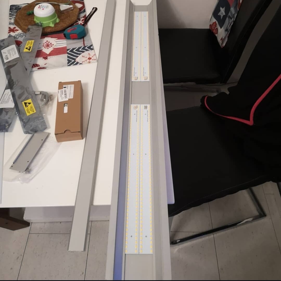

I got strips with samsung lm561c 2700K, 96 chips per strip running off meanwell driver.
https://a.aliexpress.com/_EzQ8X0Y
These are lm301b, even higher efficacy, in the range of 190-200lm/w, depending how hard you drive them. Depending of what kind of plants you are growing you might want additional red spectrum for flowering plants.

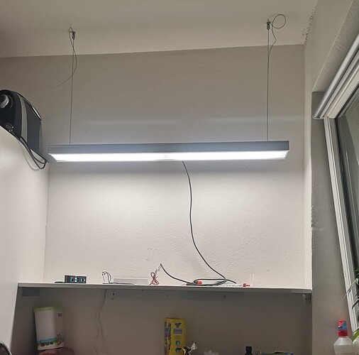

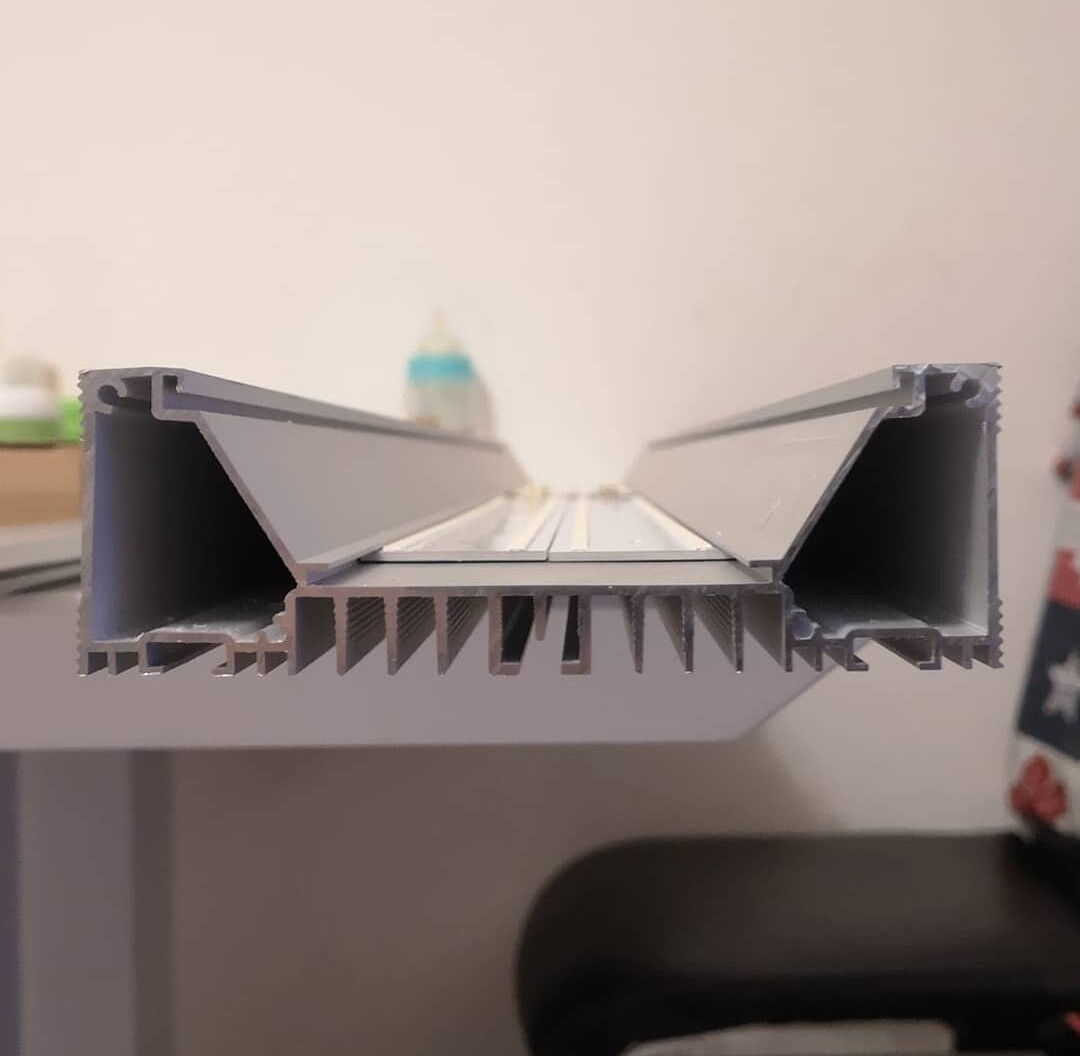

This is a light I put together for my kitchen for the herbs, running at 60W

These are just 4000K strips
I also have 2700K units and they worke fabulous. No need for UV or near IR

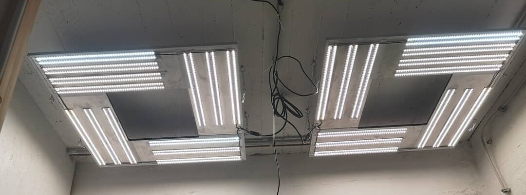

I already have 3 of those big square panels, and one small one that runs on 12V. All of them I bought like 8 years ago. The big ones use 60-80v drivers, and I can’t find dimmable replacements, so I just won’t use them.

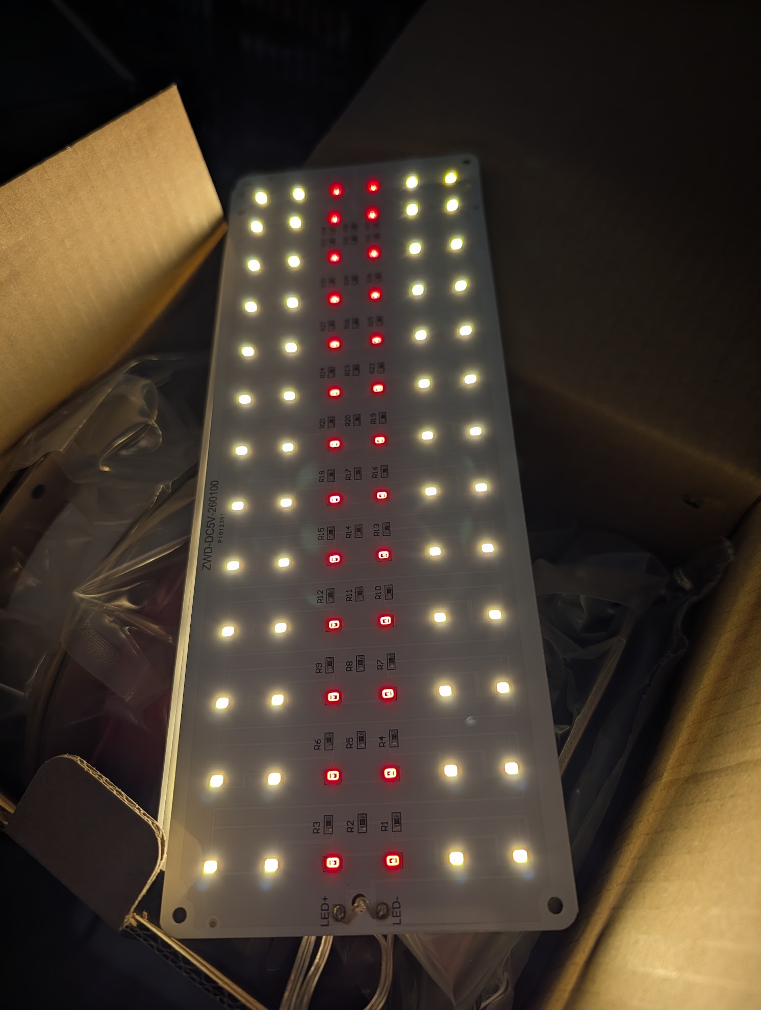

I just bought these: https://de.aliexpress.com/item/1005008117544488.html for USD27.63 - couldn’t resist at that price.
Most growlights are either for USB or for undimmable CC drivers, so these for 24V CV are wonderful because all I need is a cheap PWM dimmer to get them to where I want them to be.
To use this thread as some sort of “”“review”“” thread…
I like these. I have plenty of USB power supüplies laying around, so powering these is no big deal. It won’t be ultra efficient, but I don’t chase that anyway.

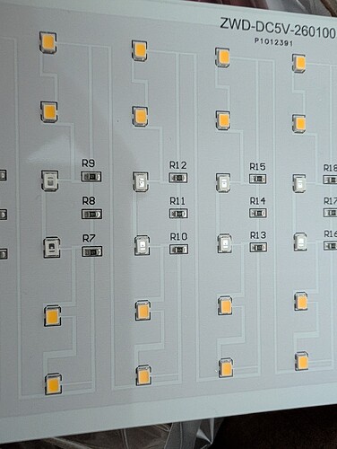

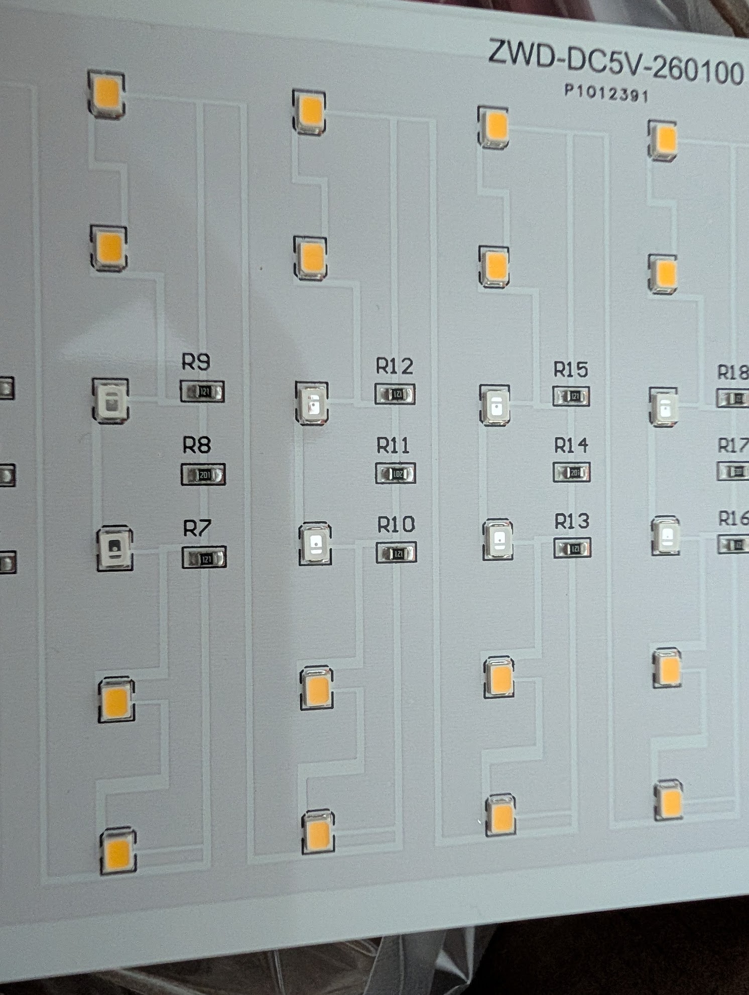

The panels are 26x10cm
One resistor per 2 LEDs, the red ones in the middle habe different resistor values than the white ones.
These LEDs are severely underdriven, the MCPCB barely gets warm

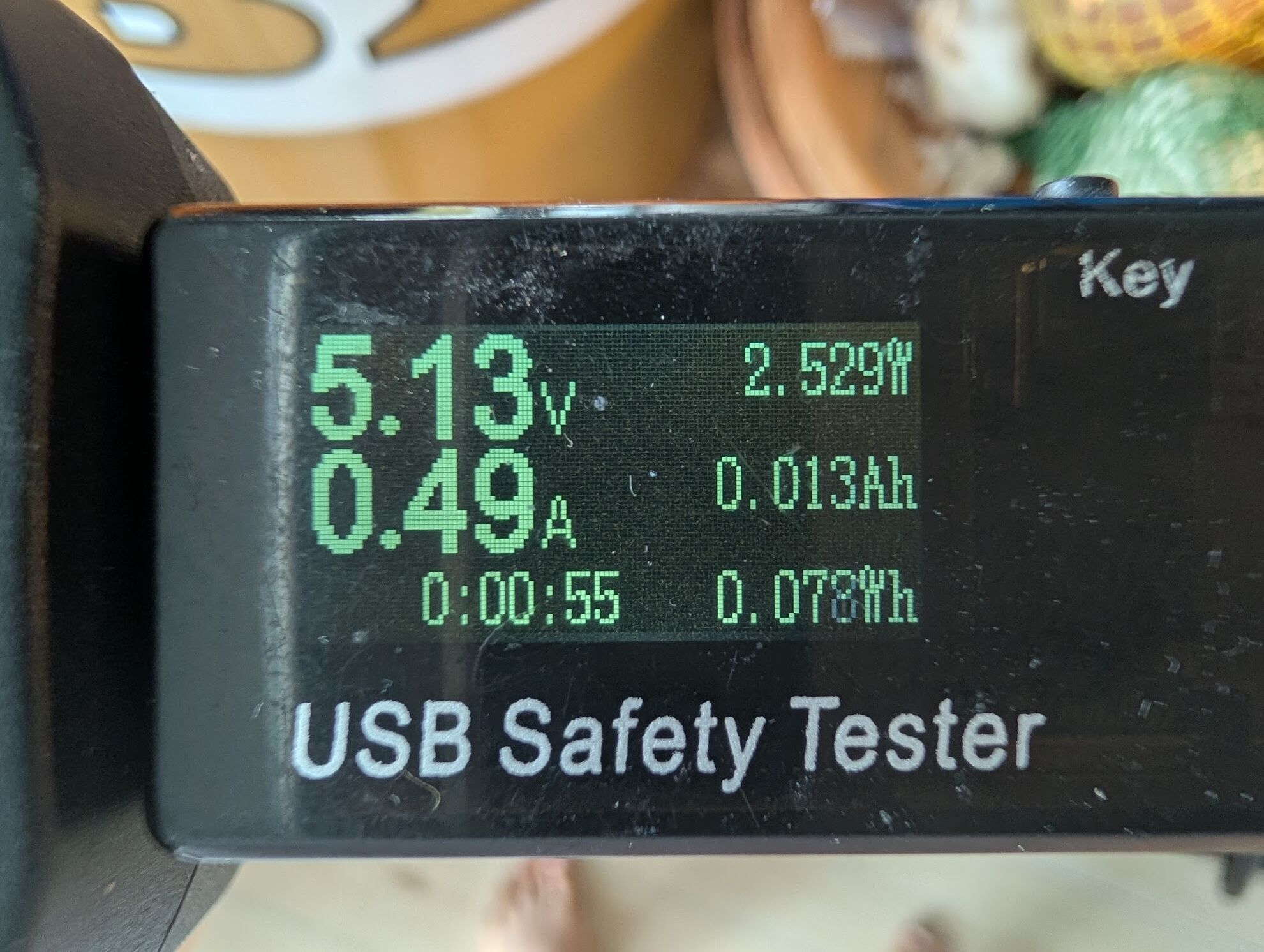

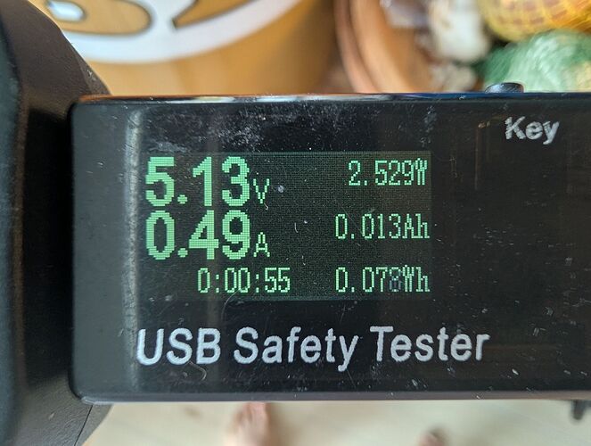

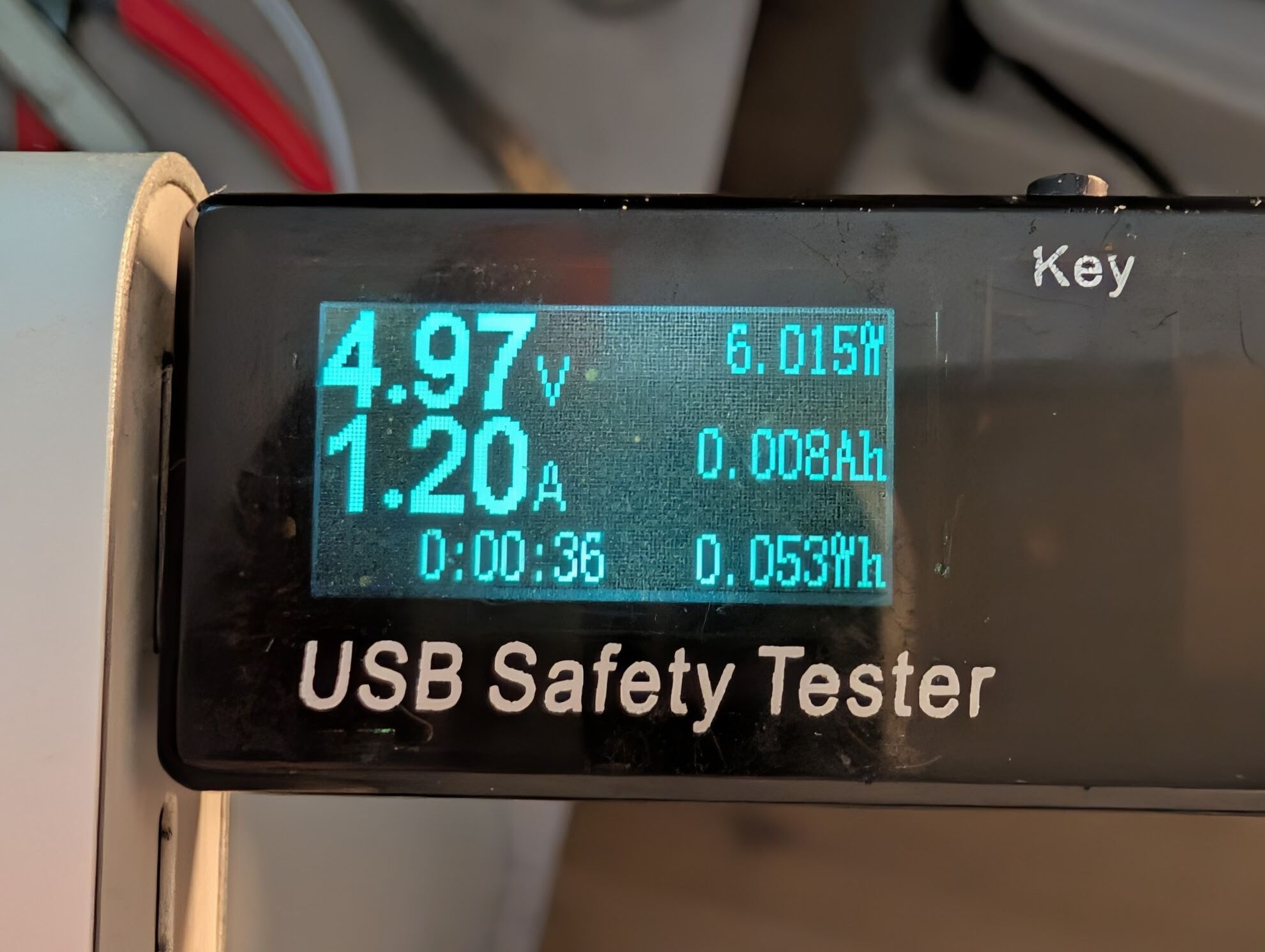

3 of them with the little timer box inbetween draw around 2W per panel
Directly on 5V one panel draws 2.5W
I would wish for some cold white LEDs on these, to push out a little more blue light. Maybe I will change a couple of the warm white LEDs with blue or cold white ones.
Not that I know anything about plant lighting, but that’s what I found out, a little bit more blue light would be better.

Edit: I did switch out 16 of the warm white LEDs with cold white ones and I have some blue LEDs on order. I will put probably 2 or 4 blue LEDs on these modules.
