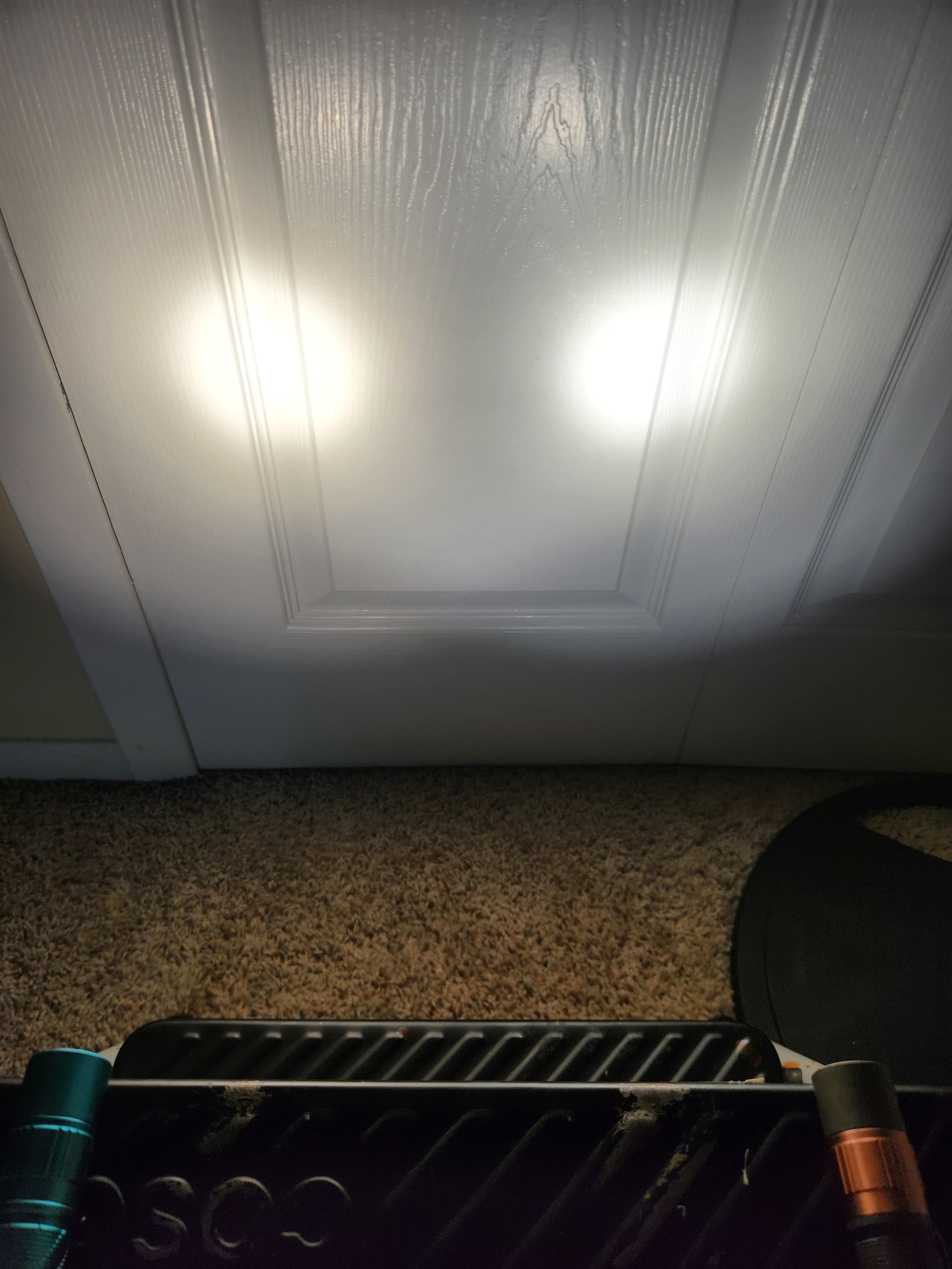

Around the house, small light with rosey beam

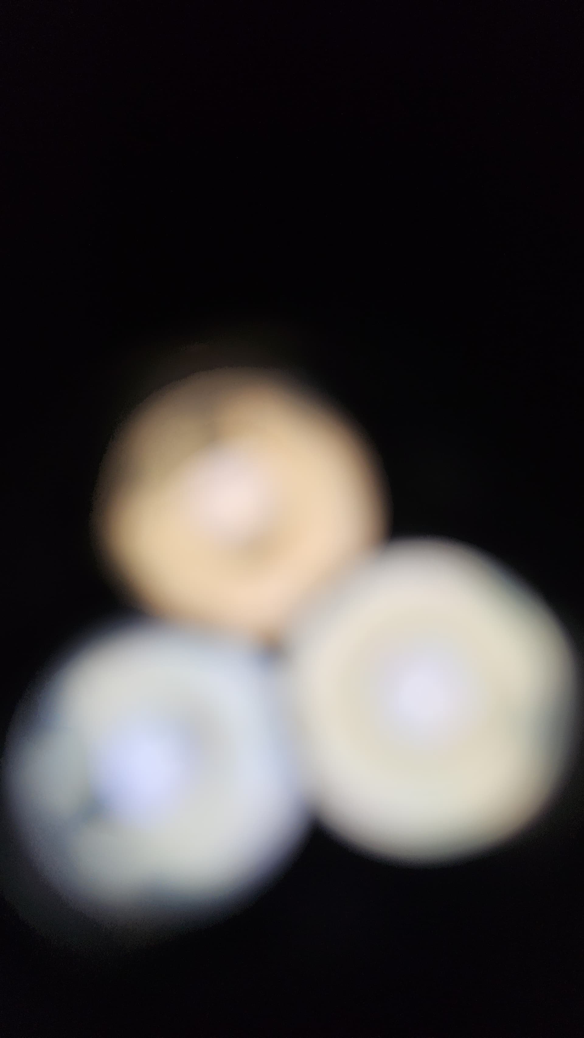

I purposely ordered mine with 5700k, 5000k, and 4000k, lol…point blank, it looks weird, but at distance the blend is quite nice.

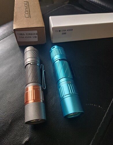

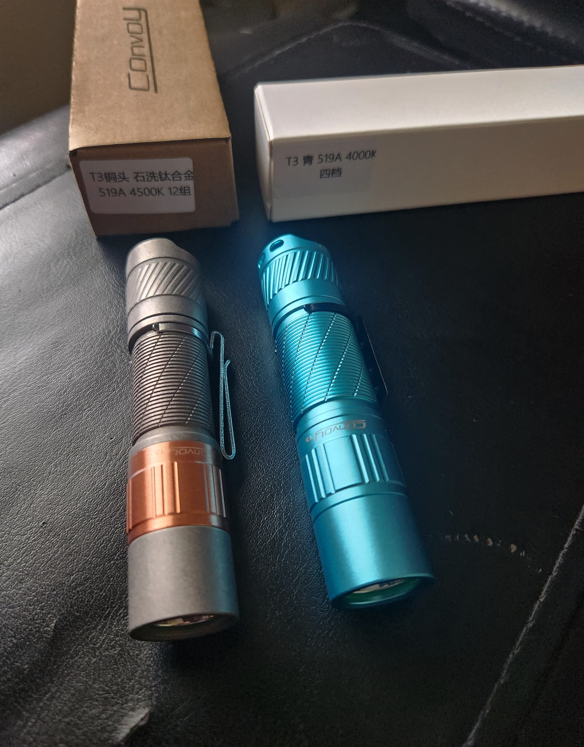

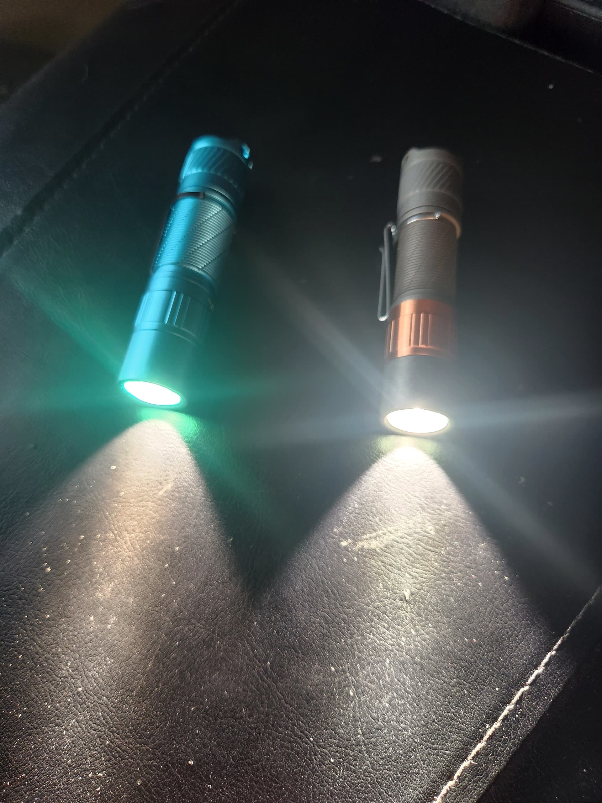

Our Convoy T3’s showed up today. Nice little lights these are! I love how easy they are to disassemble, easily screw apart in 3 different places. I prefer the rubber tail switch on my wife’s compared to the one on the Ti version…something I didnt expect. Also prefer her 4000k to my 4500k. Seeing how easy it looks to dedome, I’ll likely do mine later this evening. If I don’t like it, oh well!! I’ll have learned something and it only cost around $40. I’ve wasted more money for less many times over. The fun begins!
6 Thanks
Congrats and thanks for the great photos
glad to hear youre enjoying your Convoys
Go for it!
I really like DeDomed 4500K, it becomes 3500K… nice and warm with a rosy cast, good indoors after dark.
Thank you, and thanks for the insight and photos! I will absolutely dedome tomorrow during lunch at my desk. That color looks great for my intentions.
I look forward to your success!

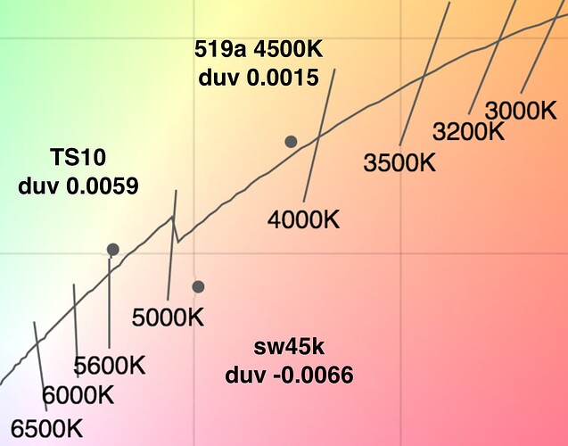

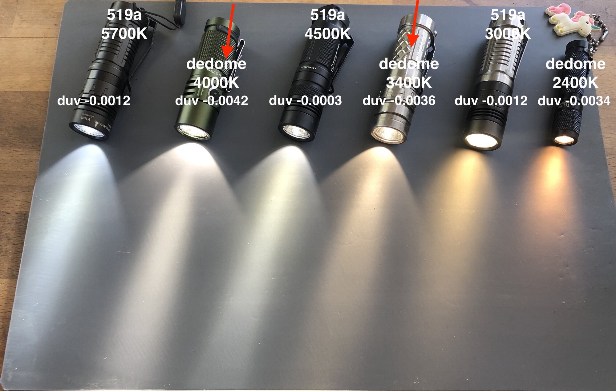

What is the relationship between starting CCT and rosiness? IE would a de-domed 4500K be more or less rosy than a de-domed 5700K?
Rosyness is mesured as Tint DUV, which reports how far below the BBL the tint falls.
another factor is Color temperature, measured in Kelvin and reports how warm or cool the color is.
imo a DD5700K will look cooler and more rosy while a DD4500K will look warmer, and more orange

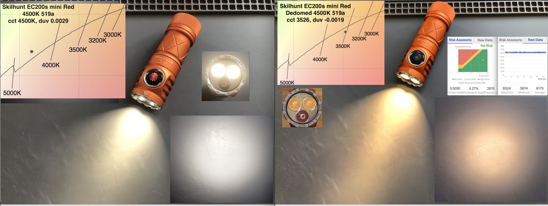

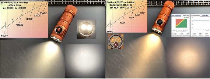

red arrows show the DD5700K and DD4500K:
their Tint DUV is almost identical at -0.0042 and -0.0038. Which looks more Rosy to you?
Rosyness can also be quantified on a spectrum plot… farther below the black line (more negative DUV), is more Rosy:
Thank you, that makes sense of it. In the photo I agree that the 4500K de-domed looks more yellow and the 5700K looks more white with a hint of pink. The diagram bears this out, looking below the BBL at the cooler end it’s more pink and at the warmer end more orange.
On that basis I’d probably like a de-domed 4500K more than a de-domed 5700K.
glad it is helping make sense
