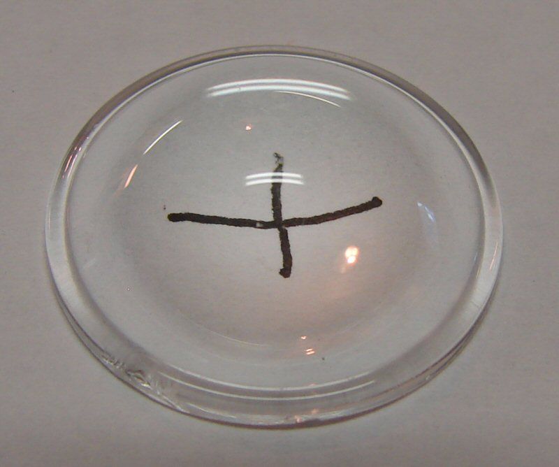

1

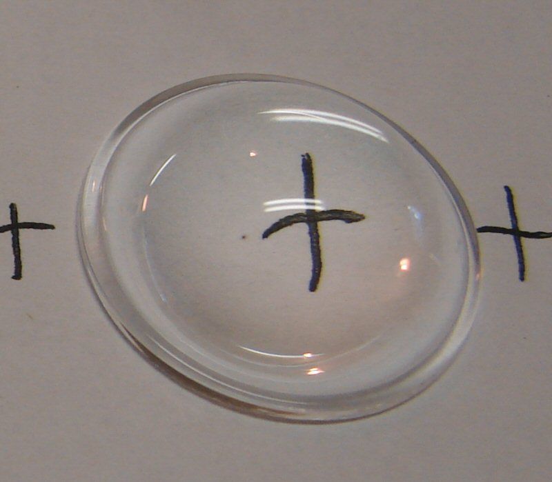

2
The biggest lens (and the one I really wanted) is a "75mm" and it measures 74.75mm OD. I am going to use it in a shower head, fitted to a Maglite with an SST-90.

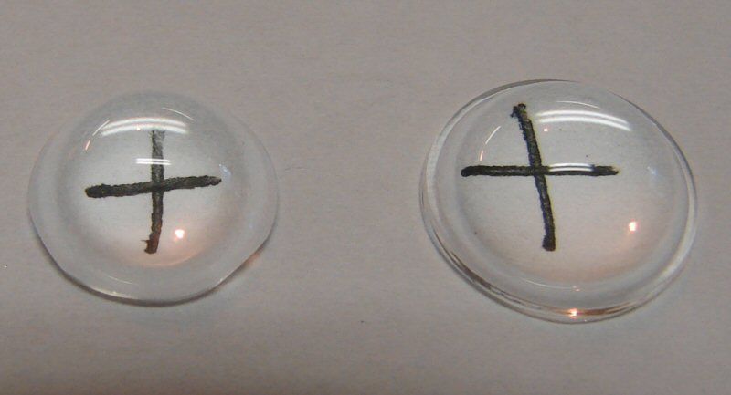

3
Here are the 13mm (13.21mm OD) and 15mm (15.12mm OD), notice how the 13mm is deformed.

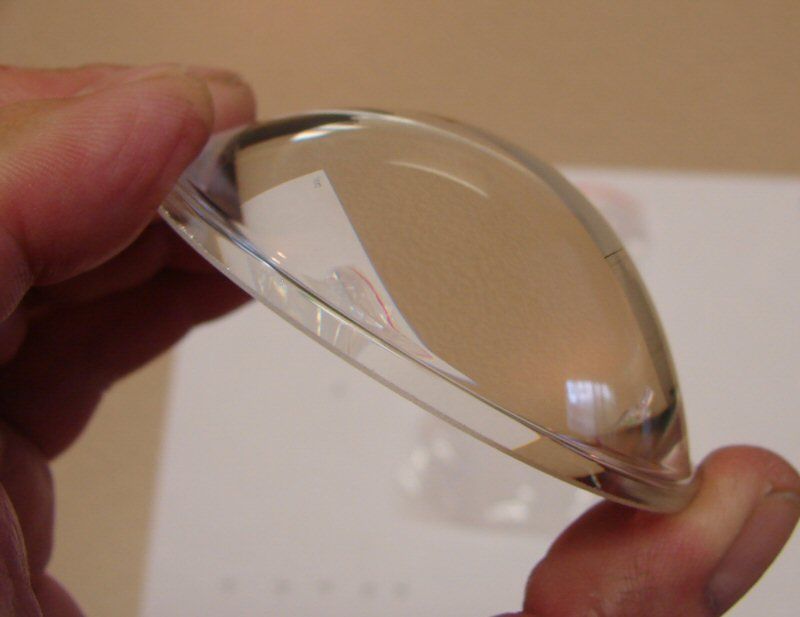

4
The 23mm (22.86mm OD)
