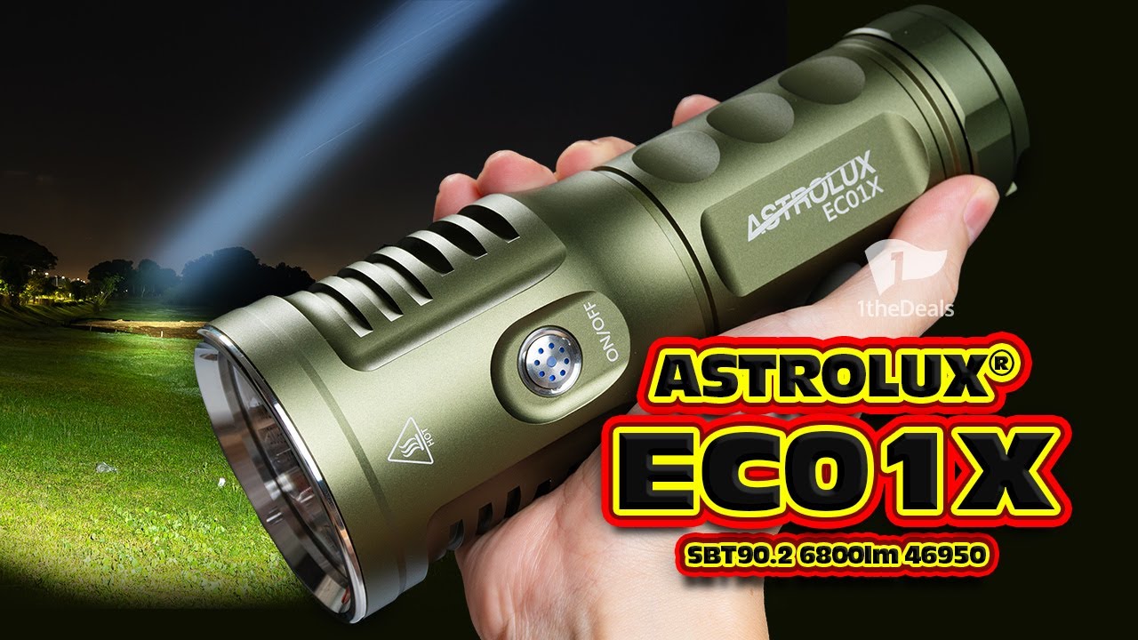

From my experience with testing sbt90.2 lights this is pretty common. If it can do 1750 Lumens sustained, that’s not bad. Depending on the amount of thermal mass and the ATR algorithm/limit, the step downs are pretty quick and the regulated output isn’t good anyway unless it’s a buck driver like the Amutorch DM90/DM90S, Acebeam K75, etc. use. This light doesn’t have a lot of thermal mass (most of that 1 kg is in the battery…it’s 430 grams) and probably uses an unregulated FET driver, so don’t expect good sustained output. This is even worse for lights with unregulated drivers running Anduril.
No, this flashlight is supposed to have a buck boost driver. We see from the chart that this is probably true.
The problem is that the temperature limit may be set too low or the driver may not be efficient enough.
It’s a big flashlight, big enough to stabilize more. 1500lm would be ok. My X9L lumintop can sustain 800-1000 lm…
I highly doubt it’s a buck boost design. Maybe a Fet+buck driver, but this is not common from Astrolux/Mateminco. For this one I’d be happy with 1750 Lumens sustained as long as the ATR keeps it hand friendly. Testing will prove that or refute it. Historically, Sbt90.2 doesn’t lend itself to efficiency…low vF and thermal resistance draws as much current as it can take or the power source can provide.
Sorry, you’re right. I meant buck + fet. SBT90.2 is not very efficient, but the driver makes a big difference.
Let’s look at other flashlights with SBT90.2:
Acebeam K30-GT stabilizes 2360 lm in turbo, 2000 lm in high.
Fireflies T9R (which I have) stabilizes 1200 lm.
I hope that there will be other measurements, but this one is not very optimistic.
Here is short video of EC01X in action I think first reviews will come soon too.
hi, when will we have the review?
This is a pretty revolutionary light and battery combo. I wish they offered spare batteries.
