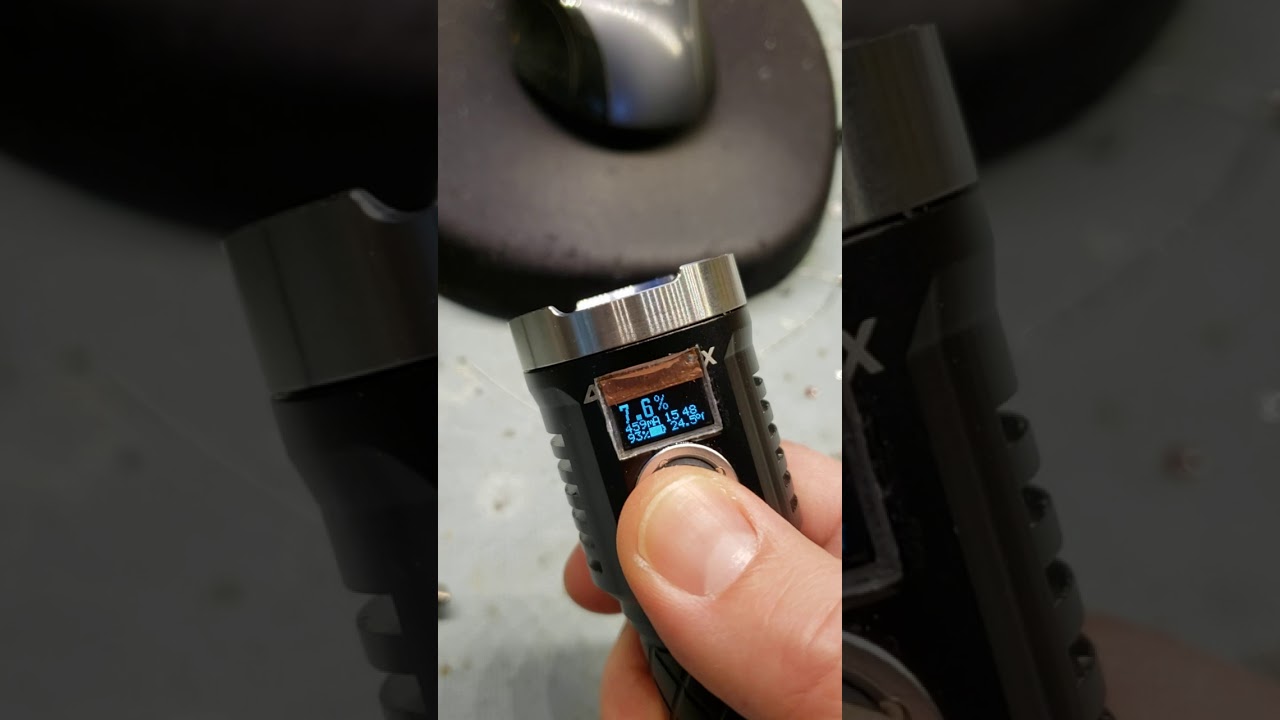

On-board charging is a new feature for my lights of this type:
And here’s a quick demo video of how the display looks in use:
