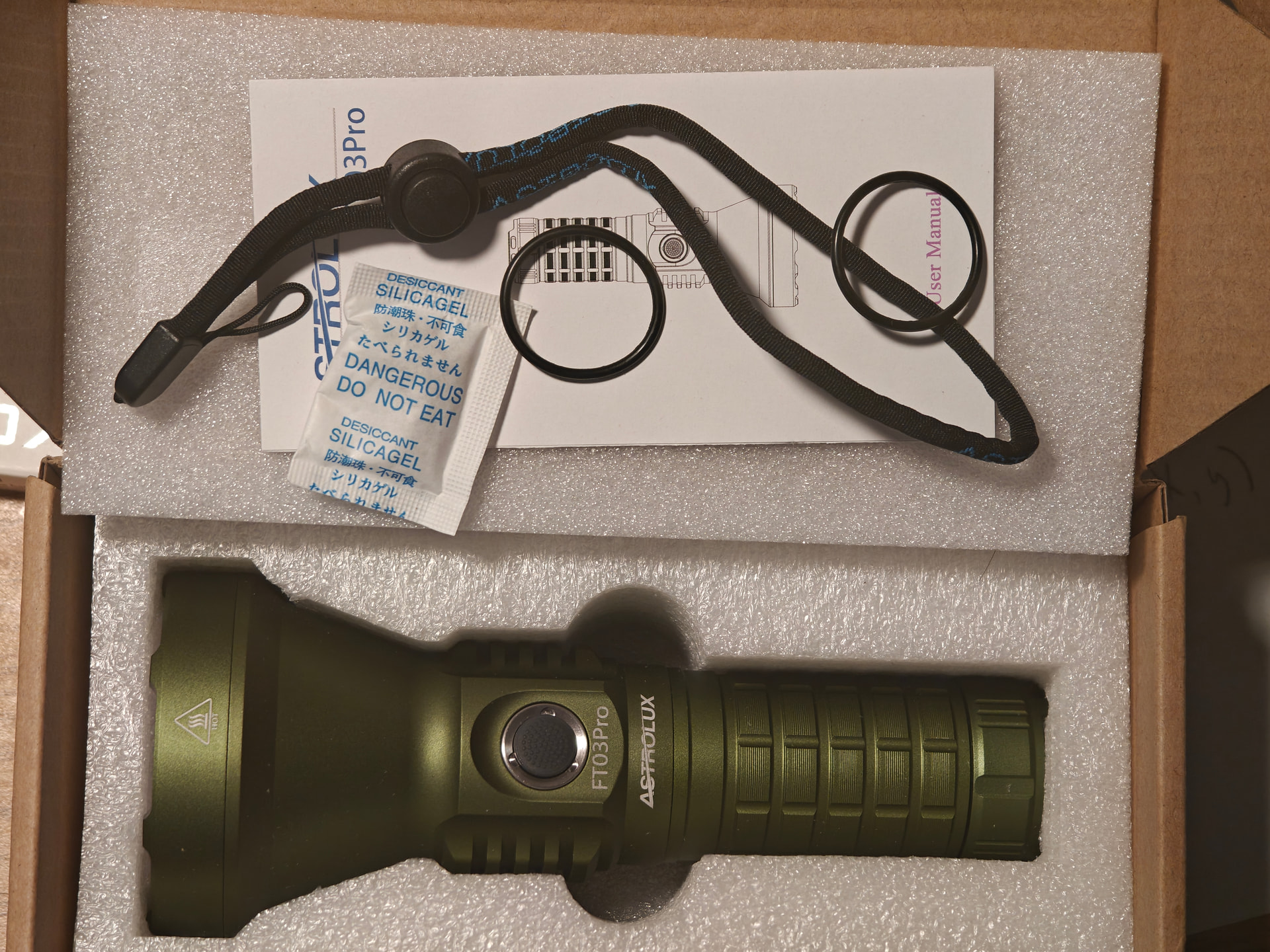

The light comes in a nice box. Aside from the light, also included are a manual, a lanyard and 2 spare O-rings (originally in a bag), and a pack of desiccant. Note the absence of a charging cable, which is a win in my book because almost everyone already has a high-quality cable from a phone or some other device, and therefore no use for an additional, lower-quality cable.
The light is well-built, with a nice green anodizing that is even and has a chalky, stone-like feel, which indicates good thickness.

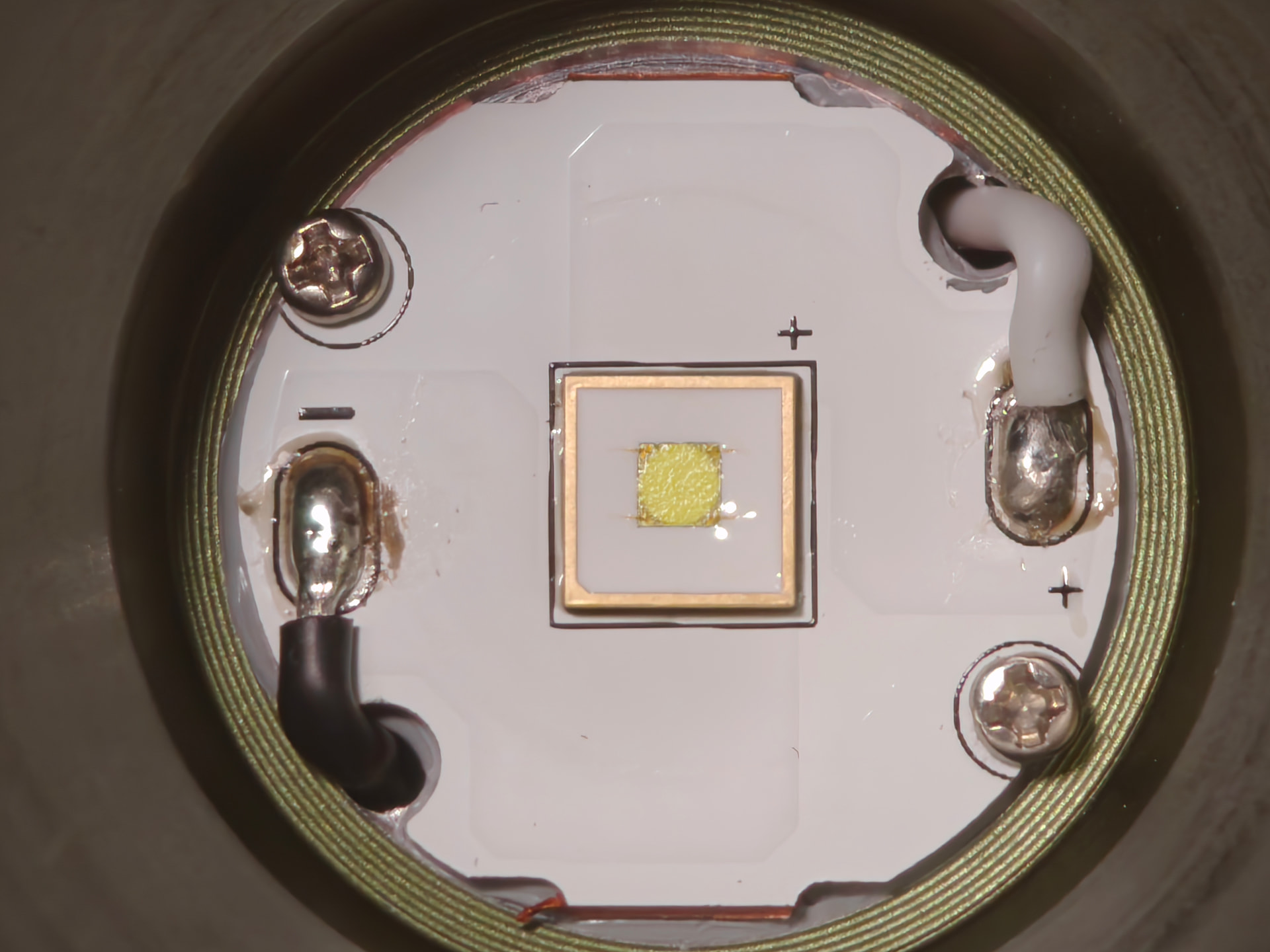

The FT03 Pro features a “HI50” emitter in a large smooth reflector, behind an AR-coated glass. It’s unclear what the emitter really is, but the appearance and performance is very suggestive of the LMP W7070ST1, essentially a 7070 version of the SFT42R. This is a good choice of emitter, having just the right balance between throw and output in a host of this size.

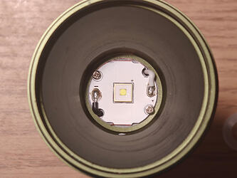

Unfortunately, the emitter itself appears to be from a bad batch, because the circular die is visibly off-center. Interestingly, Astrolux has switched to a larger circular-opening gasket with a lot of tolerance (compared to the sample 1Lumen received), no doubt to address this off-center LED batch. Amazingly, the beam itself was quite well-centered, suggesting that the centering has been tuned before being sent out.
