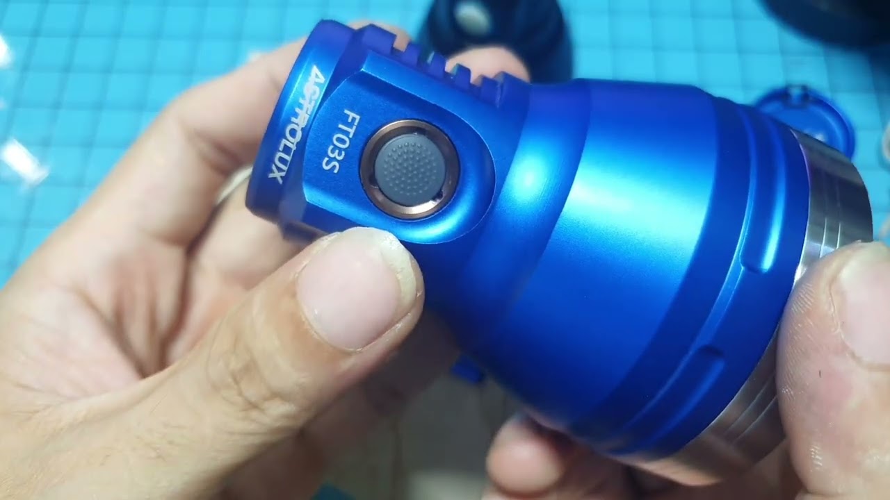

I took the FT03S tailcap off to tackle it, the more I look at those springs the less I like the set up. Both springs seem a bit on the light side given the current an SFH55 can draw. I left them alone for now, doing a bypass isn’t feasible with the dual springs. I feel a single stronger spring, that is bypassed, would be better. I only use 26650 batteries in it as it didn’t come with the 21700 adapter tube.
Finding a decent spring is another matter though…
I decided to just do external bypasses last night on both ends in the FT03S. This is the driver end- if should be fine like that. (Especially as there’s no need to remove the battery to charge it.)
I just retested with the driver’s springs bypassed (as in the previous pic)- I’m getting 25 Amps at the tail cap now!! That’s with a Vapcell P54 26650, a GoLisi S43 26650 is slightly lower - around 22 Amps.

It’s interesting I came across a Youtube video of a person in Vietnam (?) who had two FT03S and modified one - it appears they replaced the spring on the driver (changed to a single spring) and did a bypass. They got virtually the same before and after currents- using some massive battery and wiring it straight to the driver. It’s this video at 3:00 minutes.
