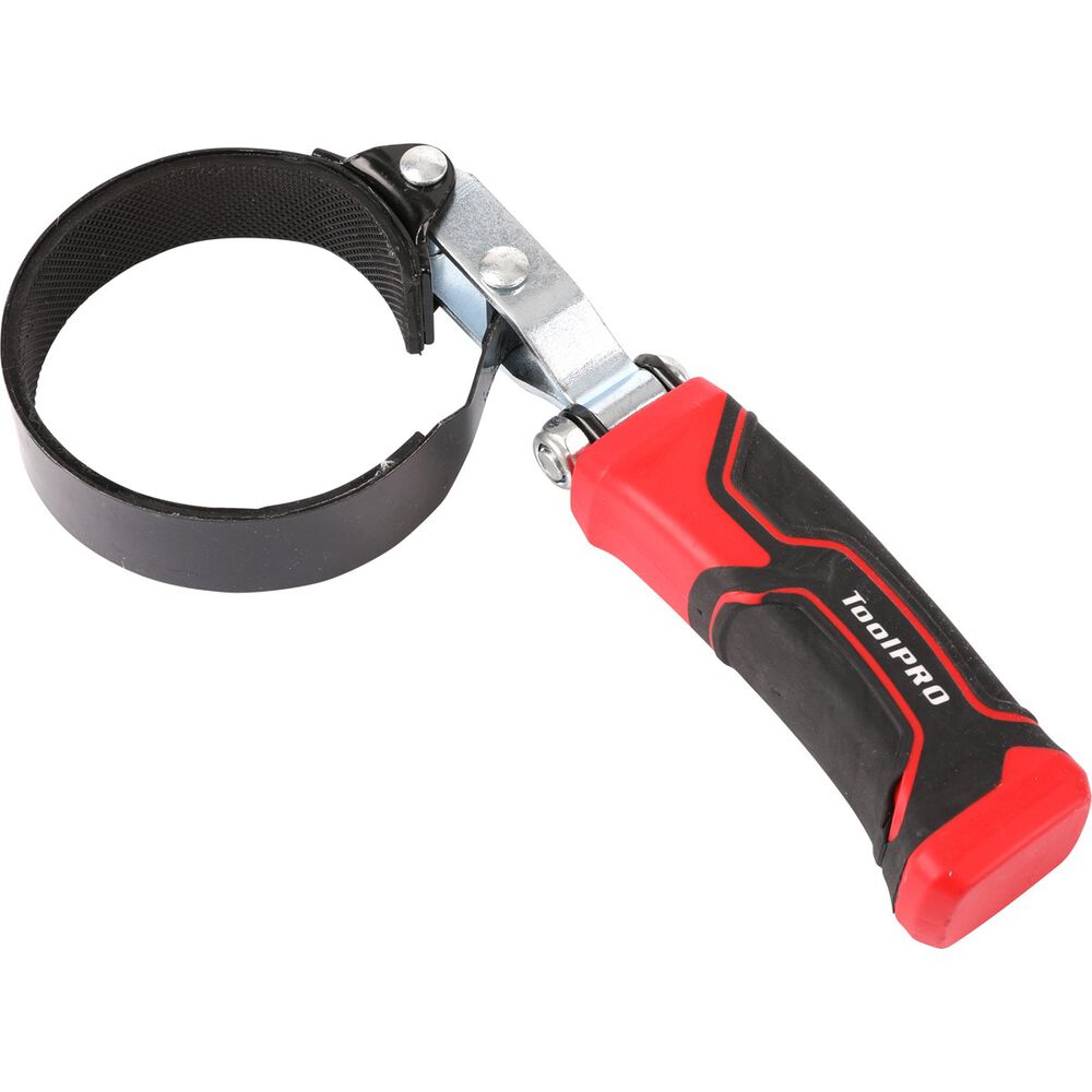

How hard was your light to open? I have a couple of the 2nd gen MF01's and I haven't been able to get the bezels to budge. Thinking about making a wooden jig to hold the bottom of the head and than going to town on the bezel with a large pipe wrench. Probably will scratch/gouge the bezel, but that can be fixed. Any advice you may have would be appreciated.
I used two strap wrenches like this:
Can’t remember if that’s the exact size - but used them to put force on opening. Eventually felt it slip and then away I went. Took some time afterwards to clean the threadlocker from the threads with isopropyl alcohol and some fine tweezers.
Hmmm, sounds promising. I tried several different strap wrenches, but not an oil filter wrench. Thanks oweban :)
No worries! I still had to put a decent amount of force into it, but it worked well.
