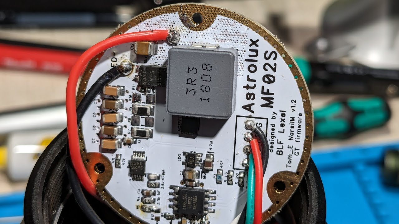

I bought a 7A anduri driver from Lexel for mine. Felt like an entirely new light
Astrolux MF04S battery carrier takes four 18650 cells in a 2S2P configuration (8.4V).
Lexel MF02S 12V up to 8A driver needs the battery carrier to be modified into a 4S configuration (16.8V step down to 12V).
To do:
- Figure out how to remove the old driver (remove torx screws, driver falls out? desolder wires)
- Figure out the wiring from the MF04S MCPCB/switch to the Lexel MF02S driver:
- Figure out what traces to cut and what to bridge on battery carrier to convert from 2S2P to 4S:

Here’s a video demonstrating the Astrolux MF04S with a Lexel driver:
The Lexel MF02S driver came with Anduril installed. 15 clicks gets the light to blink out 20191203. That is the date that the hex file was compiled. This might indicate that it is Anduril 1 rev 460 but it could be an earlier version that was later compiled on 20191203 by Lexel.
I’ll post a photo tutorial for modifying the battery carrier and swapping the driver, along with some measurements of lumen output and beam distance.
