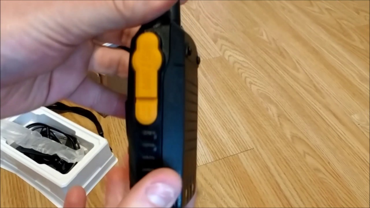

The radio main body - and the battery separately wrapped.
A belt clip with no screws – the screws are already on the back of the radio to save you losing them.
An antenna – this is smaller than the ones I’ve got for my UV-5R
An earpiece microphone
A power brick – 10v @ 0.5A. This radio will work being plugged into a 12v charger and with the chargers for the UV-5R. I received a EU plug on my adaptor so being lazy I just dropped the radio into the UV-5R dock and charged it up.
The most important item that is included in all items these days……A lanyard
I quickly unpackaged the radio and put it all together. In the rush I wasn’t quite accurate enough with putting the battery on the radio so I thought the battery was discharged when I received it. The battery is the same voltage and same capacity as the one that comes with the UV-5R (7.4v and 1800mah) but the battery is rather different. This one is physically larger and looks like it is made bigger to make the radio better to hold in the hand. Whilst the UV-5R has a button to release the battery on the top this UV-6R has a button on the bottom to release the battery. I wedged the battery in and didn’t follow the slots so on the video I made the radio wouldn’t fire up at first!.
