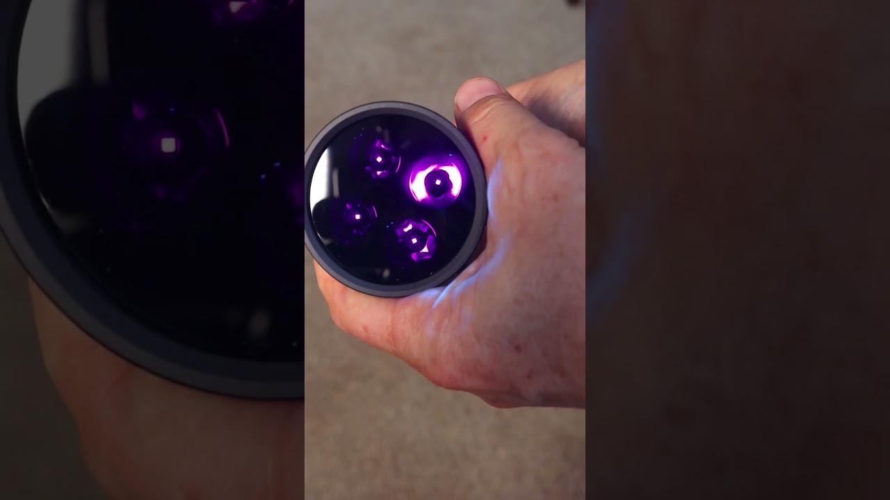

This is something I’ve been working on for quite a while. It’s not ready to sell yet, but I thought I would share some of the details on how the project is going. This won’t be a cheap light, I want to be up front about that. There are already a ton of cheap UV lights available, I just wanted to make one that is the very best possible with available tech. IE high power, reliable, sustainable, with good range.
I took a Convoy L21B host and with the help of BLF member Hoop, designed a space maximized heat sink to fit in the head.
The LEDs were made to my specification for the project (more on that later). In total there’s over 20 watts of power.
What got me thinking about this build was primarily fluorescent mineral hunting. So I ranged optimized the light as best I could. Even though it has 4x LEDs, its made to be a thrower. Hence the flat glass emitters and SMO reflectors.
Were also going to include a ZWB2 Band pass filter to minimize any discoloration of the target.

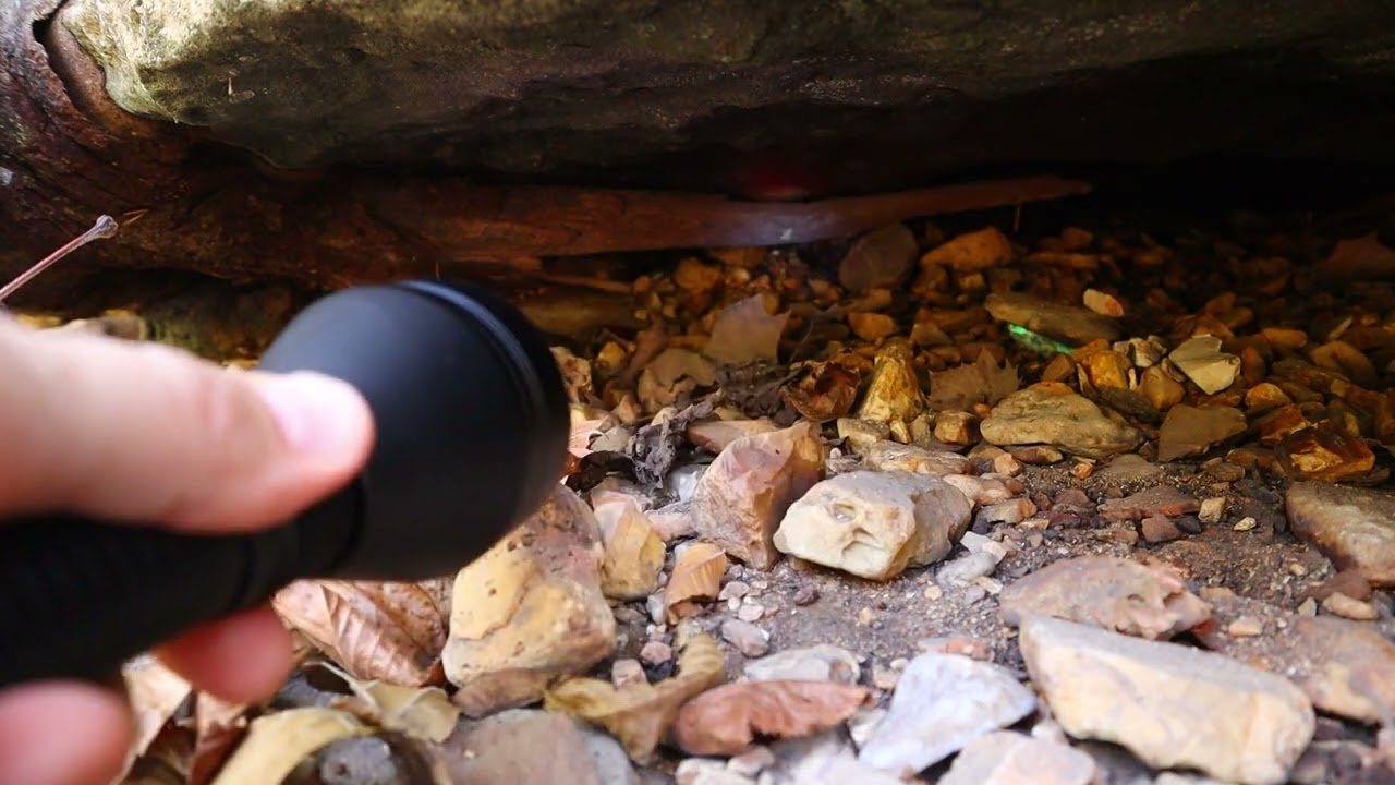

-The small stone is a piece of Chalcedony that I stuck in with some other rocks to show an example of how brilliantly it fluoresces compared to it surroundings.
-The stone on the ceiling is fluorescing I think because it’s covered in some type of fungi.

Very interesting! How’s the thermal performance? Is it a buck/boost type driver to avoid voltage sag? If this sink is compatible with the L21B it should work for the L2 as well which could offer a little better heat shedding by way of increased thermal mass in the battery and also allowing for use of a strictly buck configuration… Are those S2+ or S6 reflectors in there or something else?
Also emitters are in parallel?
I know you had the flat glass 365’s made, but this could possibly support the SBT-10x-UV that Simon has. Those things throw like crazy. Maybe a blend of emitters would be a good thing to try as to balance flood and throw.

The heat sink plus the light body and DTP copper mcpcb are enough that I can run the light wide open for 8 minutes 50 seconds before thermal protection kicks in. With the sensor set to 200F. At that point the light is pretty toasty, but I can still hold it. The driver is a boost circuit that holds regulation very well. It’s not a buck/boost though. Thanks for mentioning the fitment of L2, I didn’t know that. Yes the reflectors are S2+.
The emitters are 2S2P. The LEDs I’m using are very similar to the SBT-10X-UV, during the prototyping phase I used a set of those to develop a sort of road map on where I wanted to be with the light.
If interest is enough I will consider variants of the light including short wave or 395 etc. I’m pretty new to mineral hunting so I’ve not toyed with SW yet. I’ve made a lot of UV flashlights for other applications that did use multiple wavelengths though. For years I manufactured a light used in the automotive industry for curing primer and clear coat. It was 365/395 light that would cure primer, clear, body filler with the photo initiators in them in about 60 seconds so that it was hard enough to sand.

Ah, I didn’t see that they were quads…! Nice. What driver is in there? It’s hard to find a driver that can deliver the right dynamic voltage window for those. Also, those 2S2P’s can typically take 12+W each, so you’ve got almost 50W input at your disposal here. I bet that’s a phat beam IRL. Nice concept and execution! I wonder how a SBT based model would do with the more focused hotspot that those deliver.
For SW in this format I’d recommend using 4x3535’s vs 4x5050 quads since the power consumption of the SW 5050’s is enormous and just one would overheat that light, let alone four.
@Lumencraft-Matt Oh and if you’re open to selling or trading stuff for 2-3 sinks and PCB’s to me I’d like to tinker. :upside_down_face:
I had RMM make the boost driver. I buy batches that are large enough he’s willing to make them. I tested several of the convoy drivers, but even with some modifications to the hardware they didn’t preform to the standard I needed.
