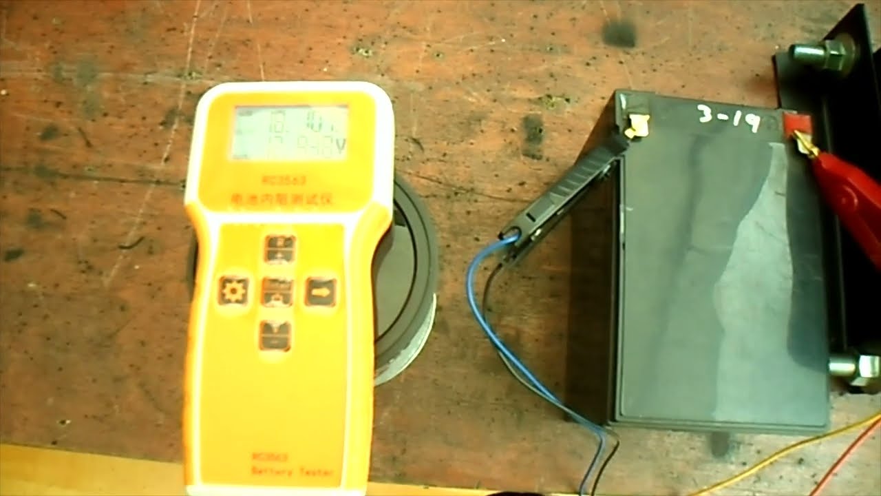

Here is a discussion/review of the 3563:
Sounds reasonable. I may just try one.
Another test:
It shows more variability than I like, but repeated tests after the initial ones are close enough.
