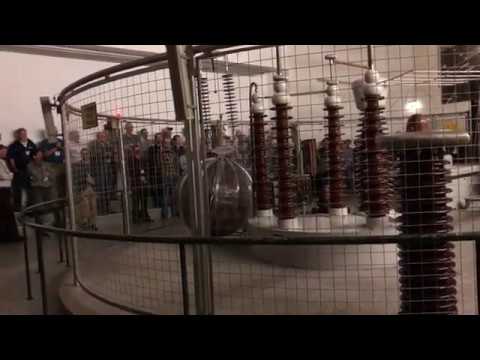

That’s not a spark -
This is a spark!
Amazing that he still can see considering the lack of safety glasses… ![]()

I’ve seen this demo in person. They set off an arc at the beginning of the show using the glass panel in the foreground that is very loud.
The museum is worth a visit any science and technical nerd who finds themselves in Munich. Very old school, though.
Don’t forget to go through the mining exhibit in the basement, which is done up like a mine.
