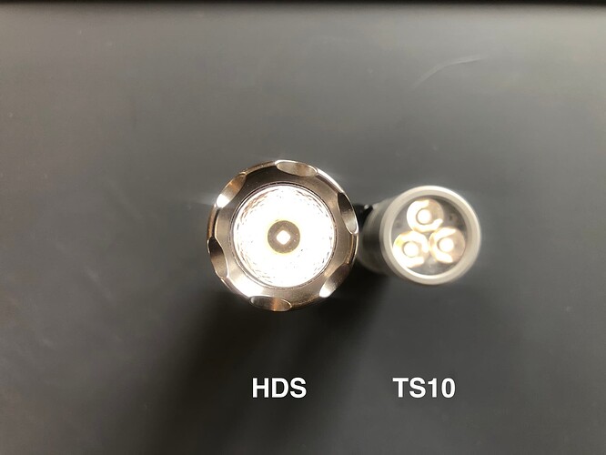

Beam comparison, HDS and TS10
both lights at 20 lumens

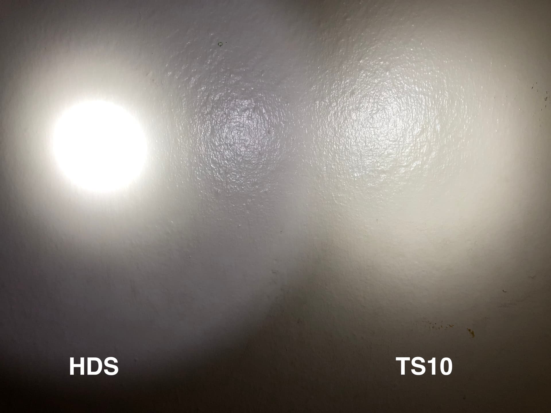

Beam shapes:
some pros and cons:

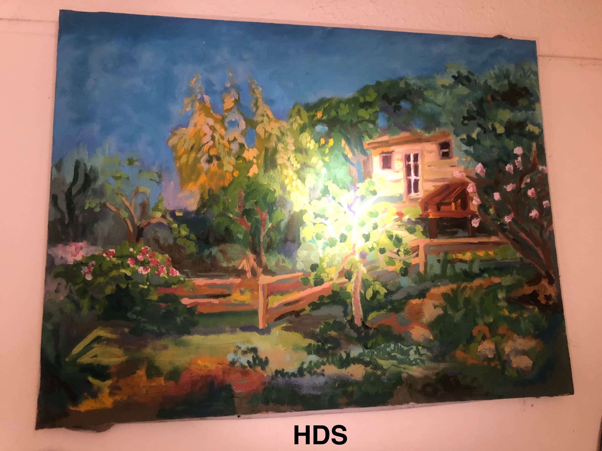

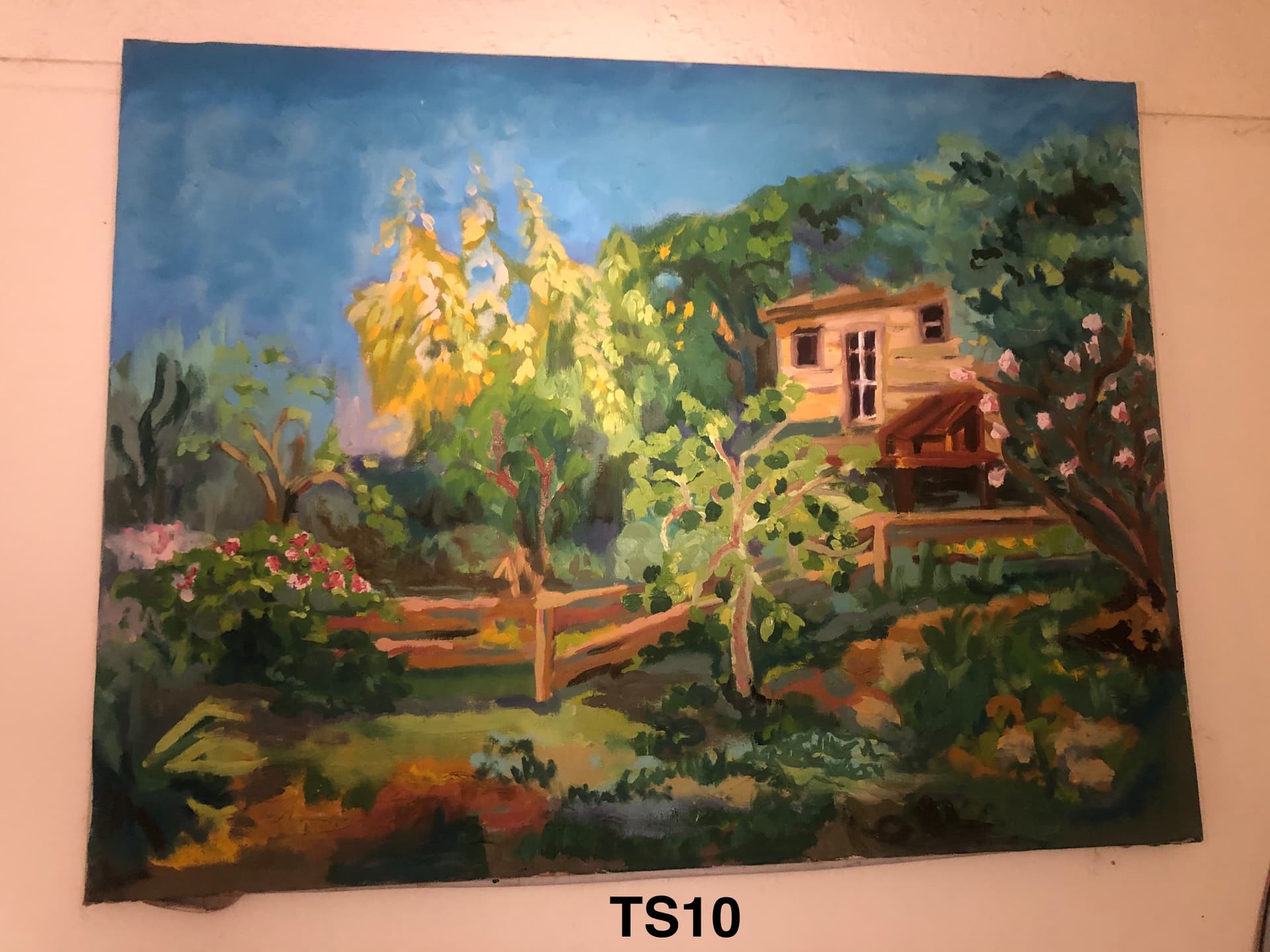

the single LED in a reflector of the HDS, produces a narrow throwy beam of 15 candela per lumen within the defined hotspot, lots of glare if looking at a painting, but brighter within a smaller target
the triple LEDs in a Tir of the TS10, produces a wide floody beam with 2 candela per lumen spread more evenly across the beam, no defined hotspot, no glare if looking at a painting, but not as bright on center of target, as a reflector

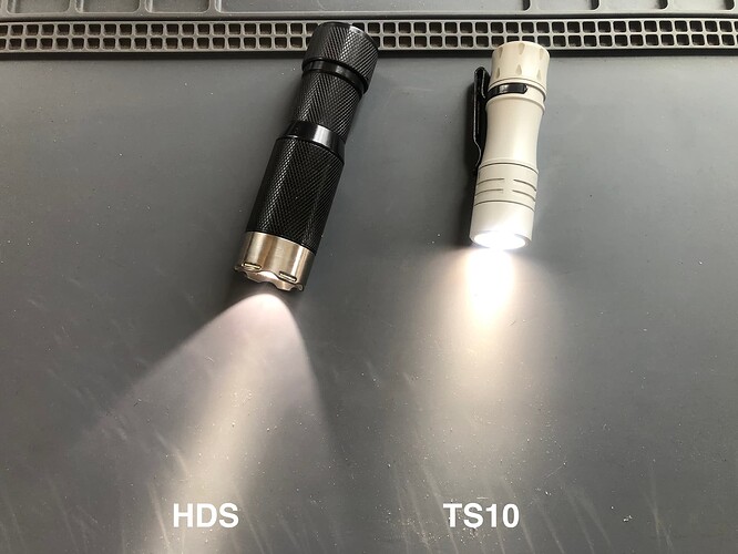

low modes:
