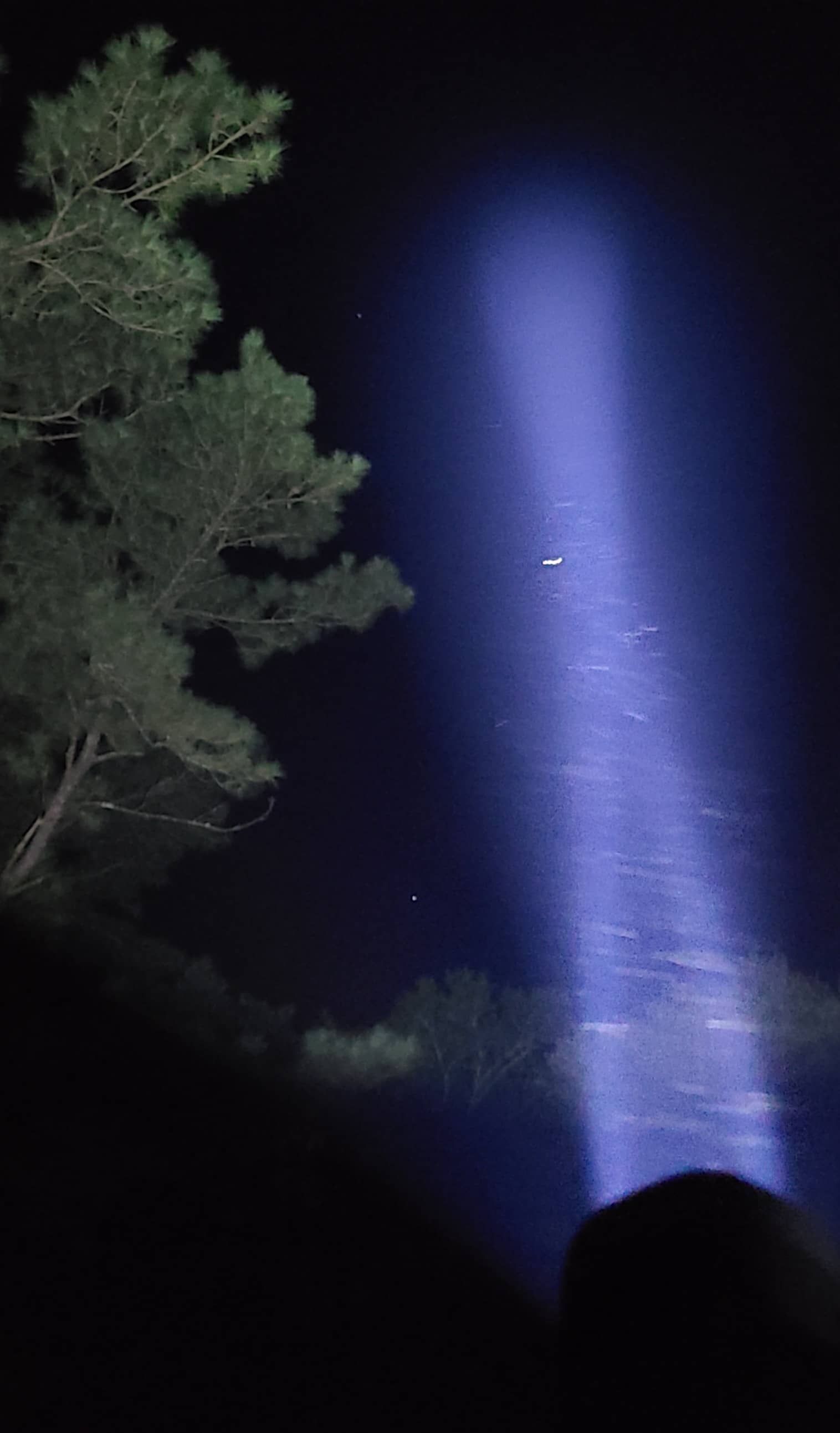

I have a Convoy C-8 with a SFT-40 and 8 amp driver.. awesome setup.. has a perfectly round sharp hotspot and enough light out to the sides.. but it opens up at range.. definitely can see the focal point at night with the dew in the air..
Keeping with this power level, will another led give a more straight forward beam or is it the depth of the reflector that needs to change ? If so what light would be best for this..

I put 2 layers under it, compressed it good and let off. It definitely made a change in the right direction and i can remove 1 layer and see how it does..

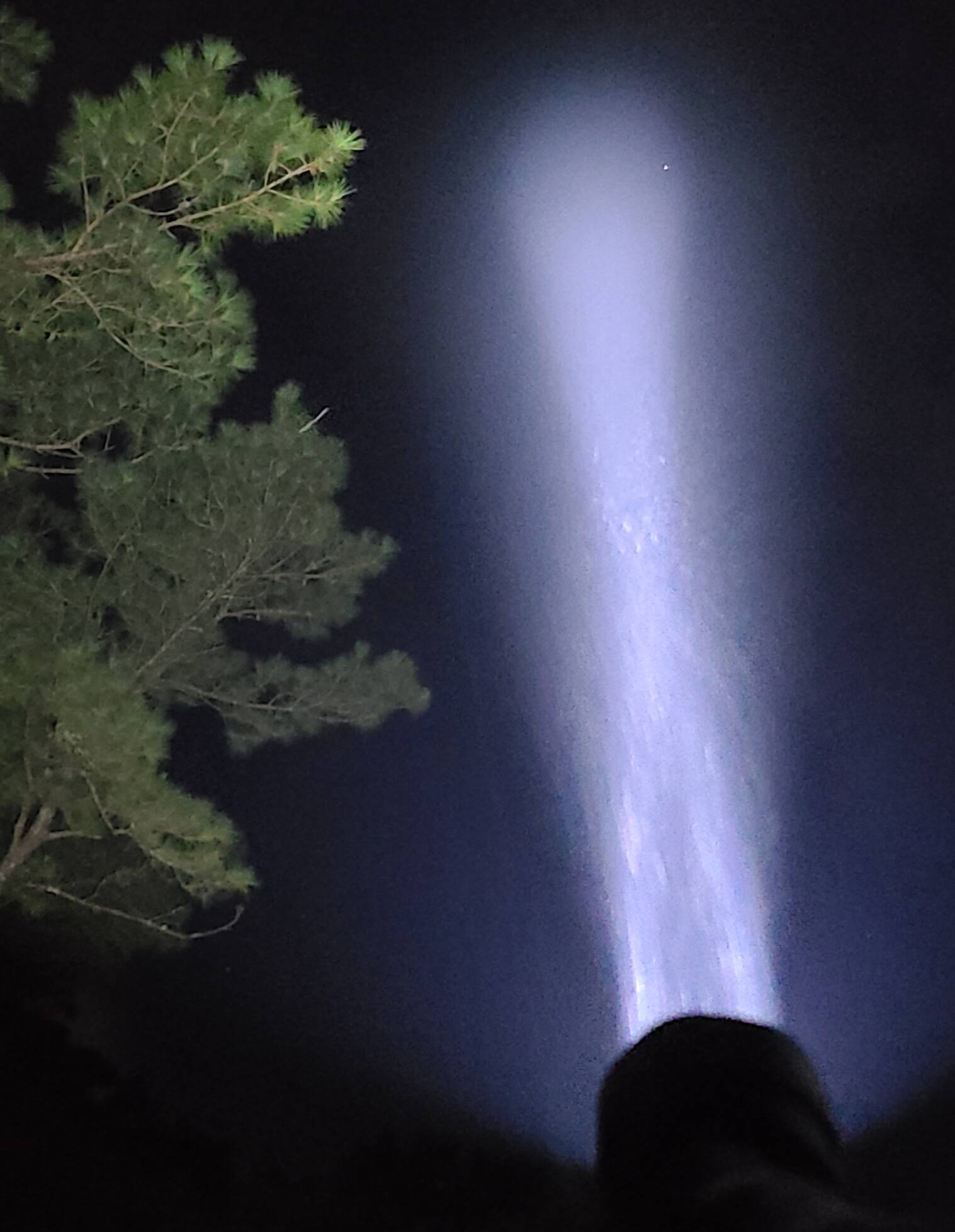

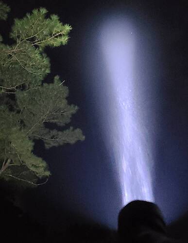

A comparison between the C8 with the SFT-40 and then the Cyclops with the SFT-25r…
It did change it, but not enough to amount to anything.. ill just look at a different host to work with.. looking at the Convoy L21A.. that with a SFT-60 and 15 amp driver should do a better job, it is bigger than id like but it would also handle alot more heat..

Based on the level of divergence in the beamshots, you probably will need at least 5 layers of masking tape to fix it. Unfortunately, different batches of Convoy C8 reflectors come with subtly different heights; some of them deviate enough to require serious re-focusing.
I’ve received 2 supposedly identical reflectors in the same anti-static pack that had noticeably different dimensions, with one being more than half a mm shorter.

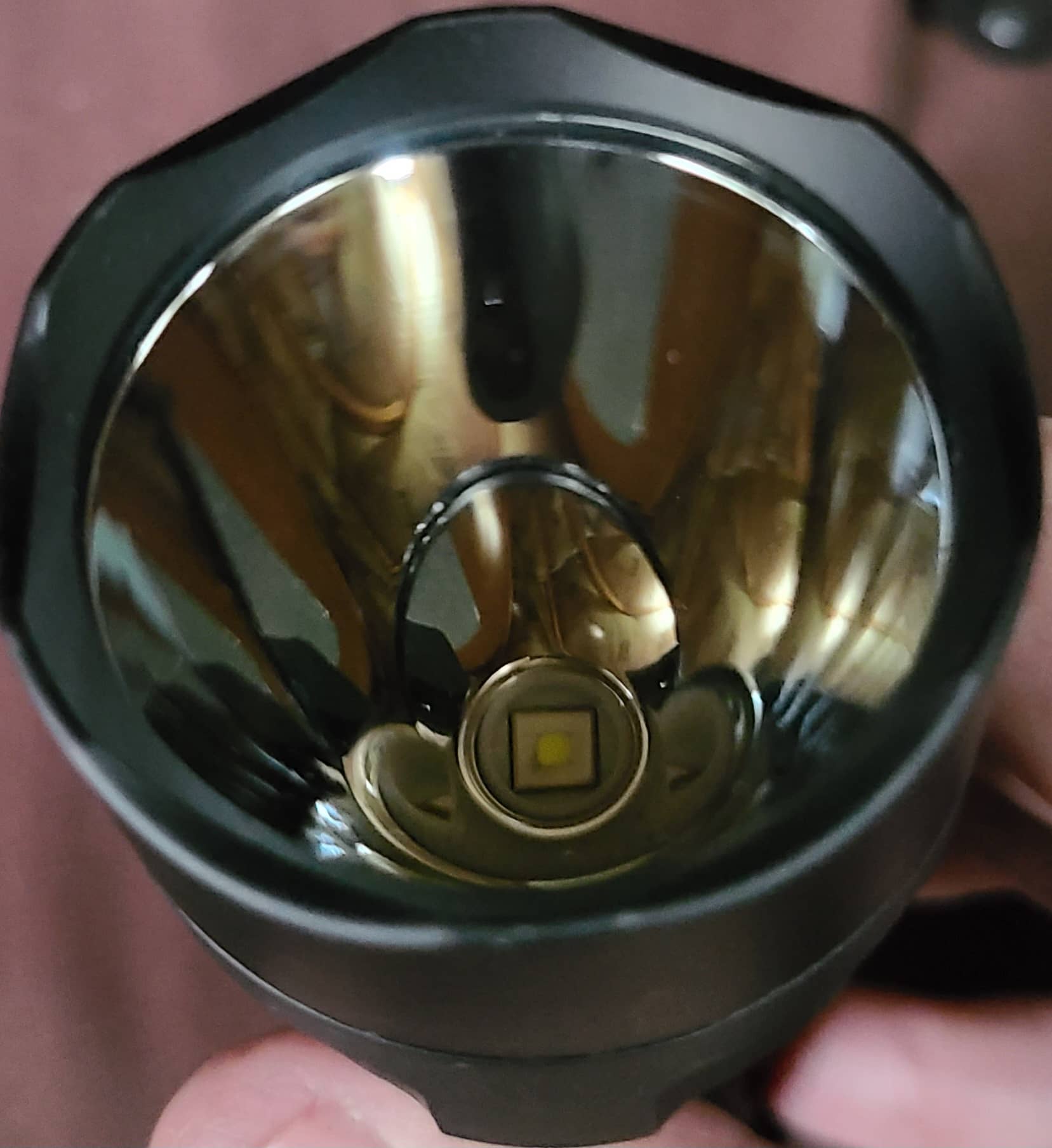

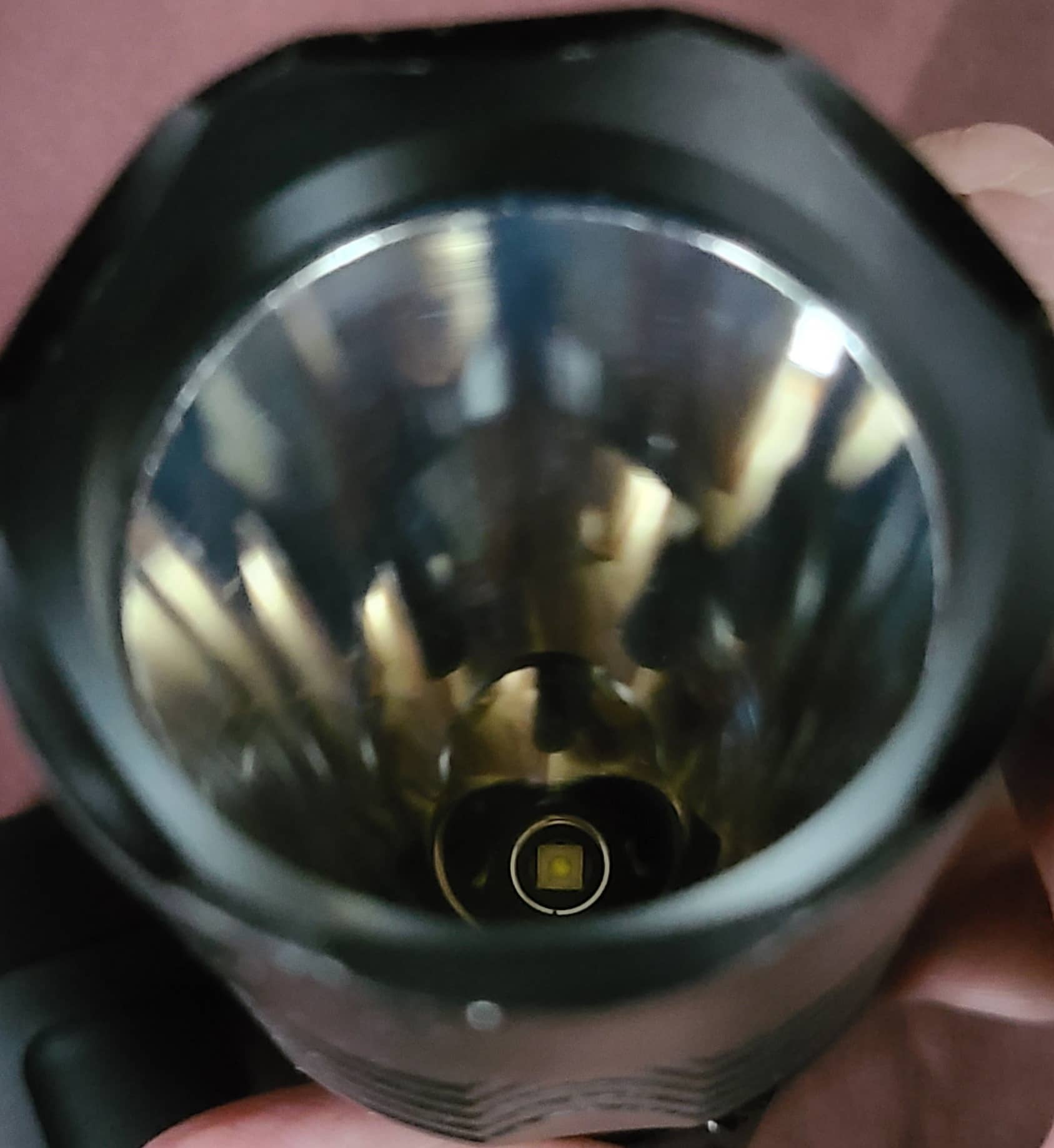

I know they got it spot on with my Cyclops hunting light.. that thing is all but a laser beam hahaha. It just needed a bit more punch..
This can explain why some smallish lights have a weird-looking reflector and beams with an unusually sharp hotspot boundary, which is not possible for a parabolic reflector!
That looks like a very well-formed reflector. Do you have more details or a specifications page on the light?
