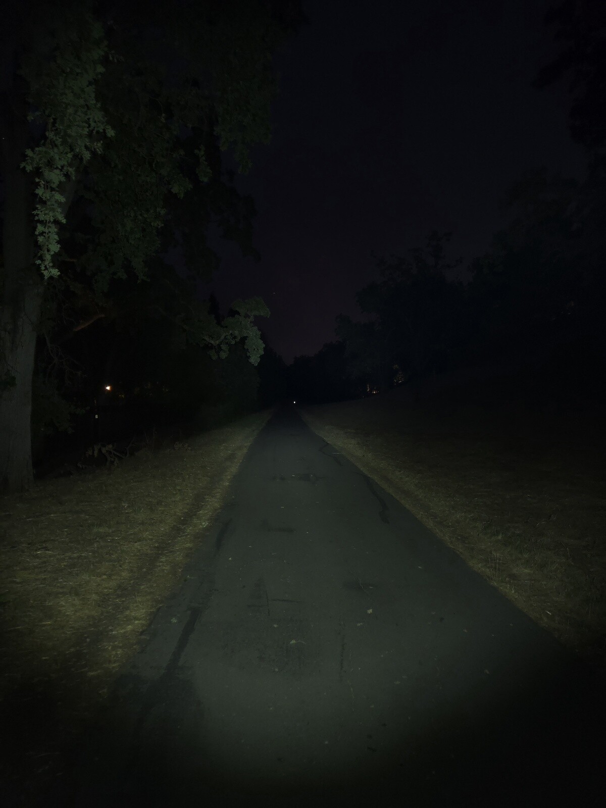

I have a litany of builds and purchased lights I need to take beamshots of.
I’m going to start with a few I did tonight.

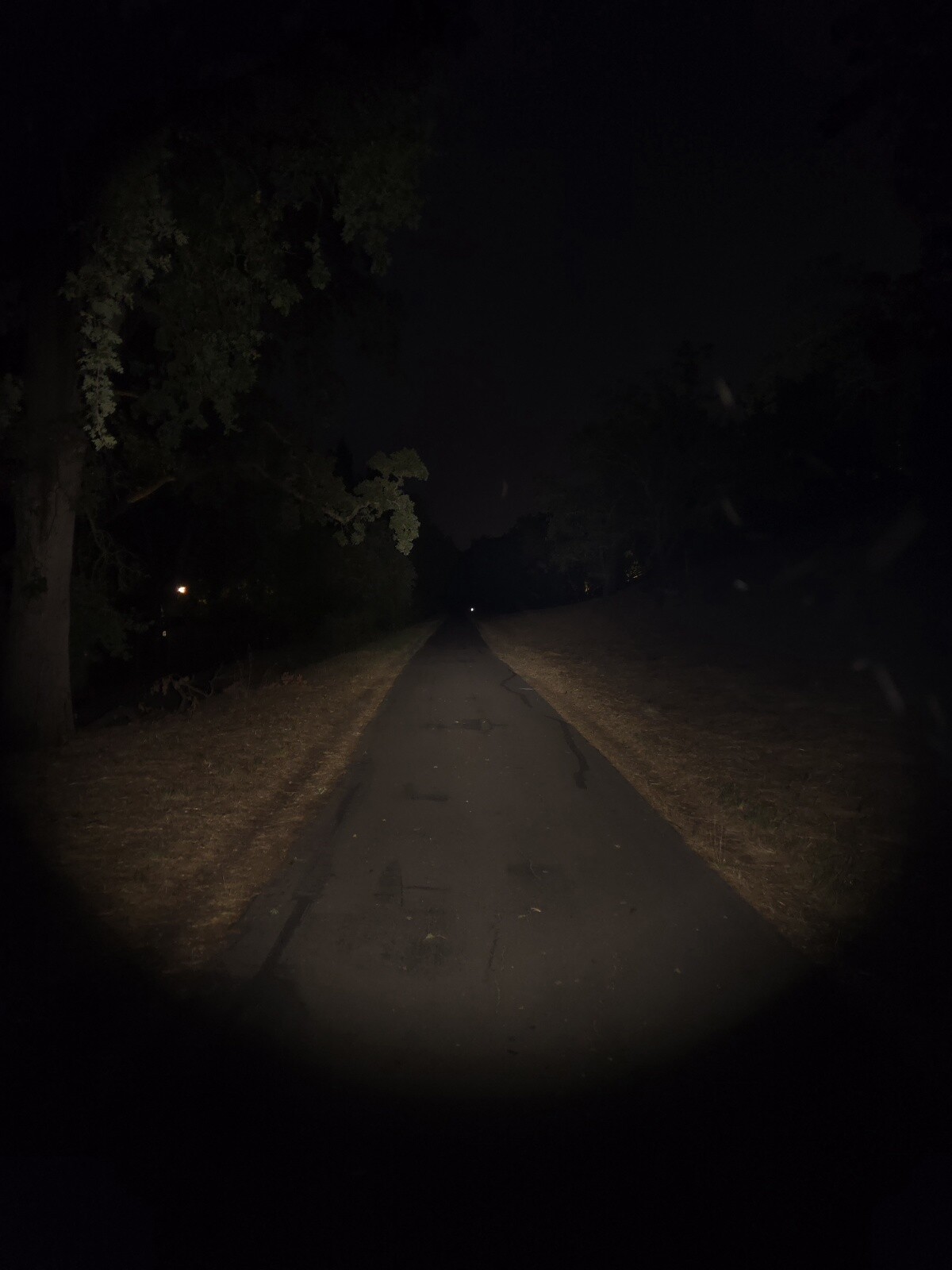

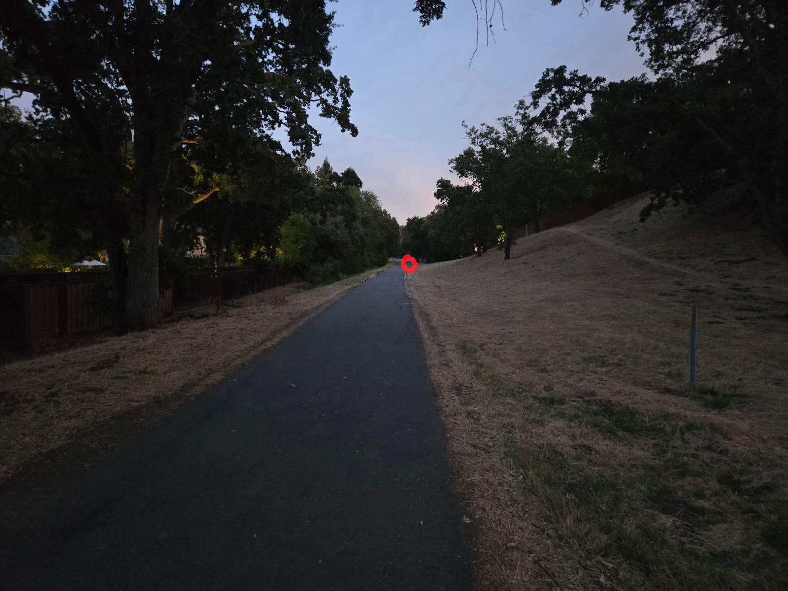

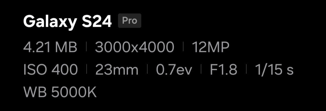

Testing grounds.
Circled in red is a reflective marker that is 240 yards away.
All photos are locked to the same settings.

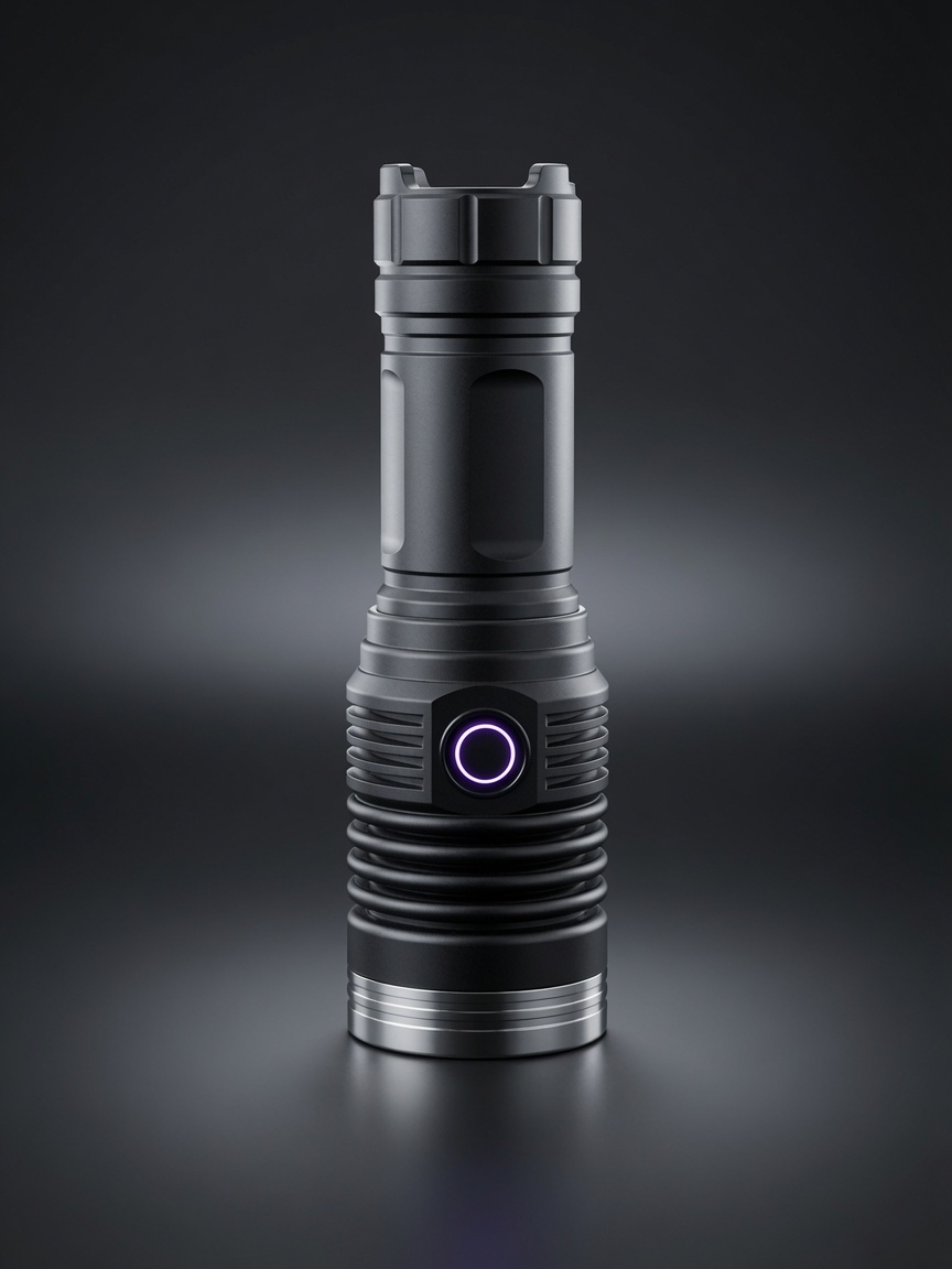

Lets start with the
Noctigon KR1K
NTG50 4200k
Factory Driver and Spot Optic
120/150
Turbo

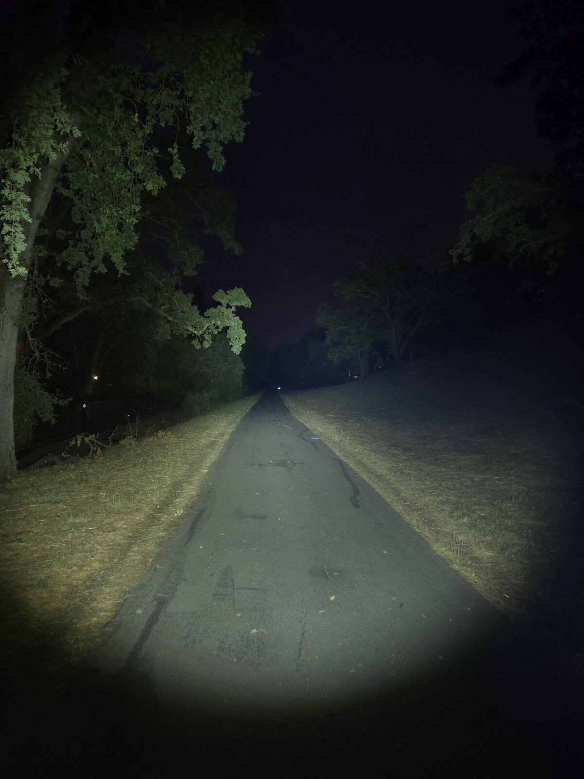

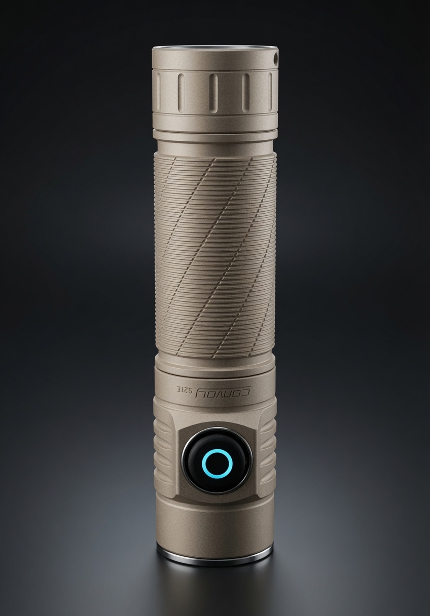

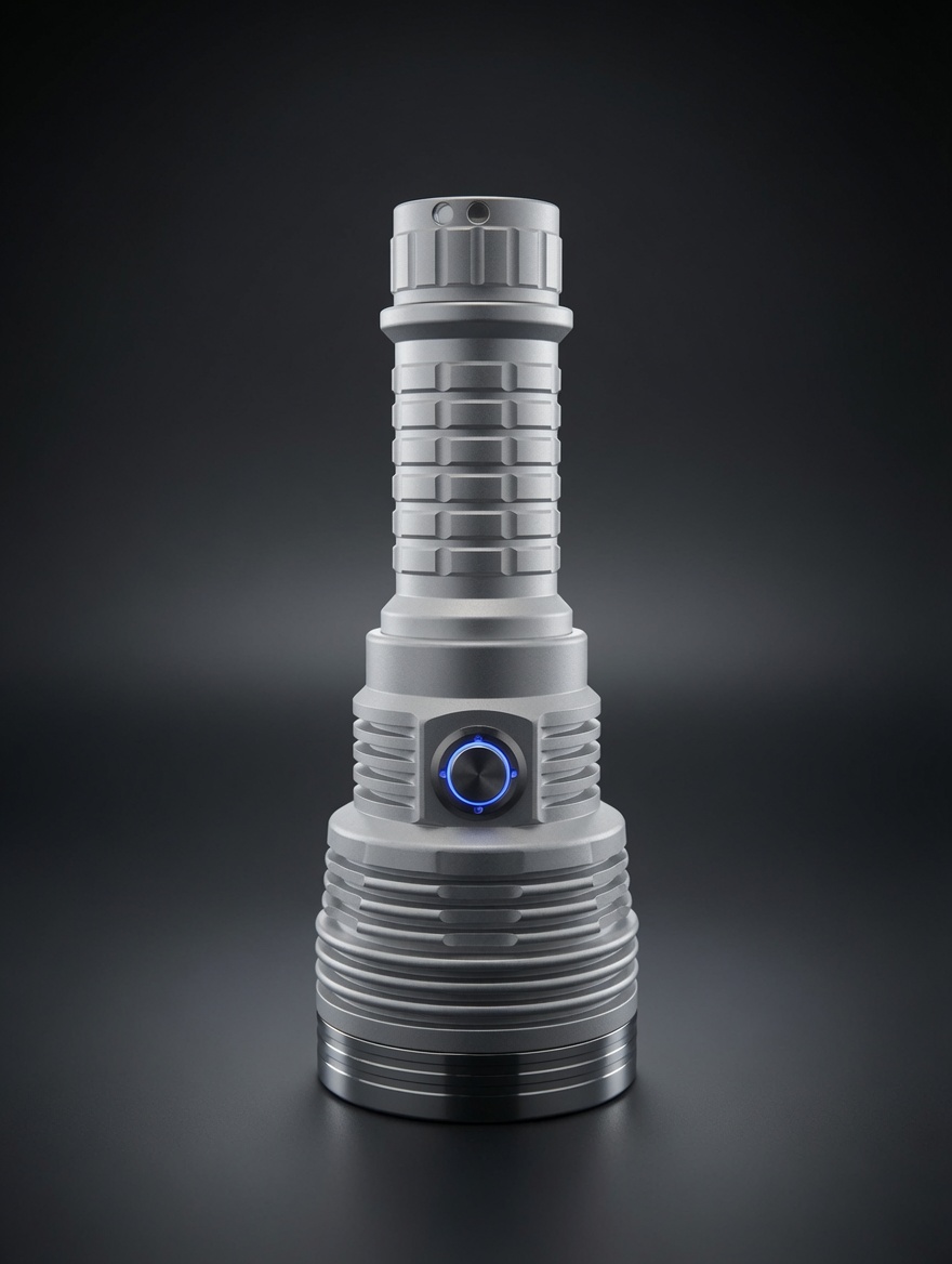

S21E Mao Grey
LHP531 4000k
21mm 15* beaded TIR
INML 20mm Fet+1
120/150
Turbo

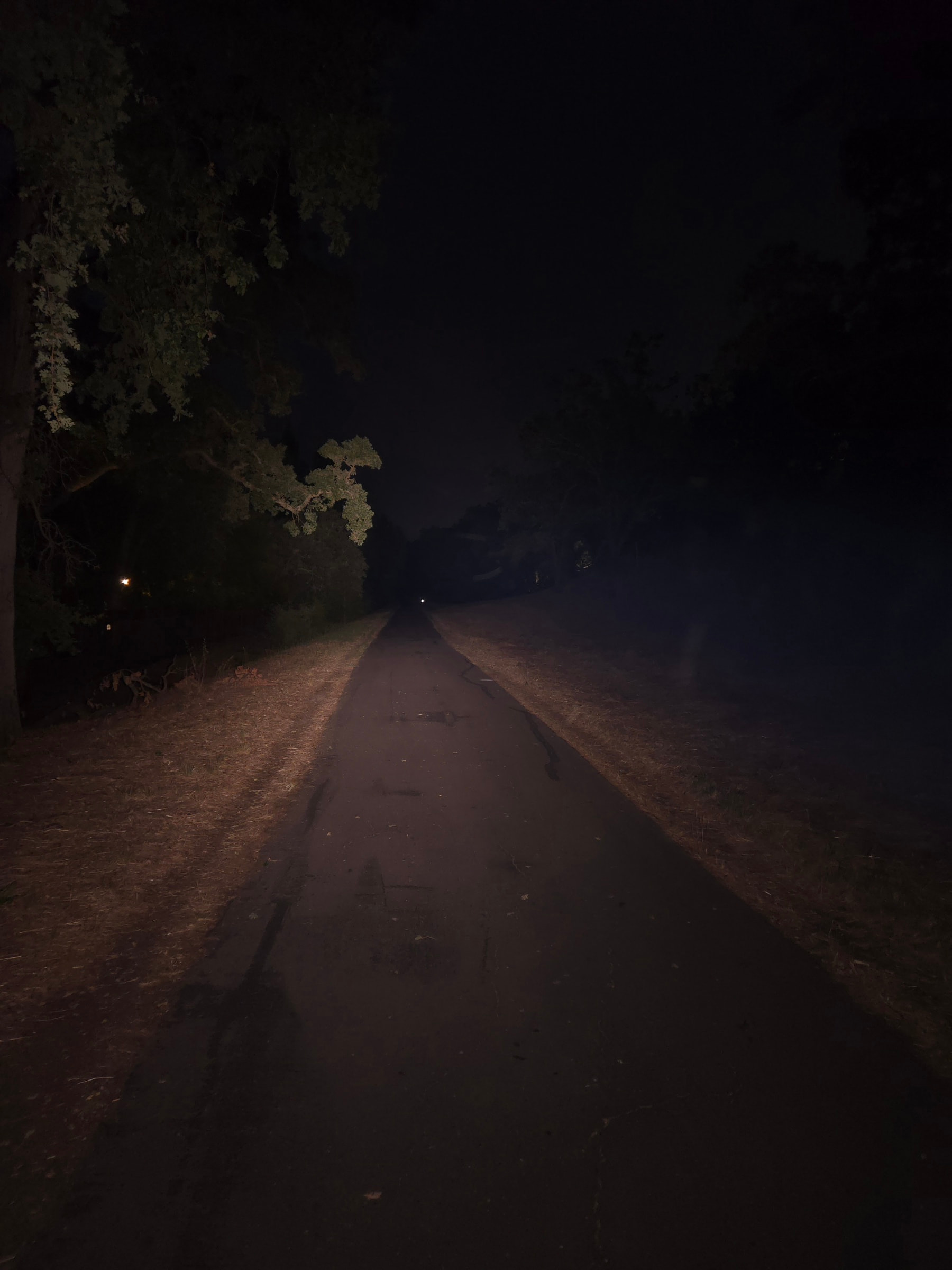

DDH M0BC
519a Quad 5000k dedomed
INML 22mm Fet+1
Carclo 10621 modded to fit bezel
120/150
Turbo

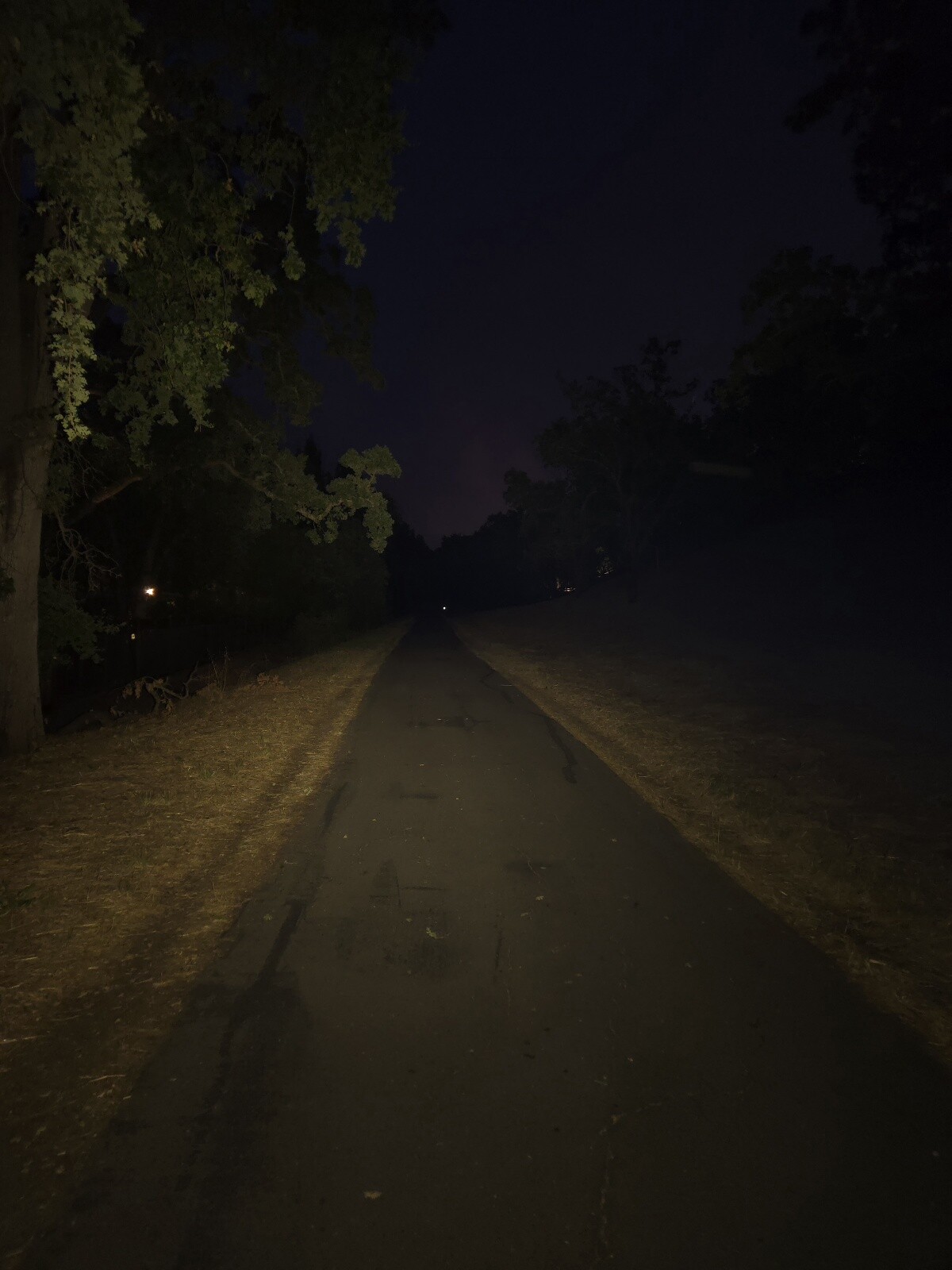

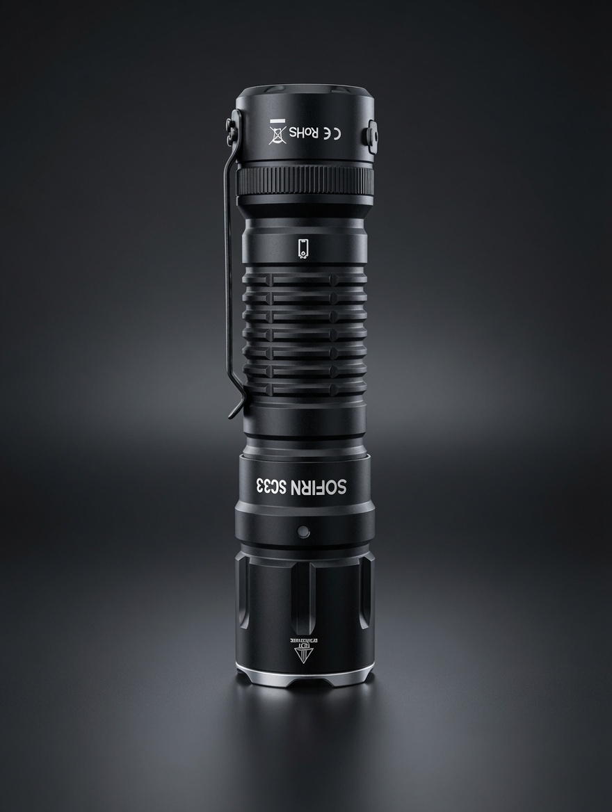

Sofirn SC33
XHP70.3 HI 6000-6500k
Factory Driver and OP Reflector
High
Turbo
Next.

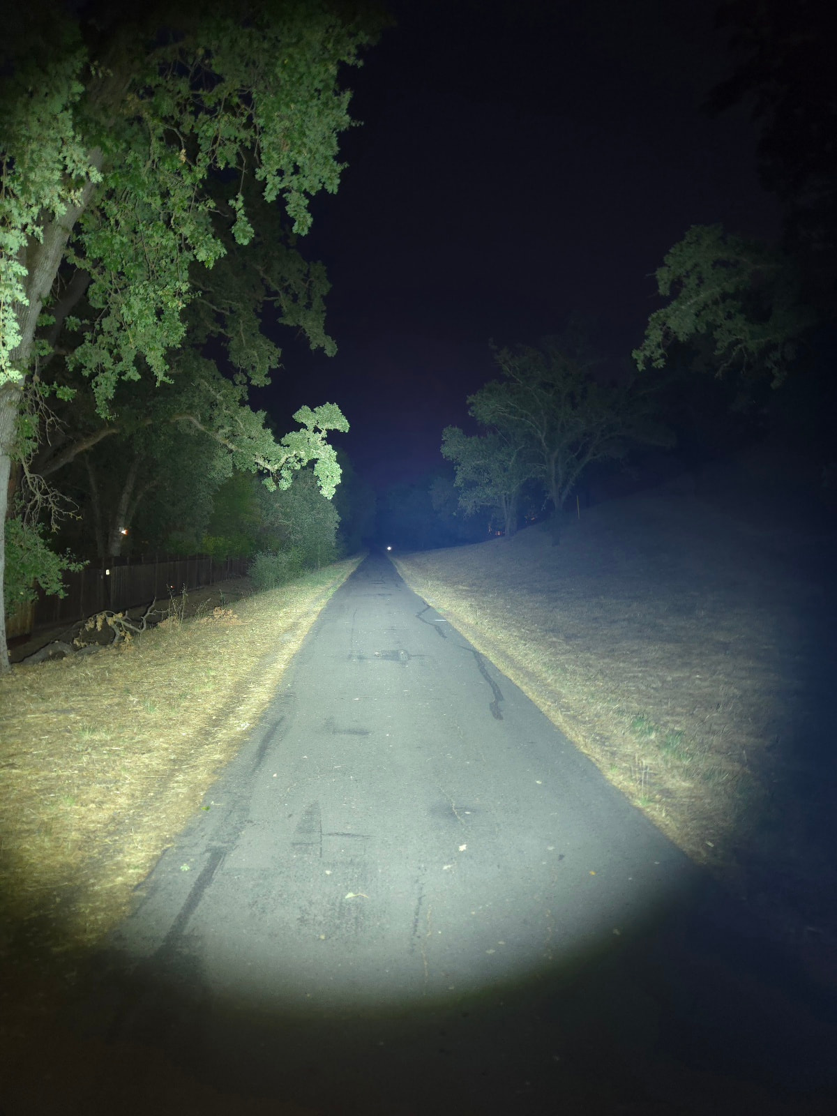

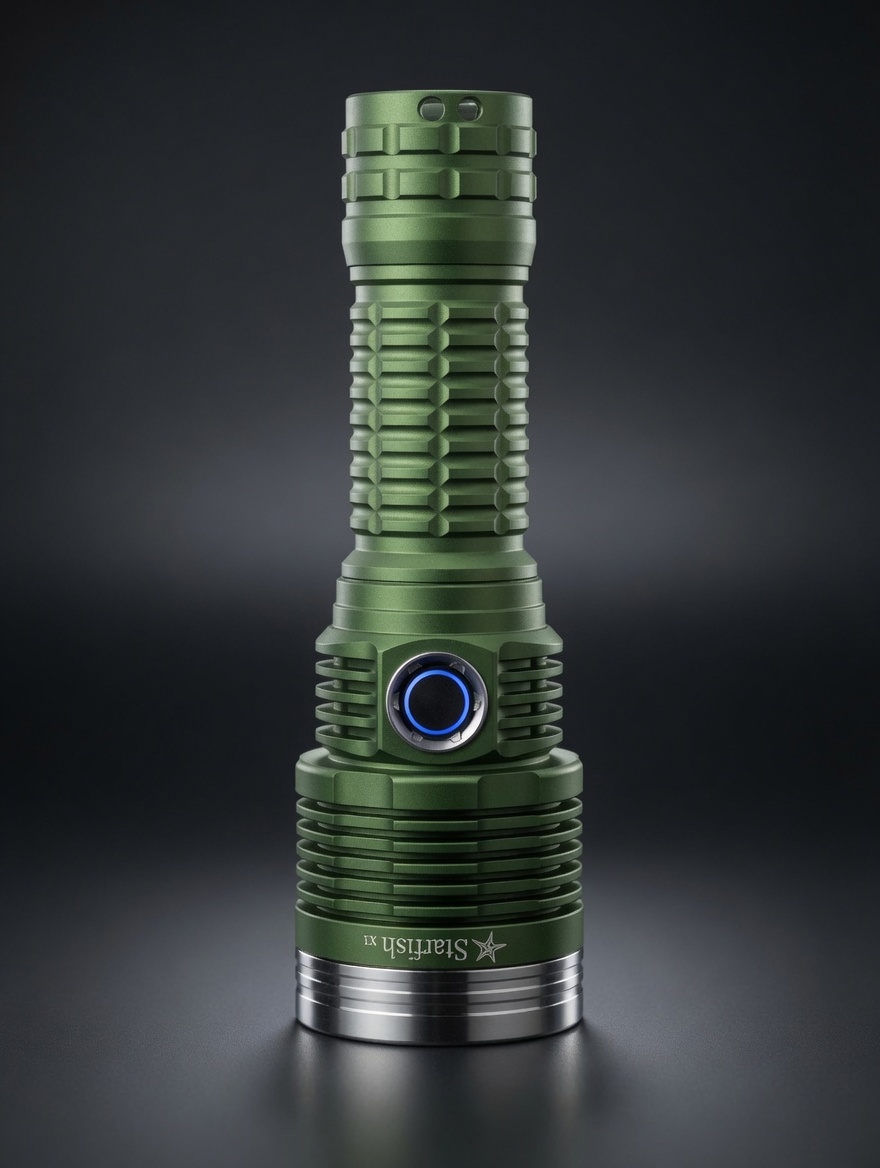

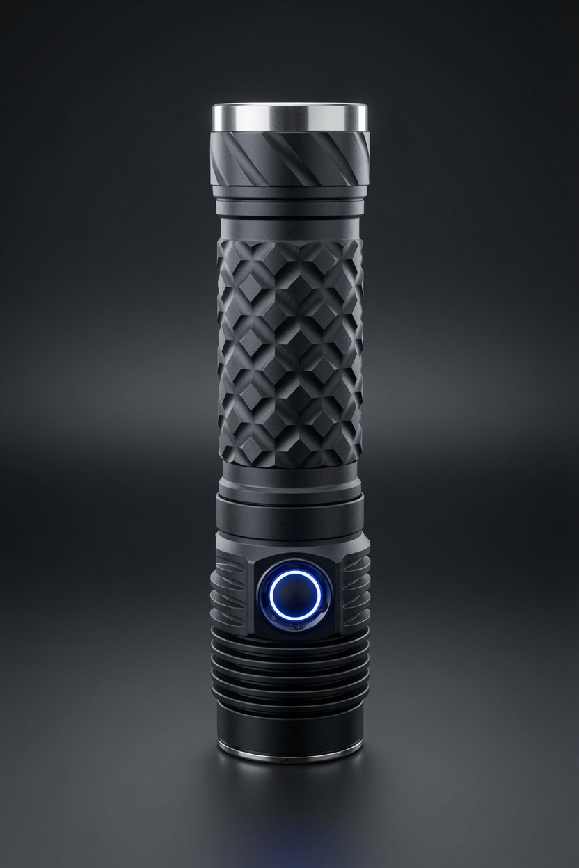

Starfish X3
Daydream 7070 4500k
INML 25mm Fet+1
OP Reflector
120/150
Turbo (dust in the air)
Next.

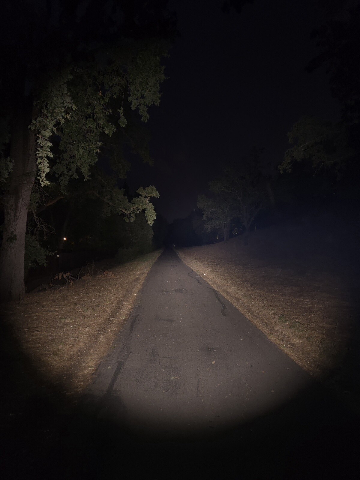

DDH D2GC
LHP531 4000k
INML 22mm Fet+1
OP Reflector
120/150
Turbo

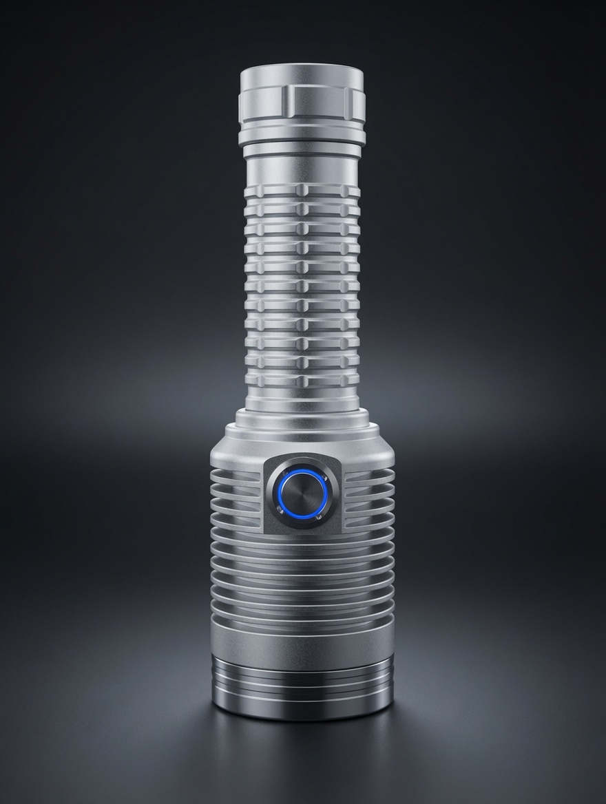

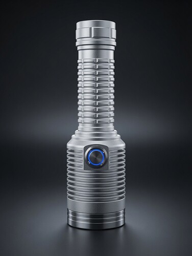

DDH M4C
SFP55 5500k
INML 32mm Fet+1
OP Reflector
120/150
Turbo

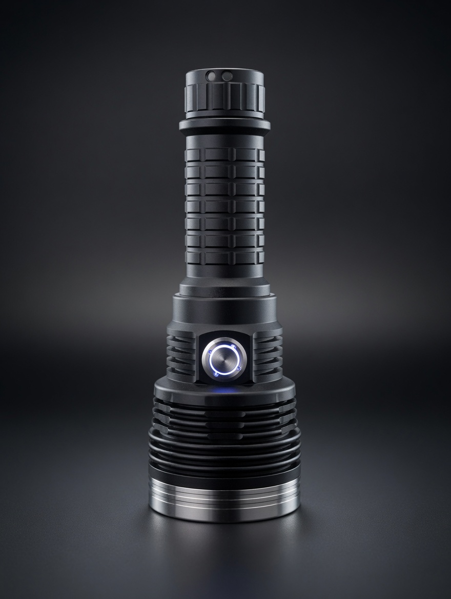

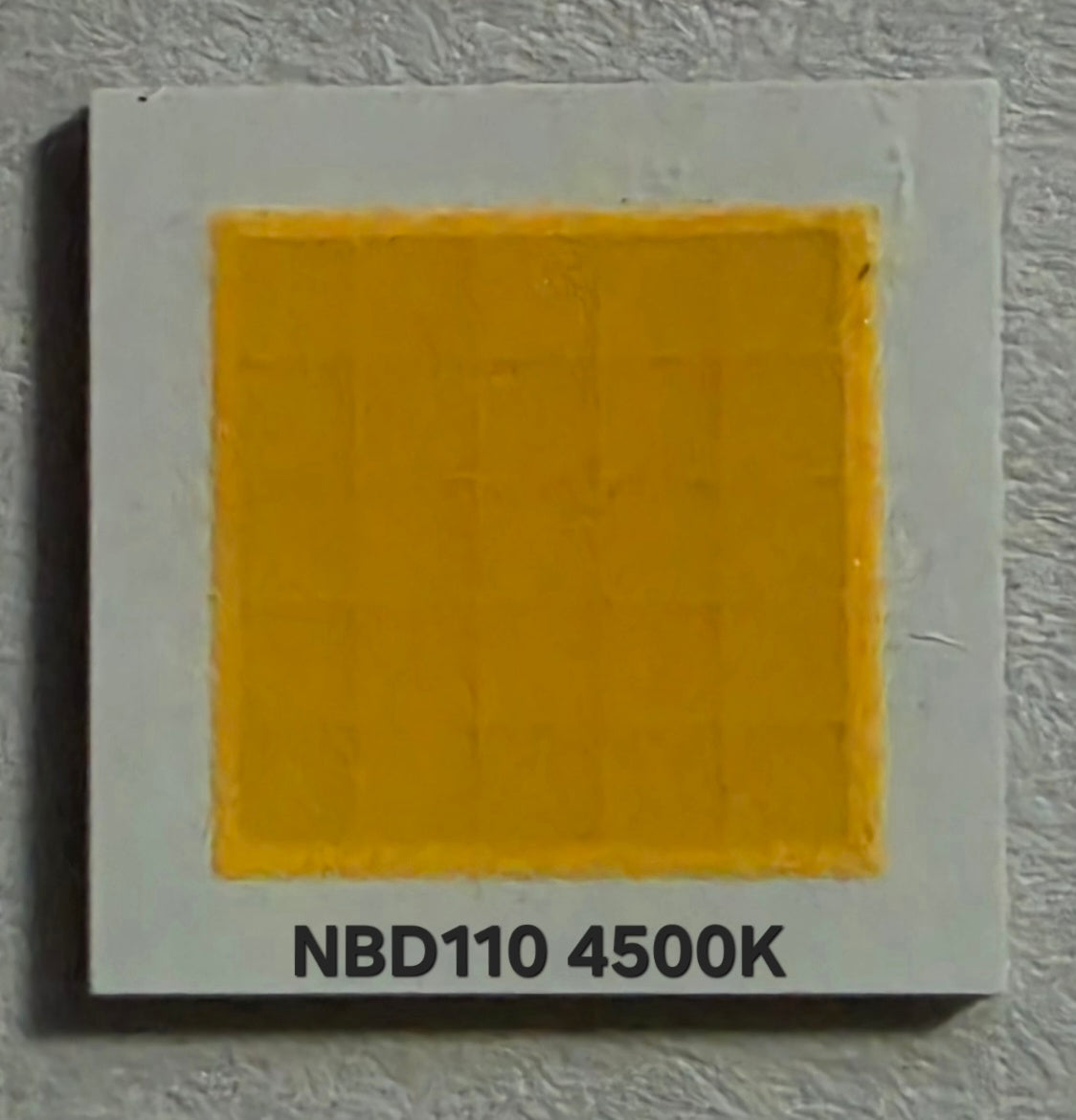

DDH M4B
Daydream 110 4500k
INML 32mm Fet+1
OP Reflector
120/150
Turbo

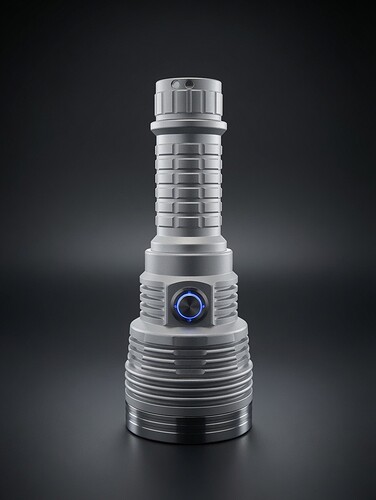

That’s it for now, but I have several more I need to get done.
Glamour shots are all photos I took, but had Grok AI spruce them up.

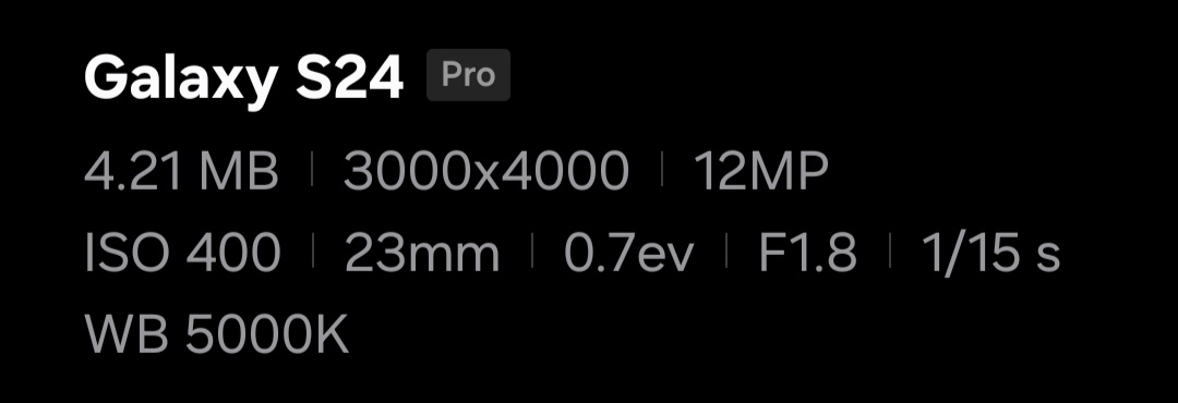

A few more from last night.
Photo settings locked.

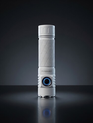

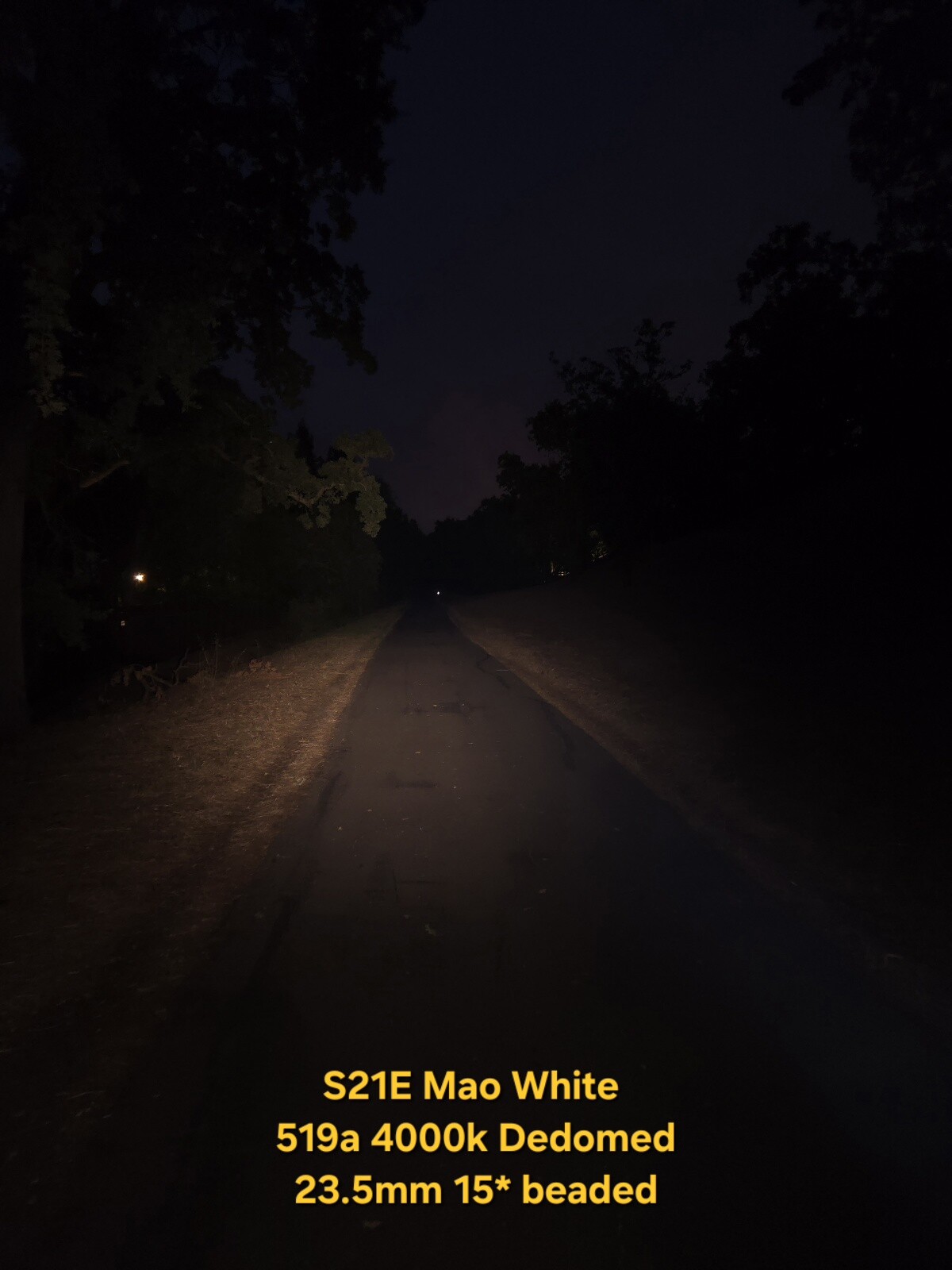

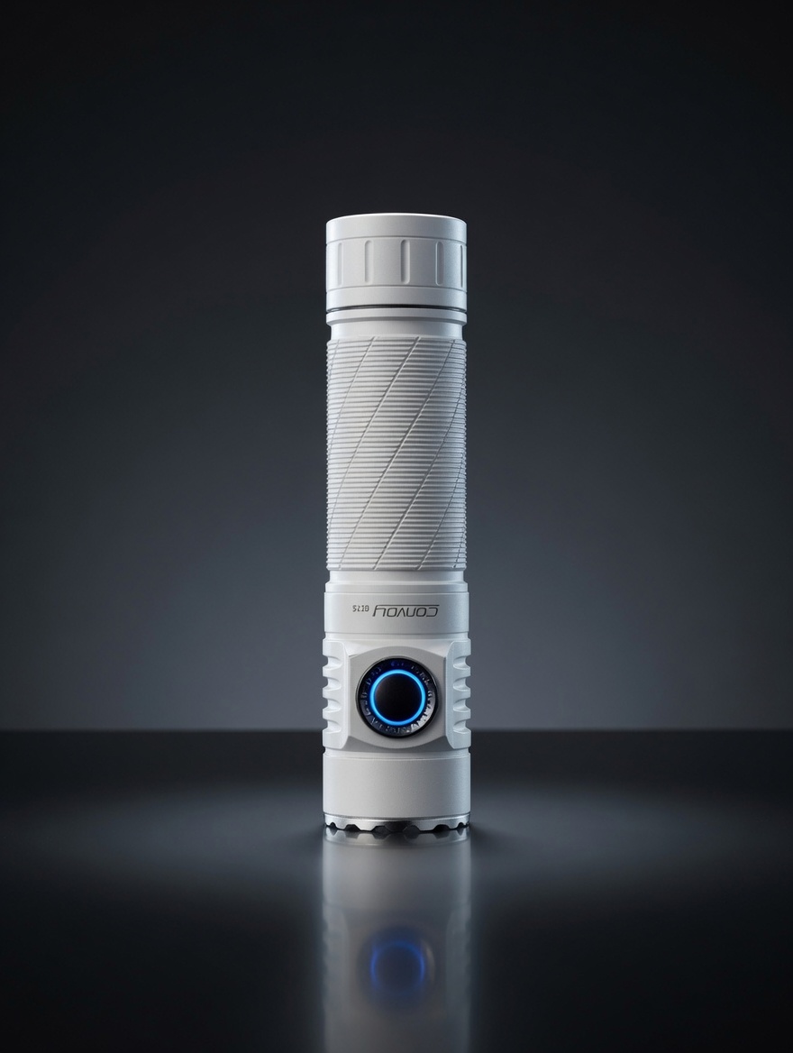

S21E Mao White
519a 4000k Dedomed
23.5mm 15* beaded
Anduril 1 Factory Driver
Next.

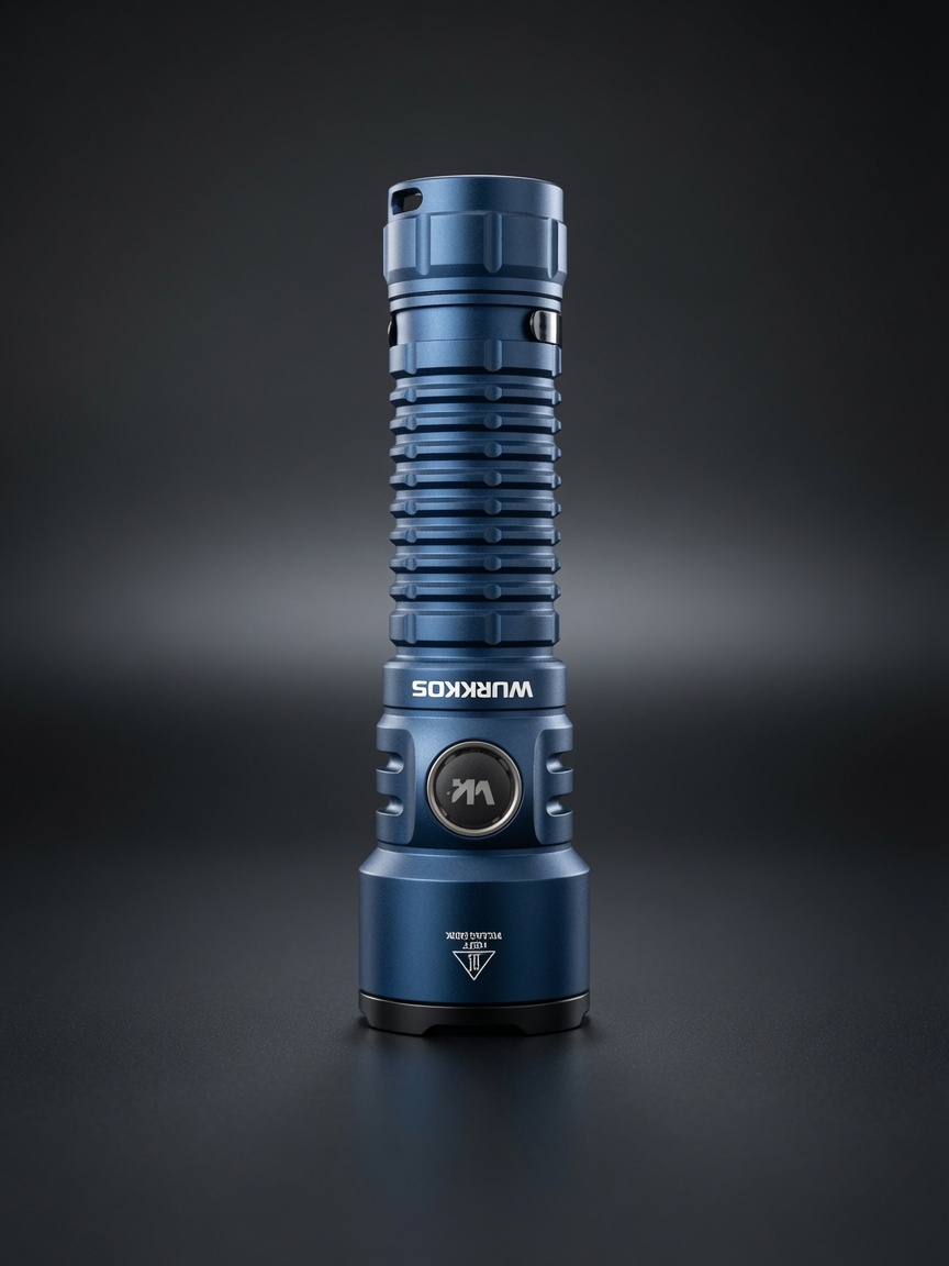

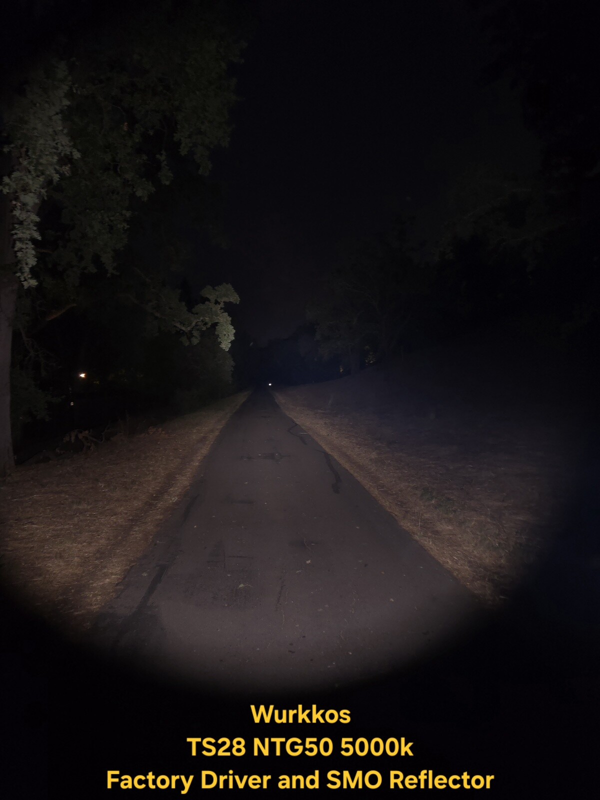

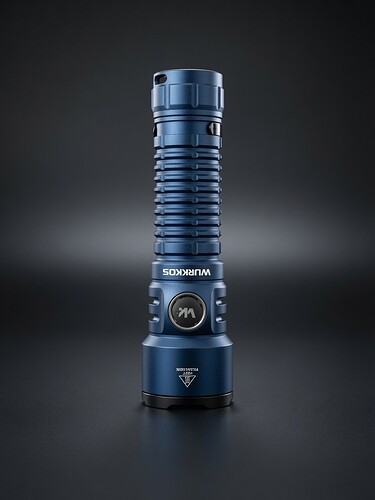

Wurkkos
TS28 NTG50 5000k
Factory Driver and SMO Reflector
Medium
Turbo

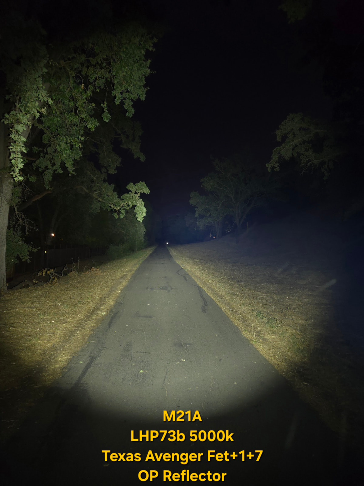

M21A
LHP73b 5000k
Texas Avenger Fet+1+7
OP Reflector
Turbo
Next.

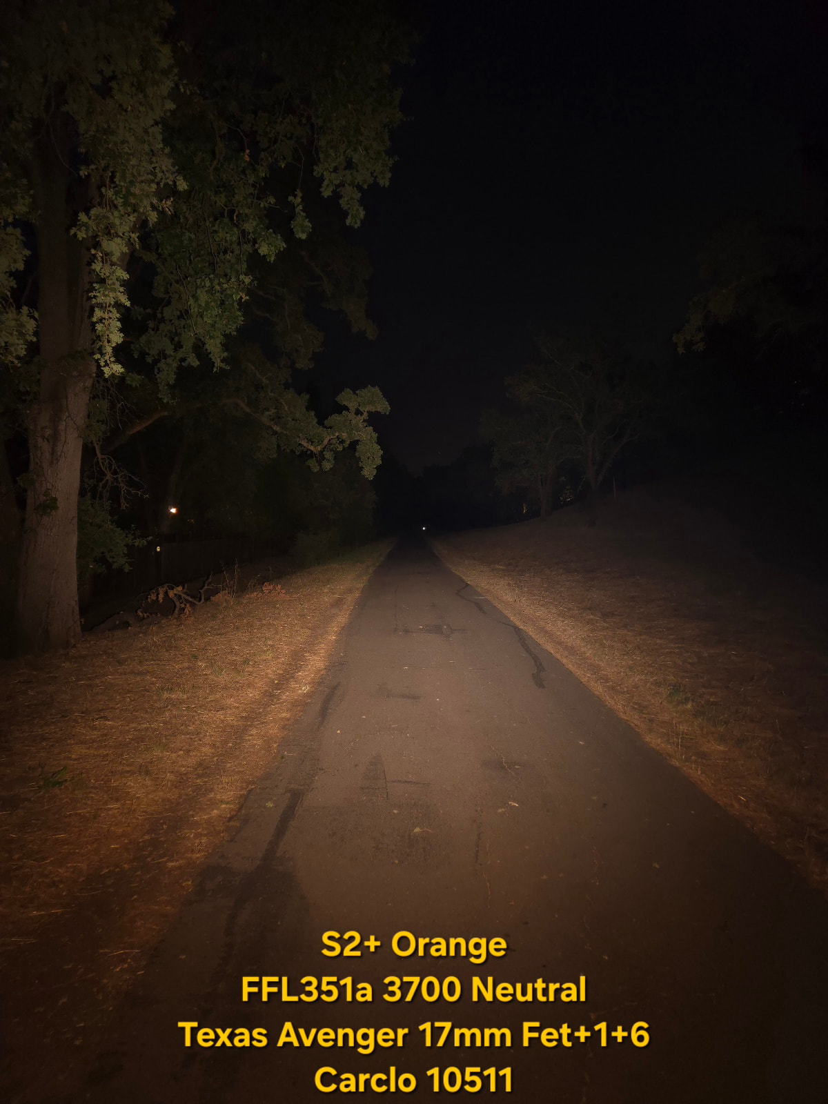

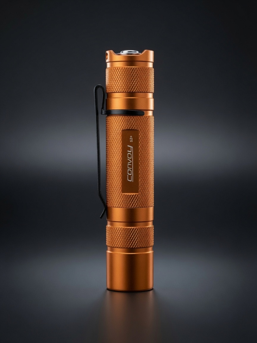

S2+ Orange Triple
FFL351a 3700 Neutral
Texas Avenger 17mm Fet+1+6
Carclo 10511
Turbo

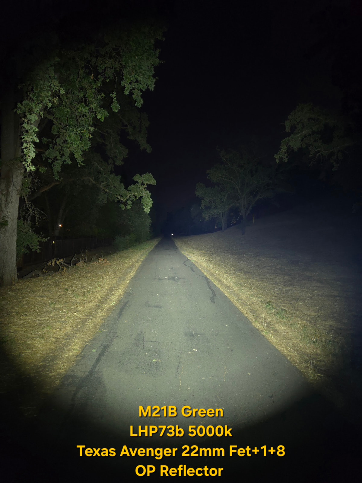

M21B Green
LHP73b 5000k
Texas Avenger 22mm Fet+1+8
OP Reflector

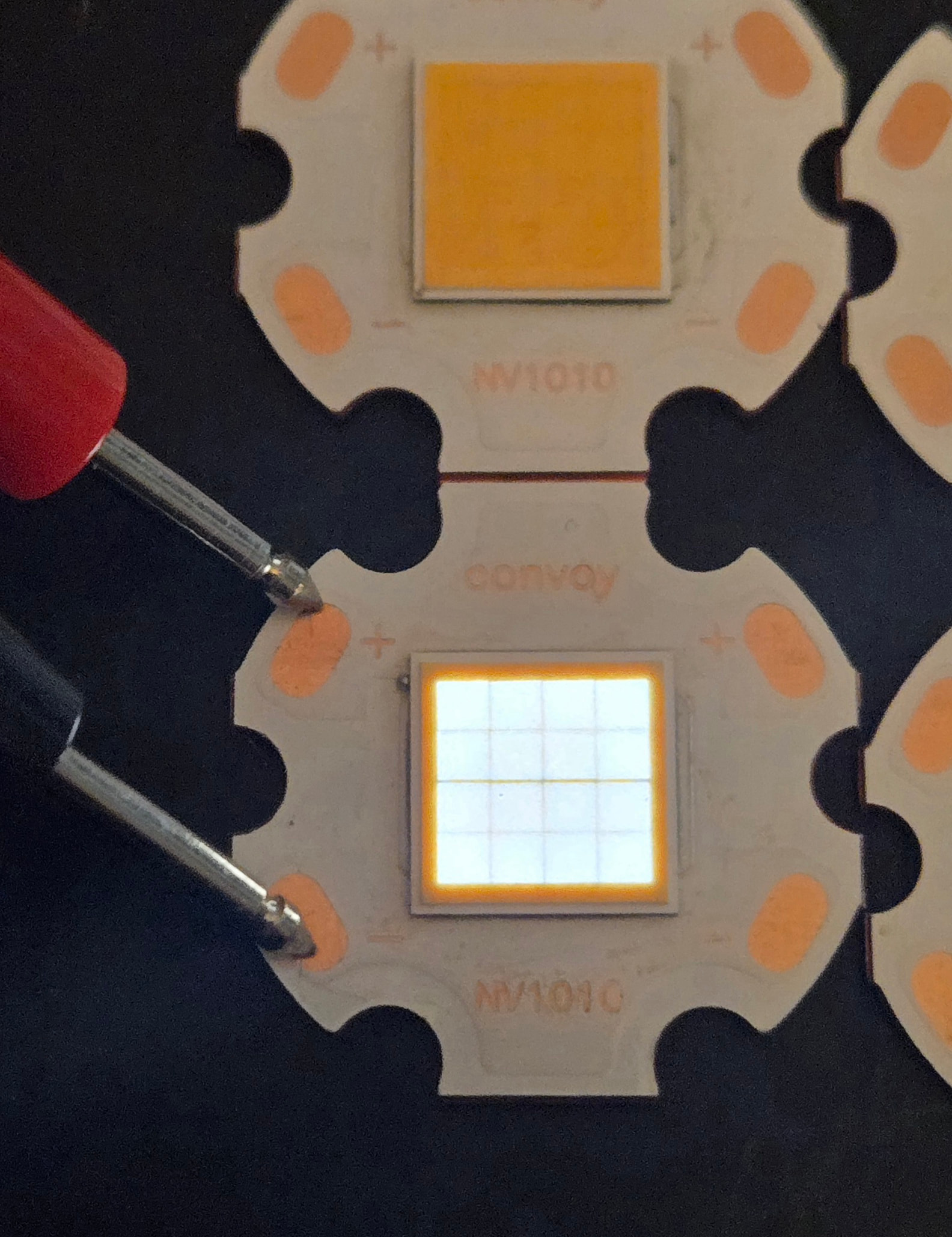

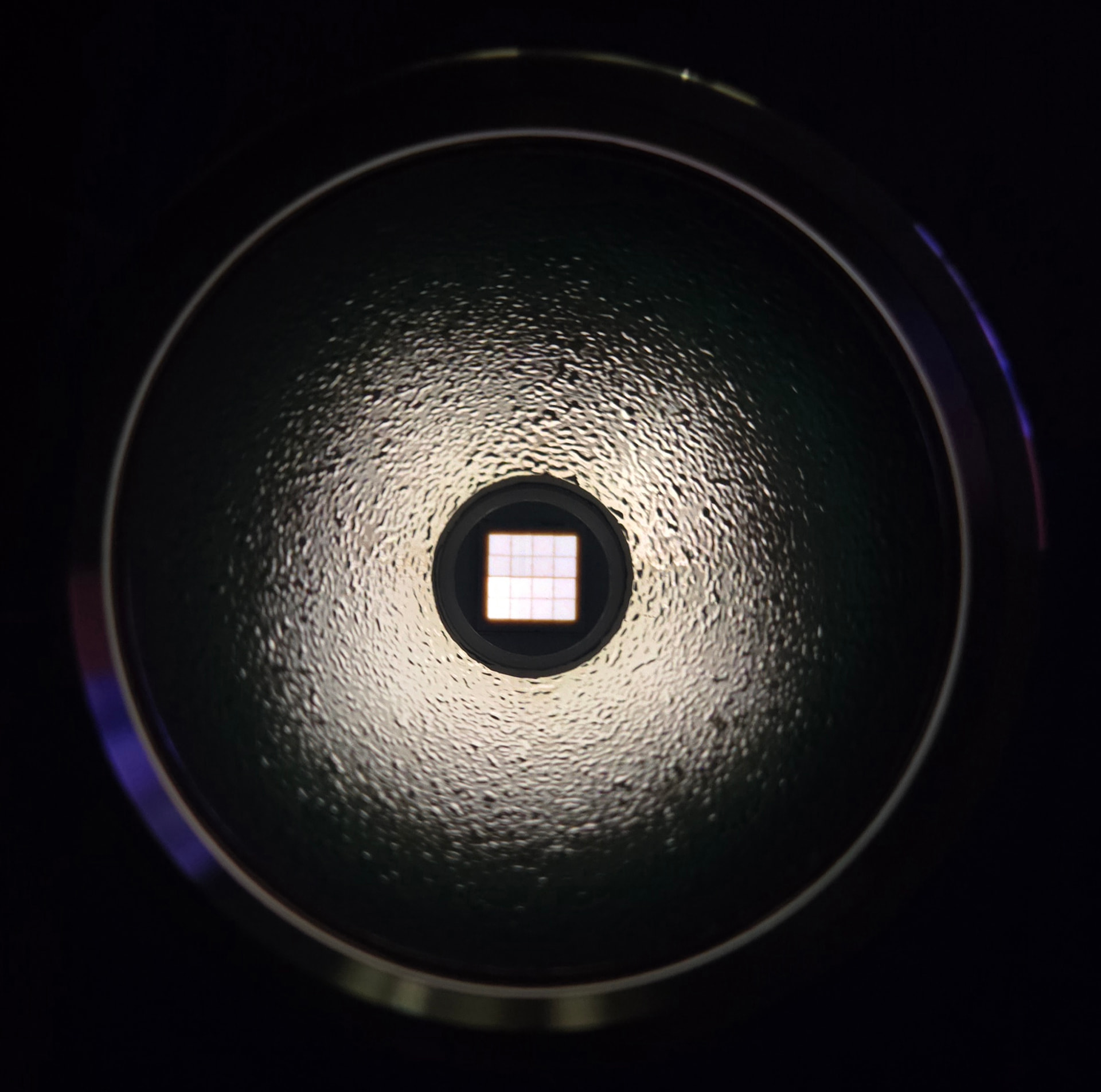

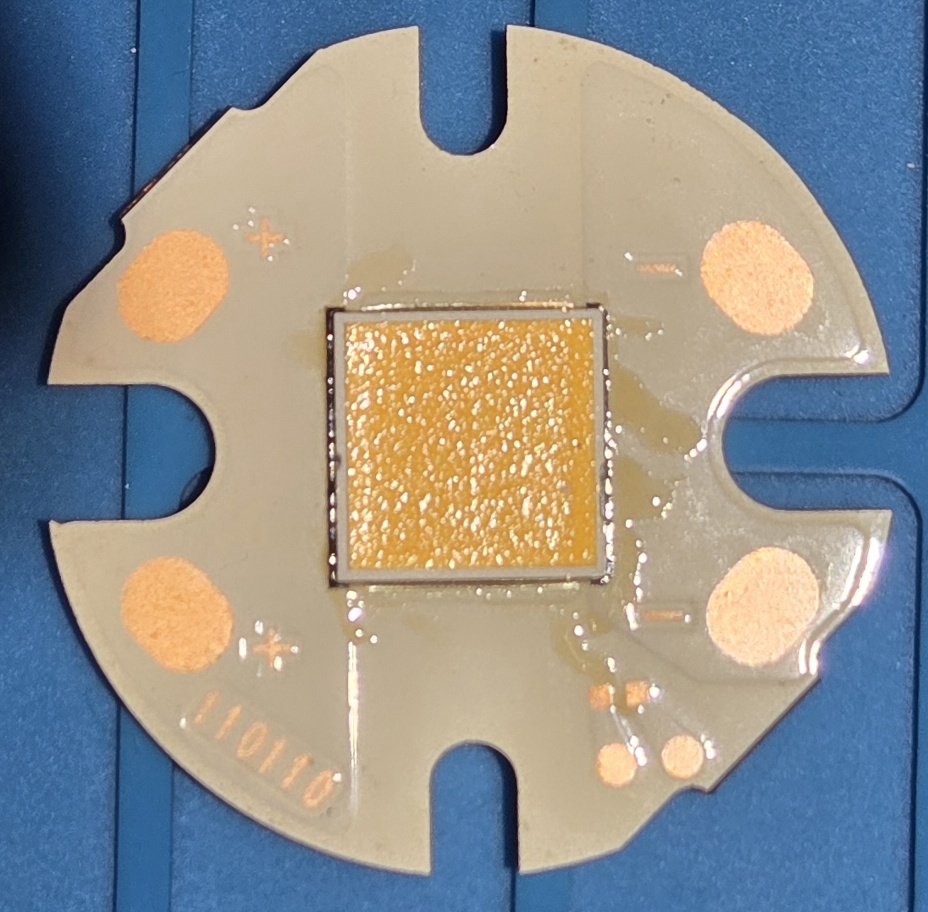

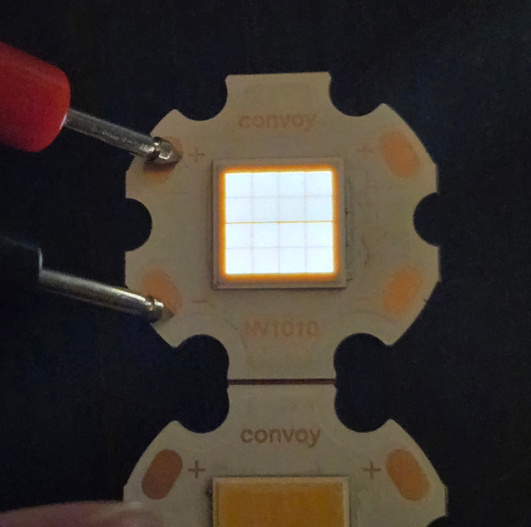

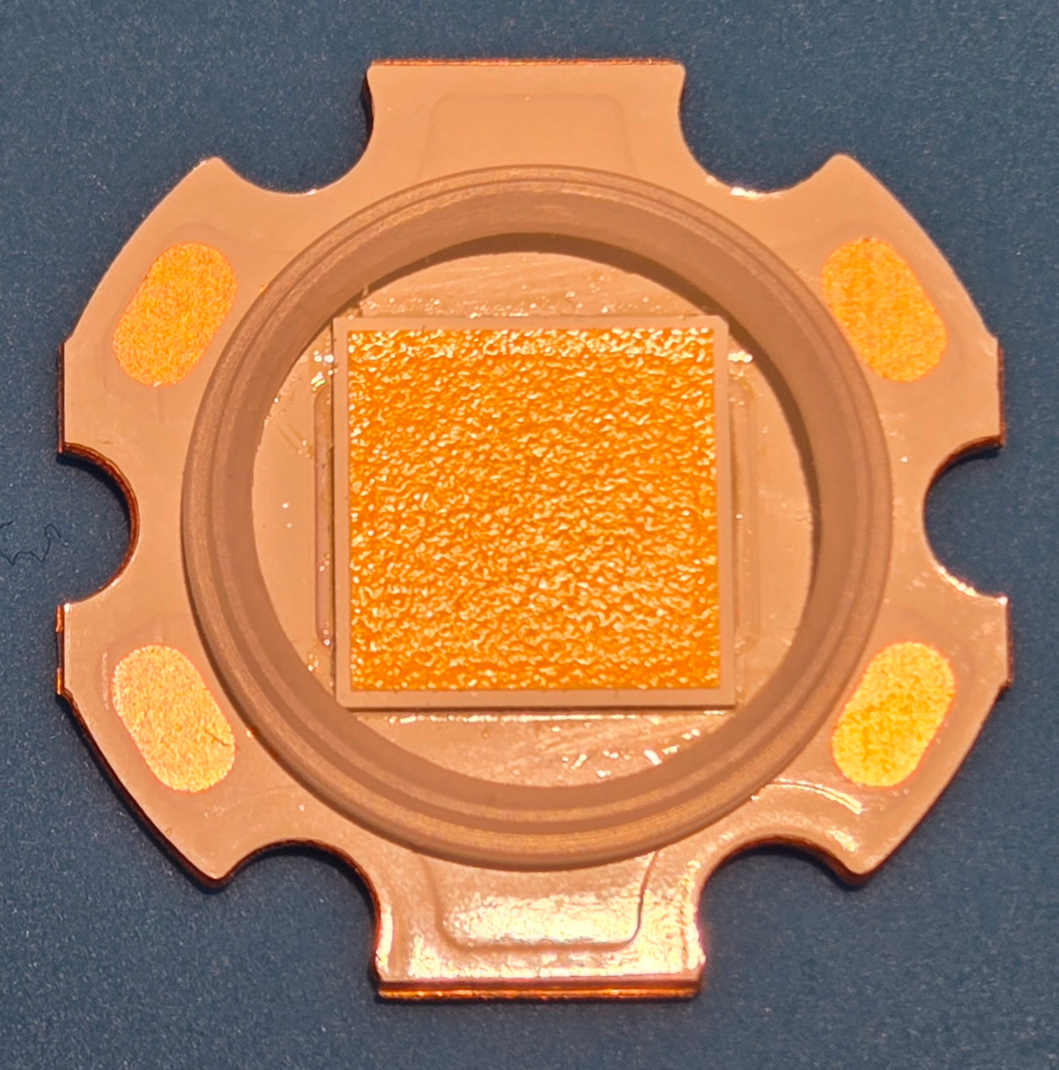

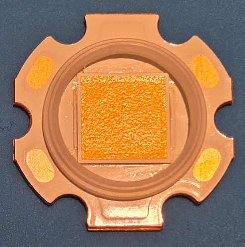

Standby for beamshots of the NV1010 4000k 9080.
16.5mm x 7070 gasket modified to fit DDH M4C host.

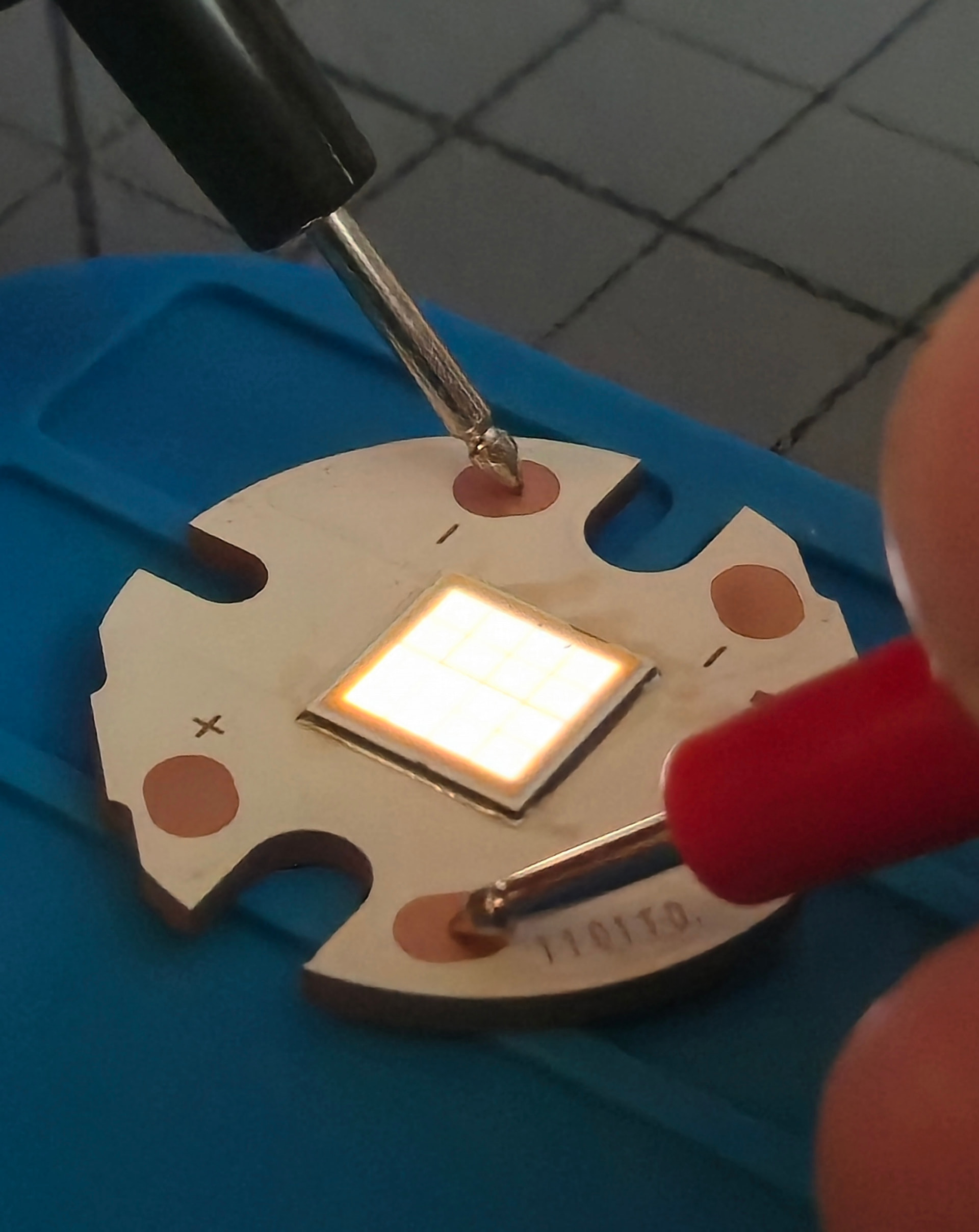

I plan on reflowing the nv1010 to a 32mm mcpcb.
ETA: I was able to successfully reflow the NV1010 to a 32mm 110110 mcpcb.
ETA again: Installed into DDH M4C.

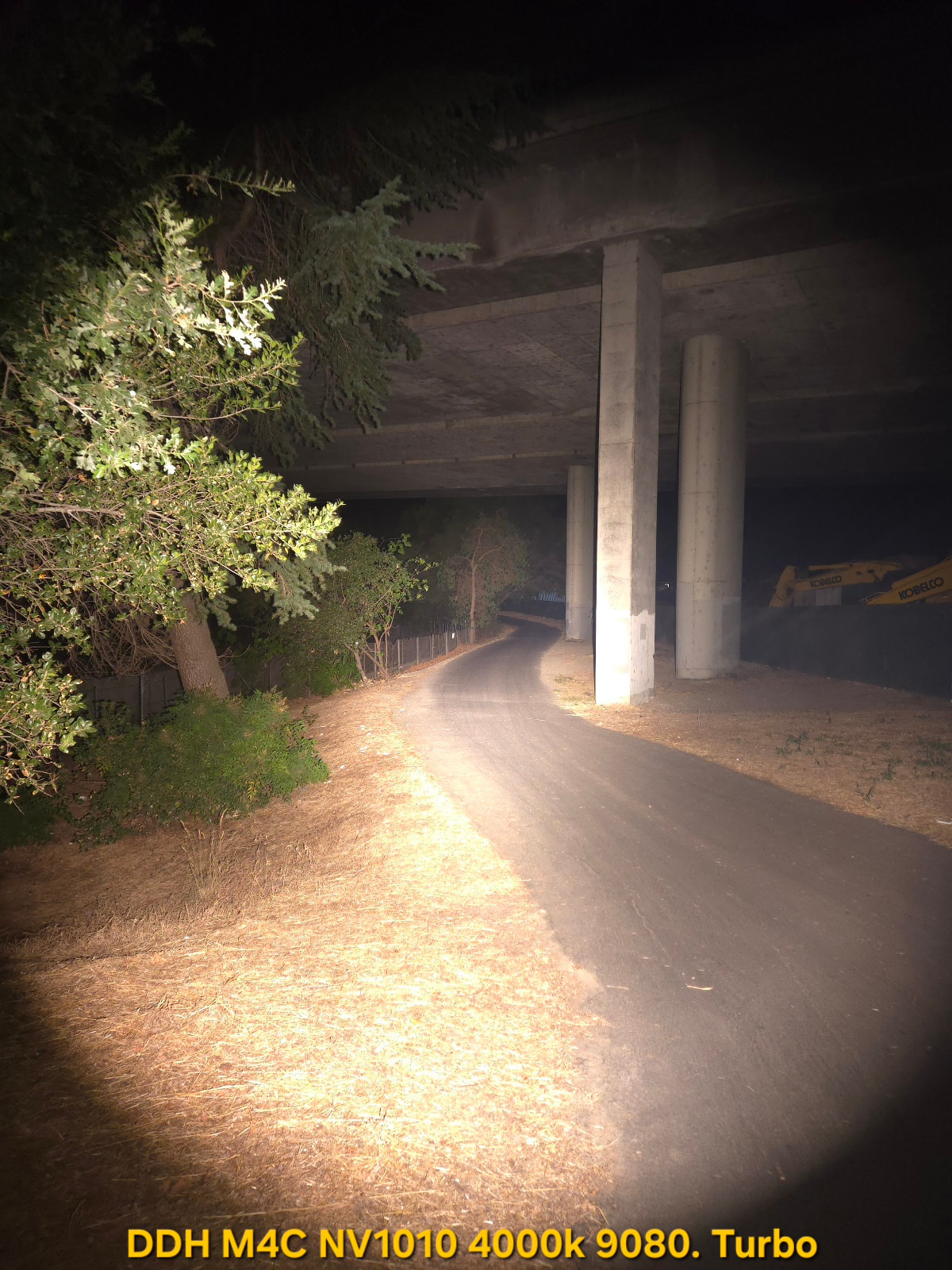

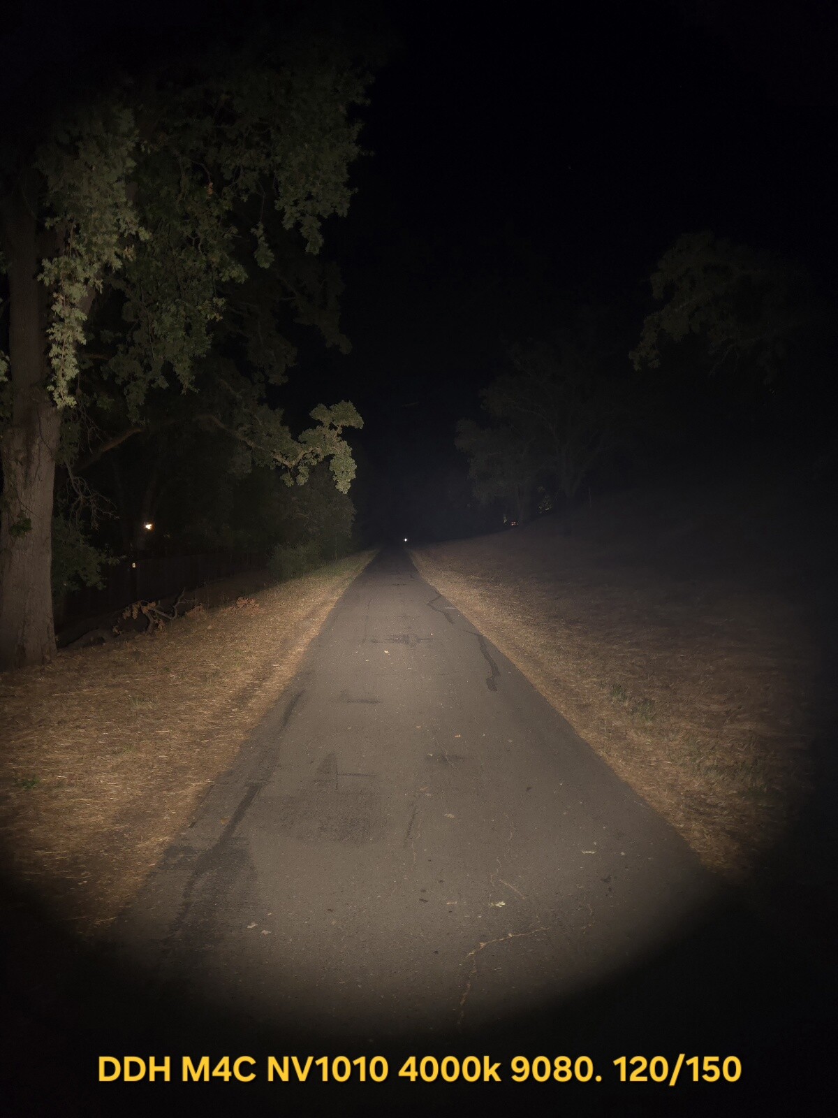

As promised, beamshots of Convoy NV1010 4000k 9080 in DDH M4C.
Air quality was terrible. There are wildfires in Canada, Colorado and more local to me.
There was also mist in the air.
Which location do you guys think is better?
Wide open, or under the overpass?

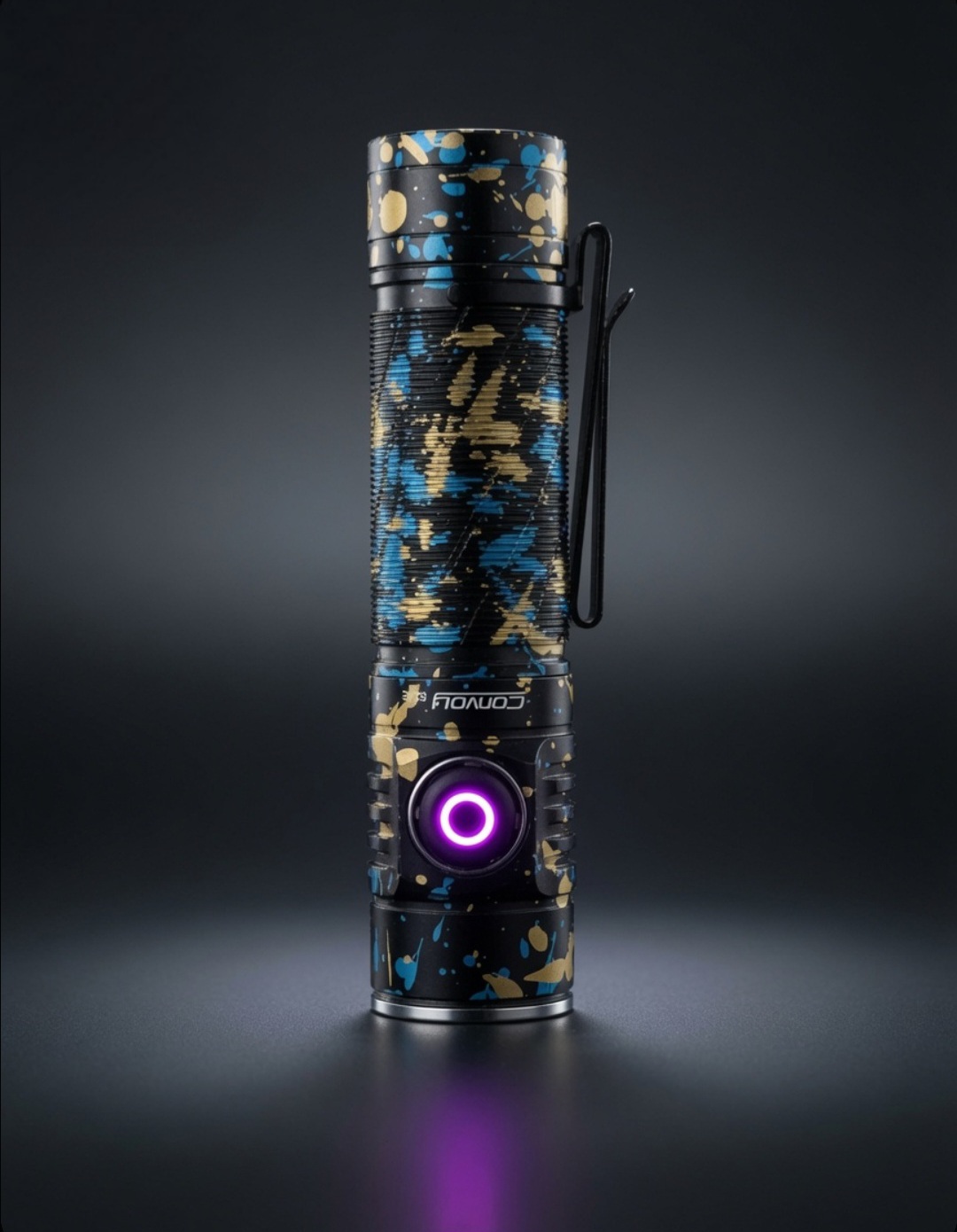

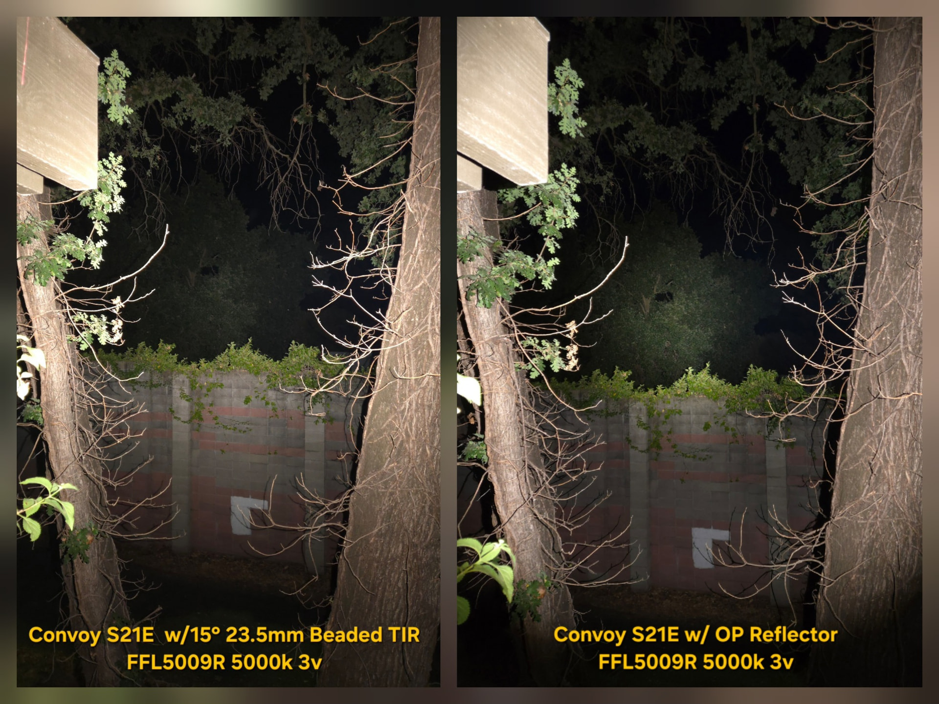

Convoy S21E
INML 20mm Fet+1
FFL5009R 5000k 3v
Convoy 23.3mm 15° Beaded TIR vs OP Reflector.

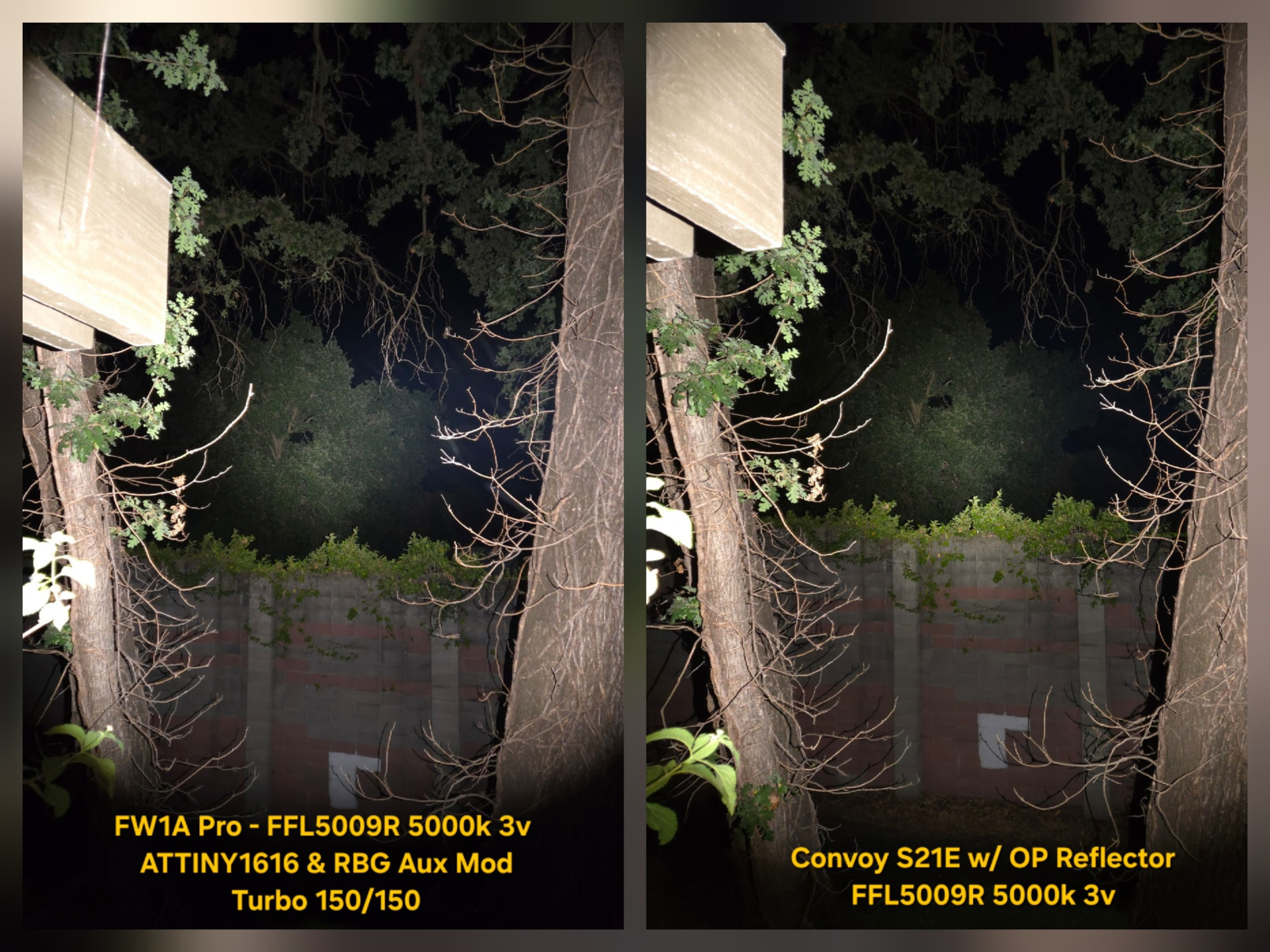

FFL5009R 5000k 3v compared between 2 different hosts.
FW1A Pro left, S21E right.
FW1A Pro appears less warm, I’m assuming because higher intensity due to larger/deeper reflector.
Very nice photography!
I don’t think I’ve heard of half these hosts or even some of the emitters. This could be very useful for reference.
If you have a 6V 5000K FL5009R, does the tint differ between them? I’ve noticed my 3V samples are right on the edge of being a bit green, but it does look a bit lower DUV behind the DM11 narrow TIR than my FW1A pro (with green arc glass).
Don’t have 5000K in NTG50 to compare, only 4200K in 3535, 5050, and 7070 (FFL). The NTG35 5000K seems pretty close to my 219B 4500K D200 (bin iirc), they seem quite a bit warmer than 5000K. Nothing like the FL351A 5000K I got about two years ago.
Unfortunately I don’t have one in 6v.
No NTG50 in 5000k either.
I do have a few NTG50 in 4200k though. Those are great
