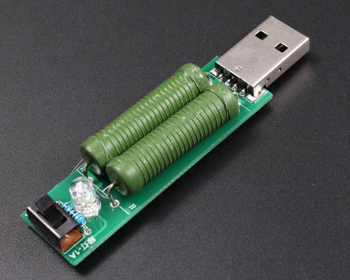

I wonder if those 2A USB ceramic resistor jobbies would work, hook it up to a 2.1A capable mutiple cell 18650 portable power unit, turn it on, people say those things get really hot…if the resistors were encased in something to hold the heat (more thermal mass) well there ya go…

I have also one of the usbloads, it has a switch to adjust 1A or 2A load and it gets really hot…
