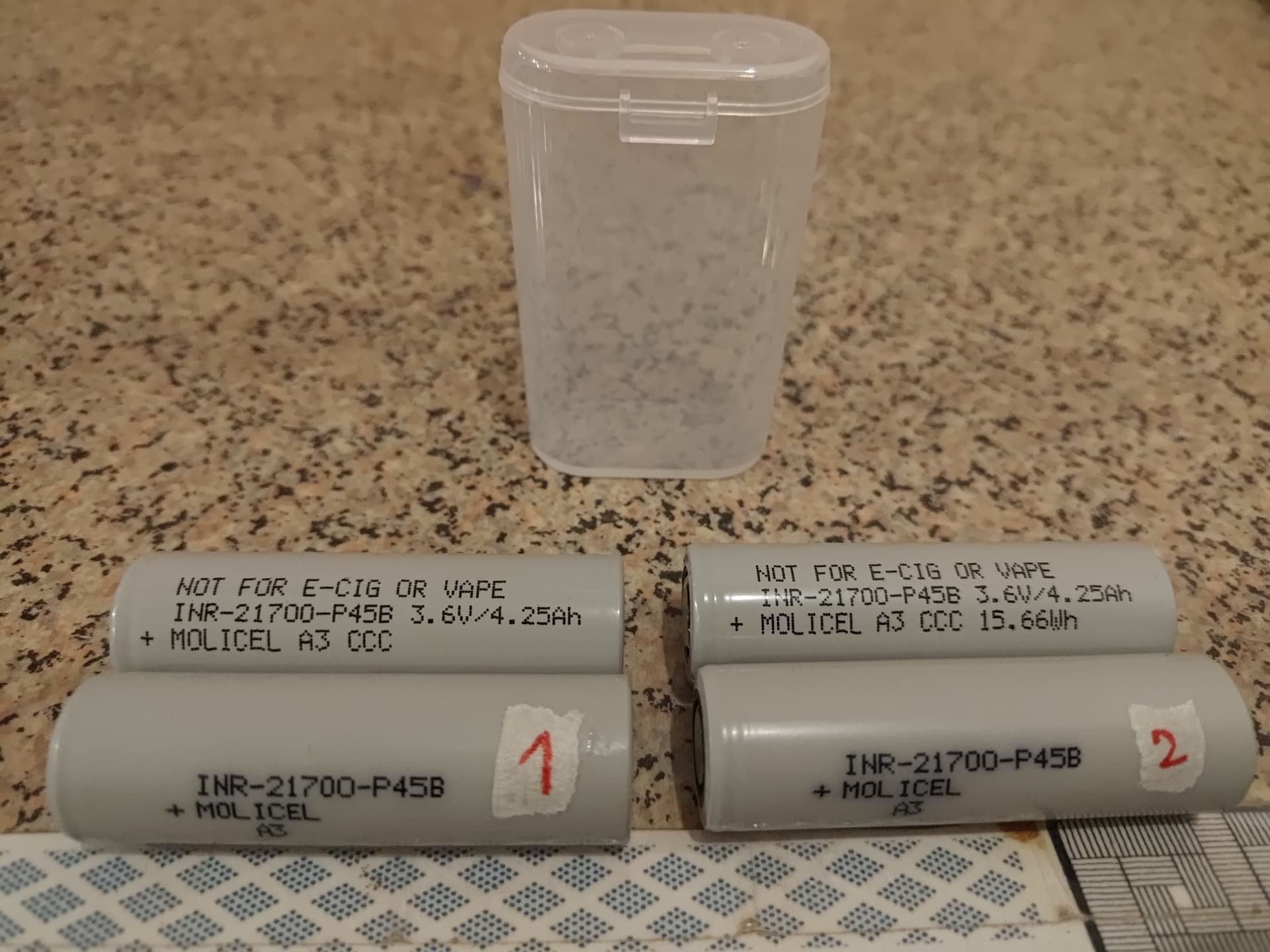

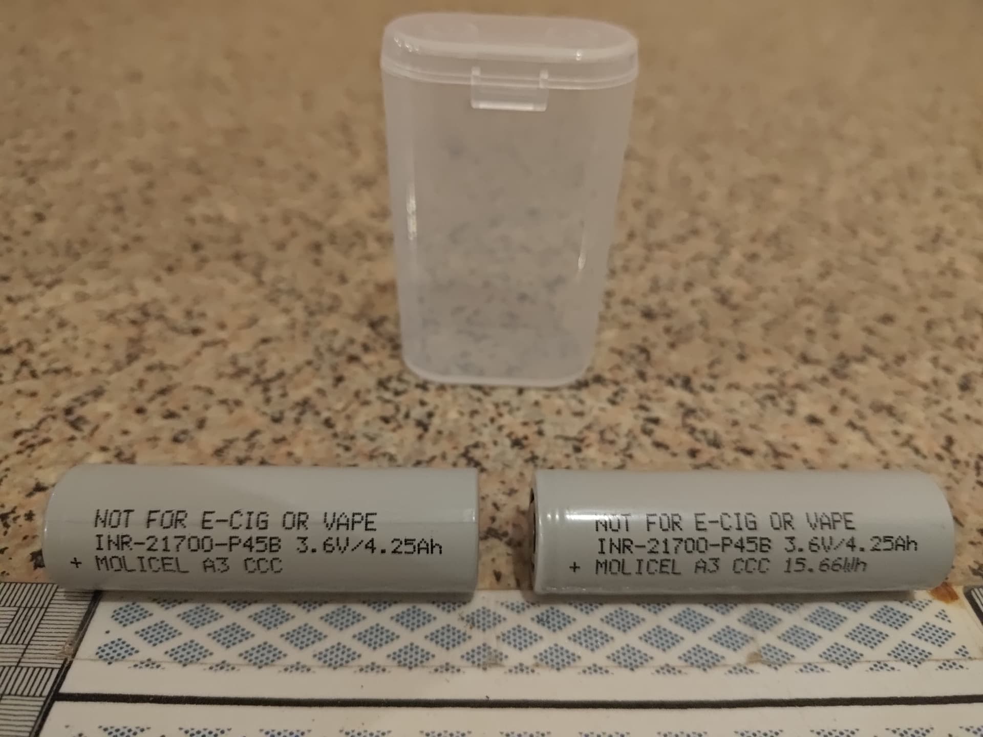

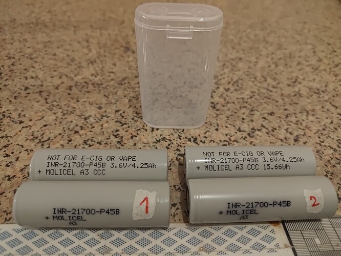

Recently, I got these new P45B “A3” variant for upcoming new flashlight. I couldn’t get the normal P45B “A0” locally for a long time so I got these instead.
These cells are slightly cheaper than the A0 variant.
From what I checked online, they have slightly lower capacity and slightly higher internal resistance.
I have the older A3 one back in April 2024 and compare to the new one. It’s quite different.
While these A3 variant has been out for quite sometimes, this label is updated recently on new batch and surprisingly what I got are a bit different . The one with “15.66wh” is probably newer.
I think this new label will apply to other cells in the future batch

Most cells we buy will soon have labels similar to this. It’s part of the requirements for cells that have passed the China Compulsory Certification (CCC) testing (a very good thing for the companies who don’t fake the results).
The min capacity, Wh, “CCC”, and polarity needs to be marked on the cell at a minimum IIRC with other things okay to mark on the box.

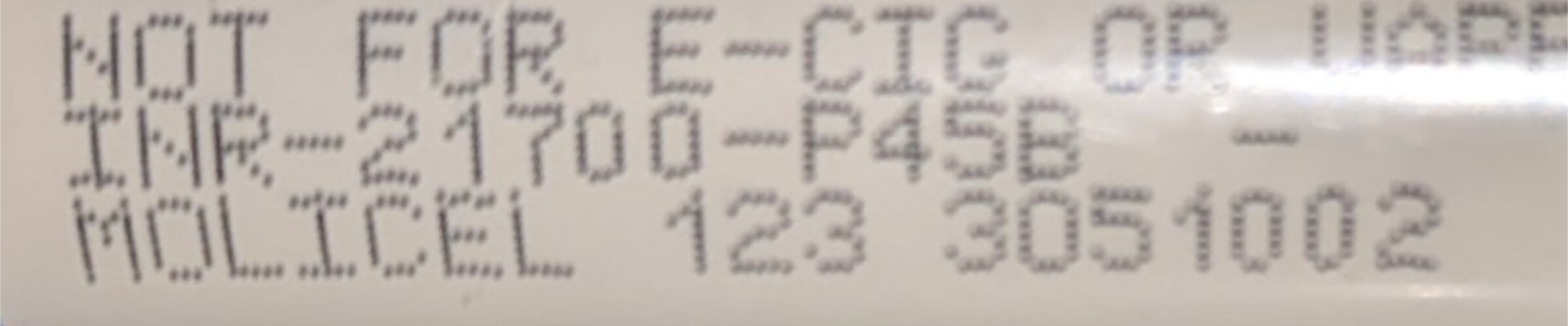

PS: here’s the the written part of the label on one of them:
No “CCC” as in @mickey10632’s – so perhaps they’re old or ‘non-certified’ cells? Also, does anyone know how to decode the numeric “123 3051002” to eg extract a manufacturing date? TIA again! :+1:
You can find out how to read the manufacturing date on this page: Molicel INR-21700-P45B - Lithium ion Battery Manufacturer and Supplier in China-DNK Power
It looks like it was made May 10, 2024, if I’m not mistaken.

Thanks for the info and the link! Pasting it here in case it helps someone else looking for it (or that page eventually goes away):
Cell Date Code: YMDDSS
Y: indicates calendar year, 9=2009, A=2010, B=2011, C=2012, D=2013,
E=2014, F=2015, G=2016, H=2017, I=2018 etc.
M: indicates calendar month, 1~9, 10=A, 11=B, 12=C
AD: indicates calendar date of a month, 01~31
AS: indicates the sequence number in a day, 01, 02, etc
Agreed, I just followed the instructions above (took me some time to figure the 2nd ‘digit’ on mine is actually the letter “O” and not a zero… :man_facepalming: ) and despite the spacing being different, I decoded it to 2024-05-10, and it being part of “sequence” (production batch?) 02.
So not too old, considering I purchased it last November (ie about 6 months after manufacture), and when I received them, they were all at exactly 3.49V of charge – so probably not long enough nor deep enough under 50% SOC to be damaged, right? right? :slight_smile:
It took me a bit to figure it out too because you have to disregard the first four numbers.
