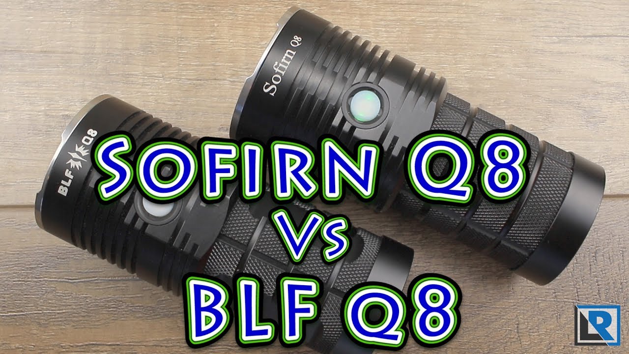

Just before reading your answer, i had read the one from: Polarweis just above,that i also thank, and i had an idea that i had already had several weeks ago! :slight_smile: : watch youtube videos! So i typed: blf q8 vs sofirn q8 :slight_smile:
and there are several videos!

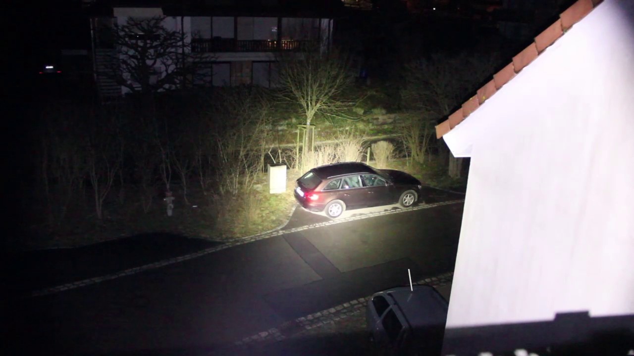

I saw this one:
but i’m not sure that sofirn in the video is first? Can someone confirm me?
if sofirn is first, she totally convinced me packed! :slight_smile: we see immediately what lights further and has more lumens, the lighting is stronger and in + the light is whiter more beautiful thanks to leds XPL HI! it is better than blf q8, it is not for nothing if it is a little more expensive;)

i did not find it terrible it illuminates much less wide than sofirn Q8. on the other hand it has more candela and throw further and that’s all. So my choice i think will sofirn q8 :slight_smile:
In the Video, Sofirn in first.
