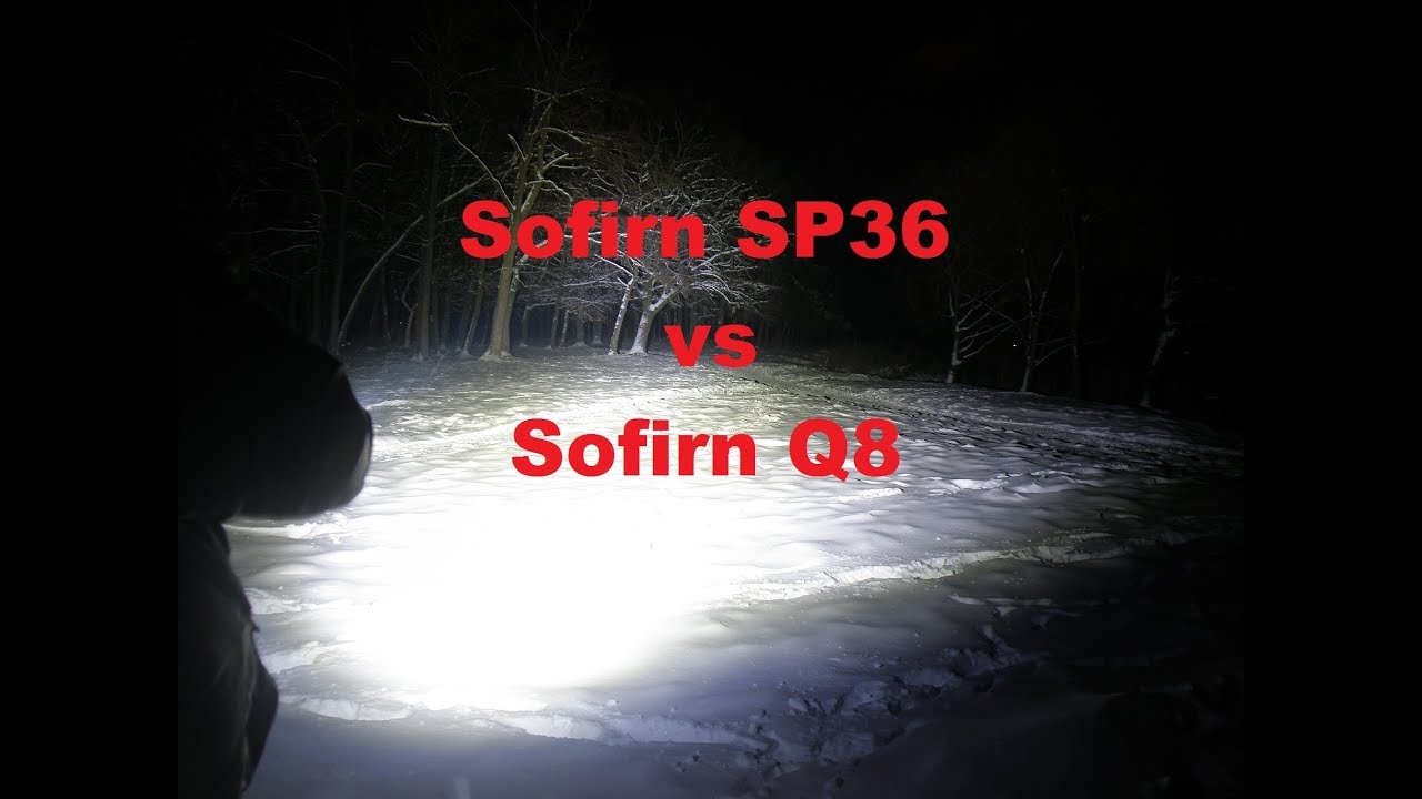

luckily just now i found this great video and at 26:10 : Sofirn SP36 vs Sofirn Q8!
I was convinced that the sofirn sp36 would be much more powerful than sofirn Q8 because it is announced at 6000 lumens and has a driver narsiLM v1.2 while sofirn Q8 only has the driver narsiLM v1.0 and as you just explained to me Johm, that a better driver increases production costs, i told myself that the sofirn sp36 will brighten further and wider
-But in the video at 26:10 to my astonishment: Sofirn Q8 lights up further we see the portal better than sofirn sp36!
on the other hand the beam of the sp36 is wider than that of the Q8, but i prefer a thousand times the Q8 the portal in the video is much clearer and detailed! :slight_smile:

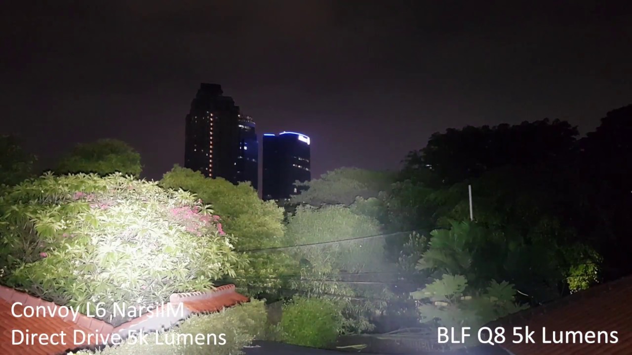

I think i’m going to run and buy the Q8 i like it a lot but another video that i had already seen 1 month ago now makes me hesitate: The convoy L6!
in this video there is the BLF Q8 vs convoy L6. Even if i found that the sofirn Q8 illuminates a little better than the BLF Q8, i can pretend that in this video it was sofirn.
well we see in the video that the light of the convoy L6 is a little more powerful! But in the description of his video he says:
“Please note The Convoy L6 is modded with Direct Drive TA Driver from BLF it draws 10.5A at start and producing 5000 Lumens.So this is not your typical Convoy L6.”
so i need your help, should i buy the convoy L6 and moded the driver like him?
or is it possible to install a better driver on the Sofirn Q8 for that it becomes as powerful as the convoy L6 moded of this video?

What you’re seeing here is candela versus lumens, which I explained before. Here’s a more extreme example:
In this case, the target in the middle is so brightly lit as to be overexposed in the image on the right, despite the light on the left having 16 times as many lumens.

The L6 is not a bad choice, it is not as new or fancy as the Q8 but is bigger and can handle the heat better (remember, big is your friend) so will give you more light over long periods of time.
The stock driver is good, you don’t need to upgrade.
(Unfortunately not on sale anymore)
The other lights discussed here will only give you the maximum advertised output for a few minutes before thermal regulation kicks in.
If you want lots of light for 3 hours you have to go bigger.
I just checked your budget, bigger lights are much more expensive.
So, Q8 vs L6
Q8 pros:
- easier to carry
- 33% more battery life
- better User Interface with more options
  • more light on turn-on.
L6 pros:
- lots of constant light for extended use
  • more throw (I think)
The code AC18 at banggood will bring the price of L6 down.

if i change the driver or even the emitter of the convoy L6, as for example with the person of my video above where he says:
” Please note The Convoy L6 is modded with Direct Drive TA Driver from BLF it draws 10.5A at start and producing 5000 Lumens.So this is not your typical Convoy L6.”
the convoyL6 will pass to 5000 lumens will become a little more powerful towards the end of the video than sofirn Q8 as seen in this video
in this case i buy it, but:
Or is it possible to install the best driver and the best emitter in the sofirn Q8 to illuminate even better than the convoy L6 modded of this video?
